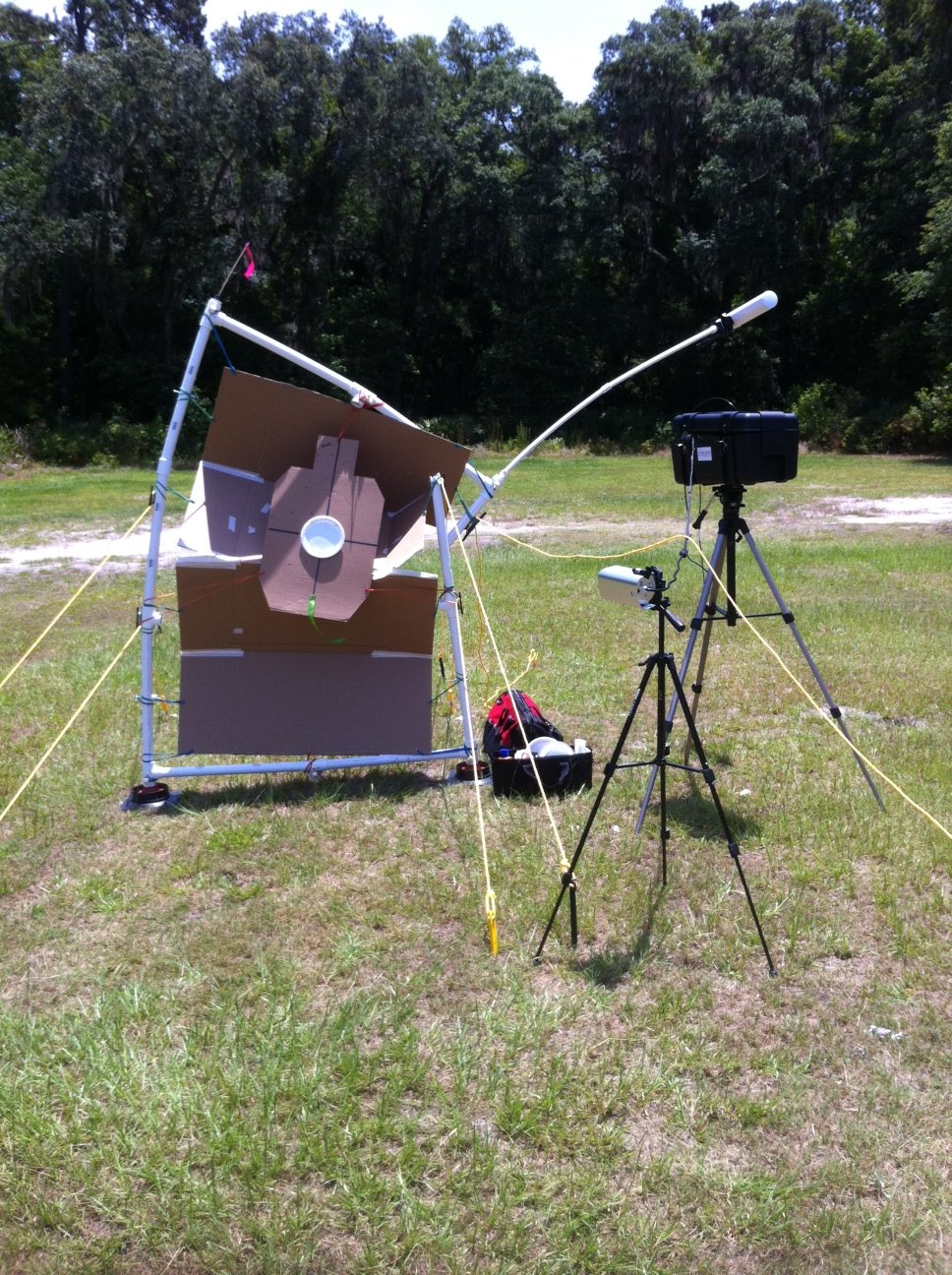

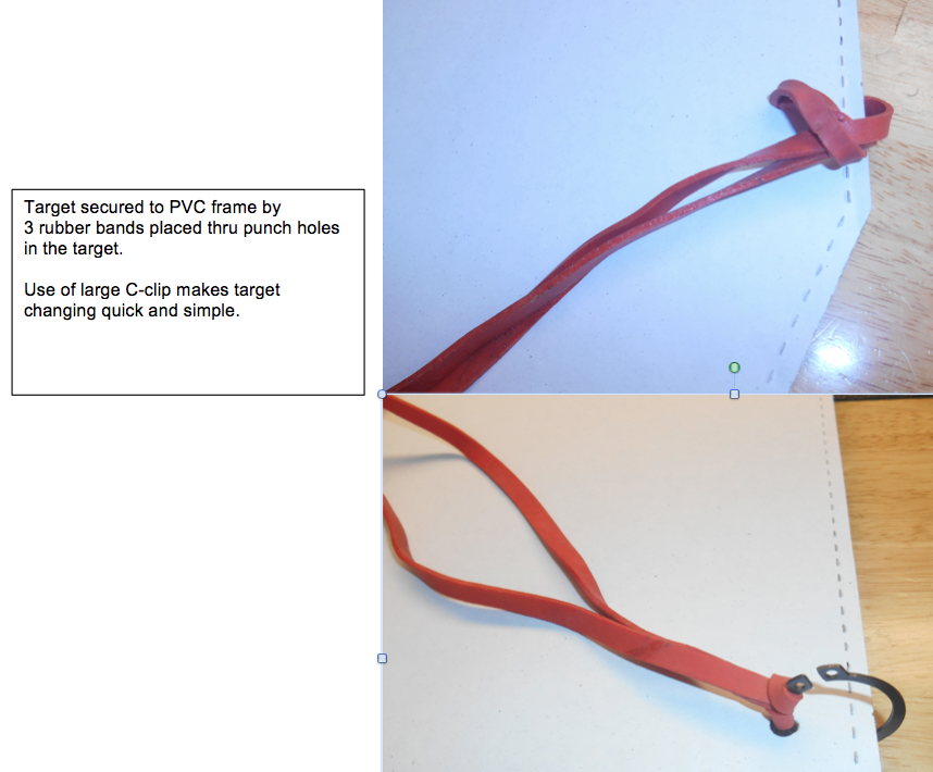

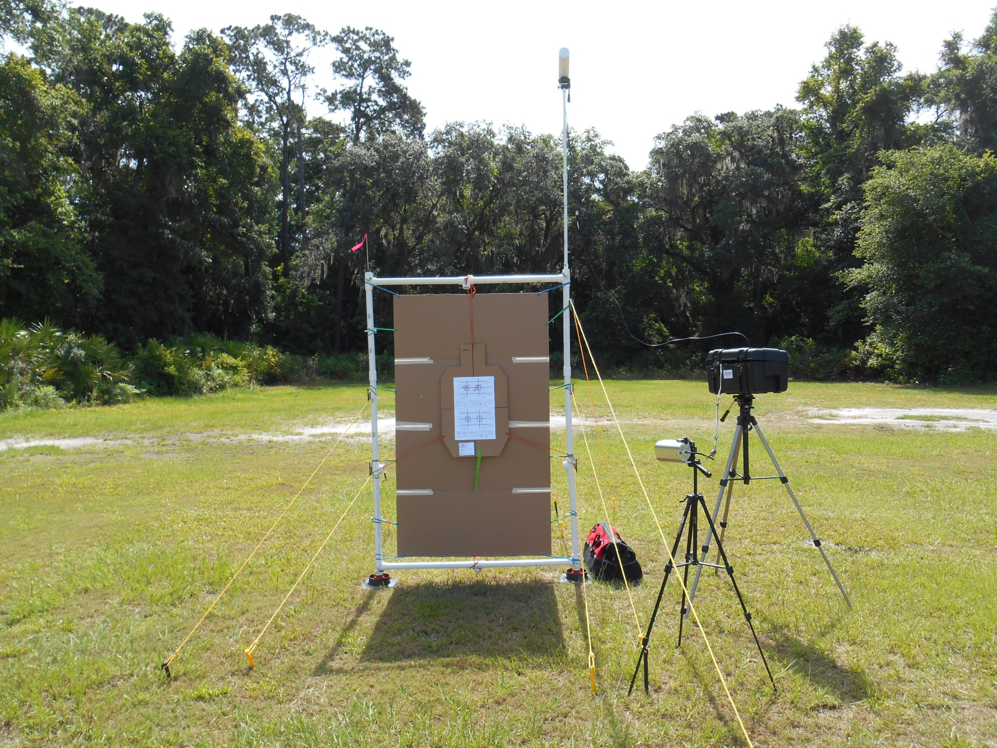

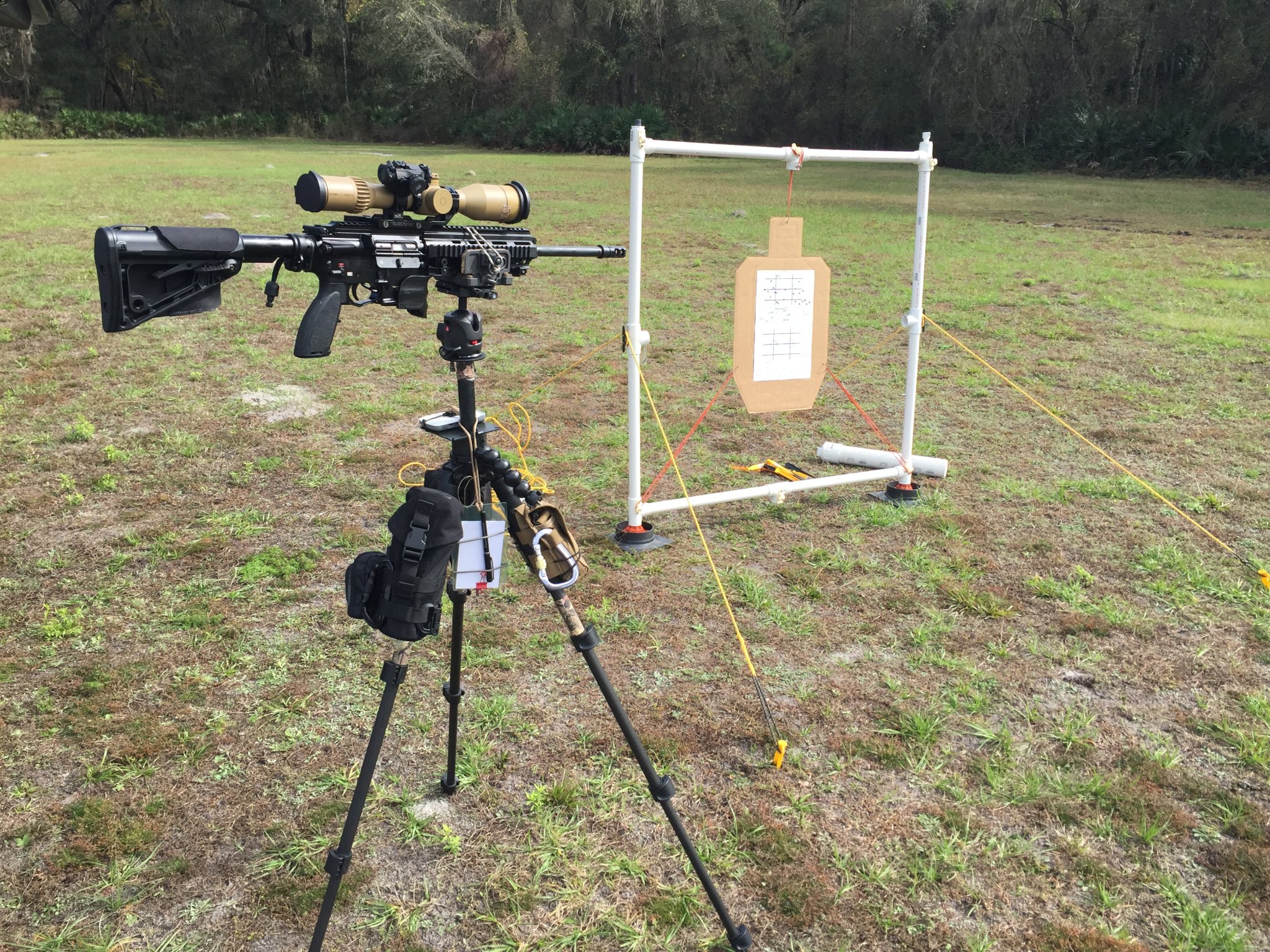

Might also consider this. I can't weld so I resorted to PVC erector set mentality, as they are, obviously light weight, inexpensive and easily replaceable as you will strike the frame when the wind is misjudged . When the wind is not favorable its pretty hard to hear steel ring @ 1000 meters. I use a vertically short system for zero range sight-in. For more than 500 - 1000 meters I like to use a large cardboard backing behind the target to stabilize it and see your "just missed" efforts as you correctly indicated the targets act as sails in the wind. I try to mitigate the motion with rubber band - support of the primary target with C-clip rubber bands. The large cardboard backing is from Home Depot grande shipping containers, cut open to length. The large cardboard backing is also secured with heavy duty rubber bands (Office Depot) with simple hole-puncher to the cardboard. All the parts fold up easy for transport and I keep all the PVC fittings in a Home Depot Tool Bag.
View attachment 6876692View attachment 6876693View attachment 6876695View attachment 6876698
That is pretty elaborate, if I do say so myself! Gives me some ideas.
