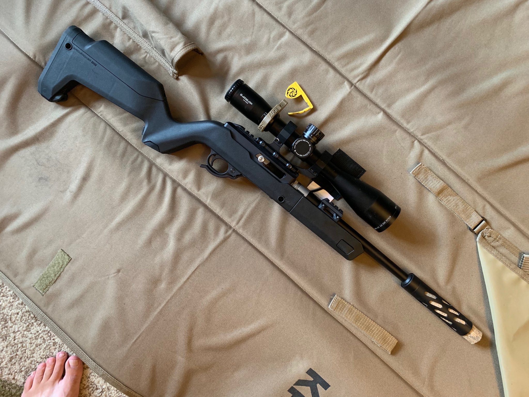

Mine. Extremely accurate. No stamp required. I've ordered a second TB 22 TakeDown so this can have a dedicated can.
Tactical Solutions.
Ignore the toe. :giggle:
There firing pin on my Tikka T1x broke the night before the match. I ended up installing/sighting in this scope on site for a PRS .22 match with targets simulating near 1000 yards. It was me, not the gun, holding me back. My SW MP15-22 in not even close in accuracy. I moved this scope off that rifle to shoot this shot barrel because I believed it would be much more accurate than the MP. Not only was it more accurate, it was surprisingly accurate shooting Lapua Center X.
PS. The rifle is also a take down. Not sure how well zero will hold after taking it down and putting it back together but it shouldn't take much to get it back to zero as I can only imagine a .1 or two off after breaking it down and putting it back together.
Tactical Solutions.

What’s the length on that 10-22? Looks shorter than 16 to my eyes. I’m looking at the cz 457 for a 22 rifle. I have a marlin 60 but that’s not going to work well for a suppressor host. I love the fact that you can do anything to rugars. So much support for them in general.
W/ the muzzle 'cage', it's a legal 16.5". The actual rifled portion of the barrel is about 10.5".
