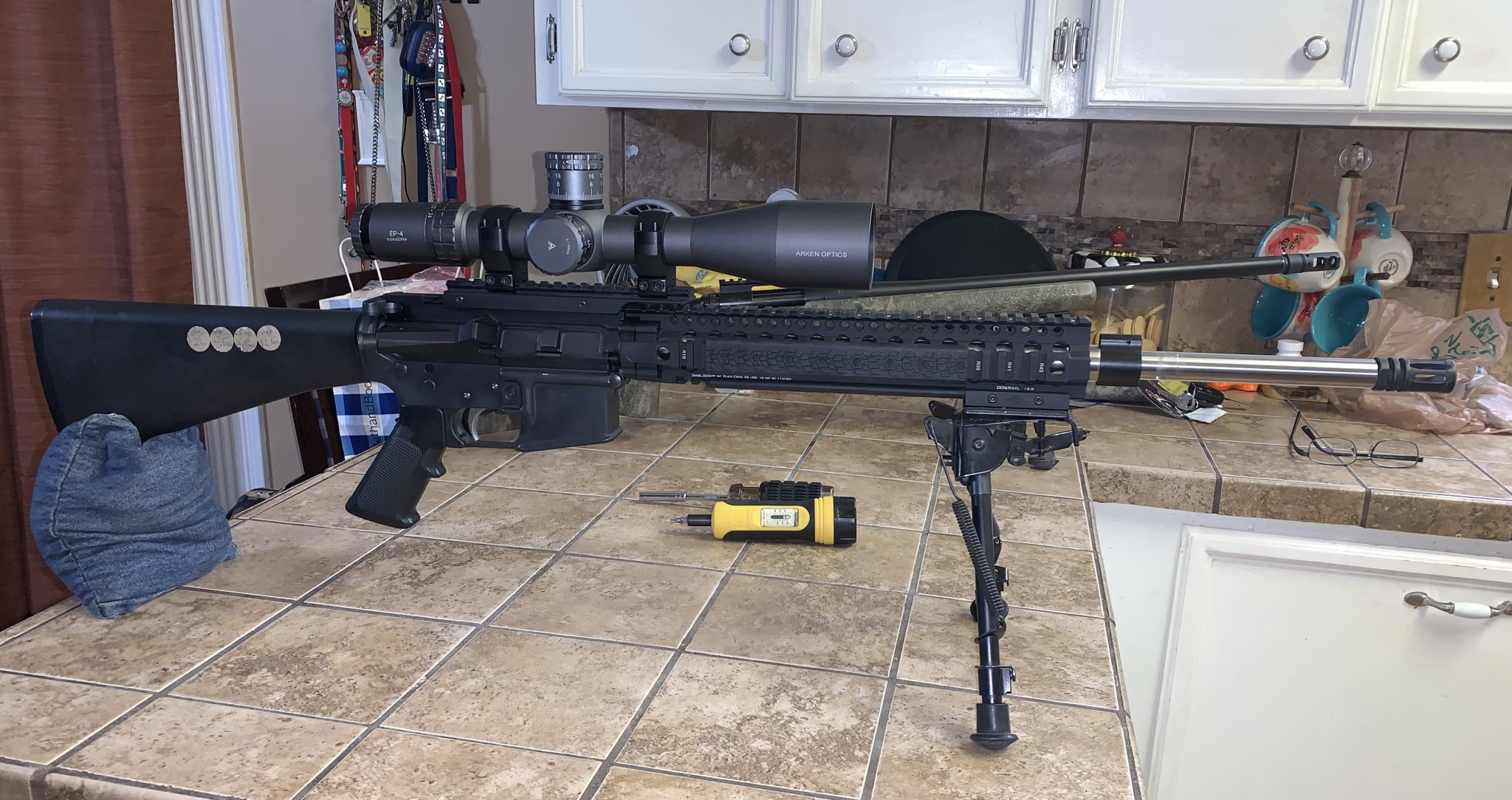

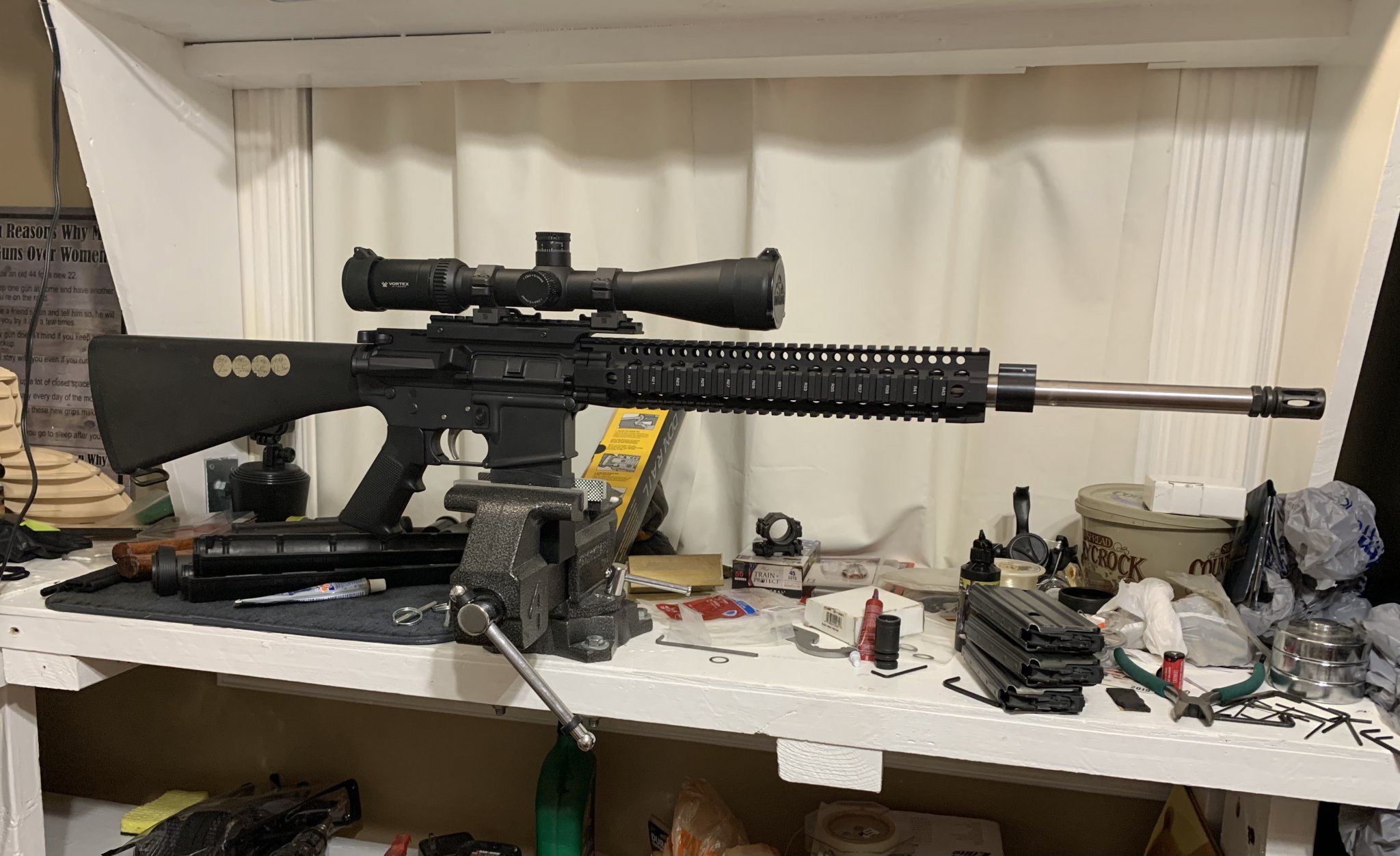

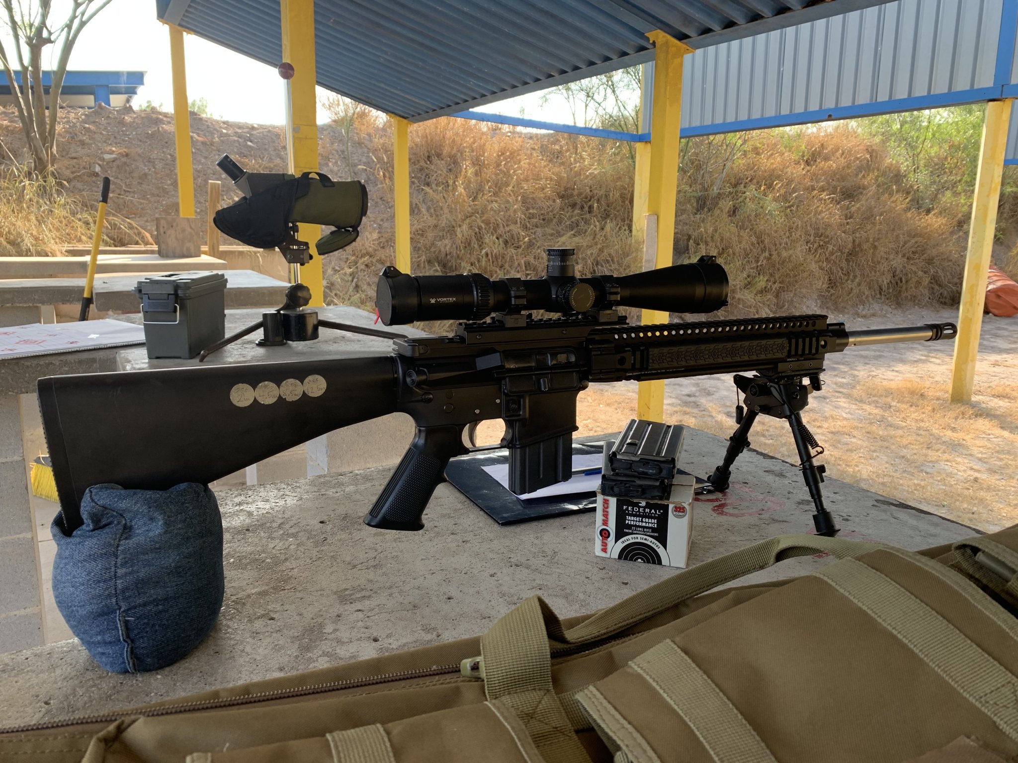

Here’s another one for you, though this one is a dedicated 22LR rifle and not just an upper.
John at Keystone did the barrel & CMMG modification work
Shilen Select Match Ratchet 4 22.5” barrel
Compass Lake forearm
Vortex Viper PST 4x16-50 EBR1 FFP
Timney 4 lb. trigger
Ergo grip
Luth AR buttstock
Harrel tuner
Harris bipod
Area419 arca swiss bipod parts (soon a new Area419 10“ arcalock rail)
Ambi paddle safety
Catch22 bolt hold open
Weight as shown is 11.4 lbs.
Except for barrel length and forearm, well and the Harrel tuner of course, it matches my AR-10 in feel, weight and trigger.
Mine has a pretty tight chamber (52D), so I do need to clean the chamber/bore every 150-200 rounds for it to cycle like a sewing machine. The moment a round fails to fully chamber it’s too late and at the moment that starts to happen with SK LR+ at ~225-250 rounds.
Really it’s just the chamber and leade to the rifling that need cleaning as it gets carbon caked pretty quickly. I’m still tuning mags, buts that’s for my own edification as (I think) the Black Dog metal feed lips could be a bit smoother.
After a thorough cleaning, I shoot 5 rounds or so, then load her up and start shooting for real. Using a bob sled magazine, it’ll one hole with 10+ rounds at 50 yards indoors, prone and from a bipod & rear bag. I can only hope to do my part when I’m outdoors...
John

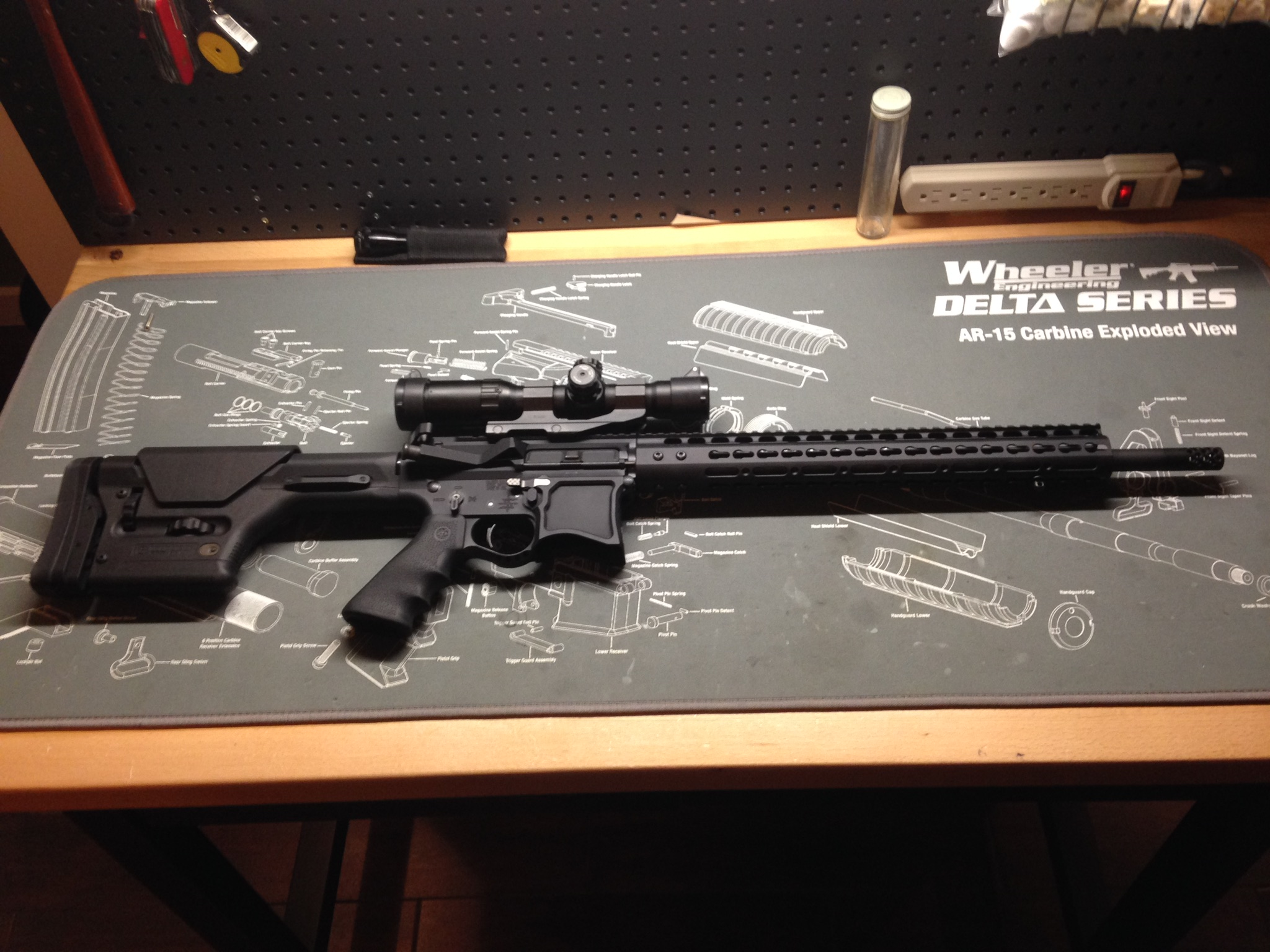

Dedicated 22build. Seekins Precission billet upper and lower, CMMG bolt, Hiperfire 24E trigger, Beyer 18” barrel, Magpul PRS stock, and Noveske NSR handguard. Cycles perfectly with standard velocity ammo. Since this picture was taken I have swapped scope for a Vortex Viper HST 6-24X50

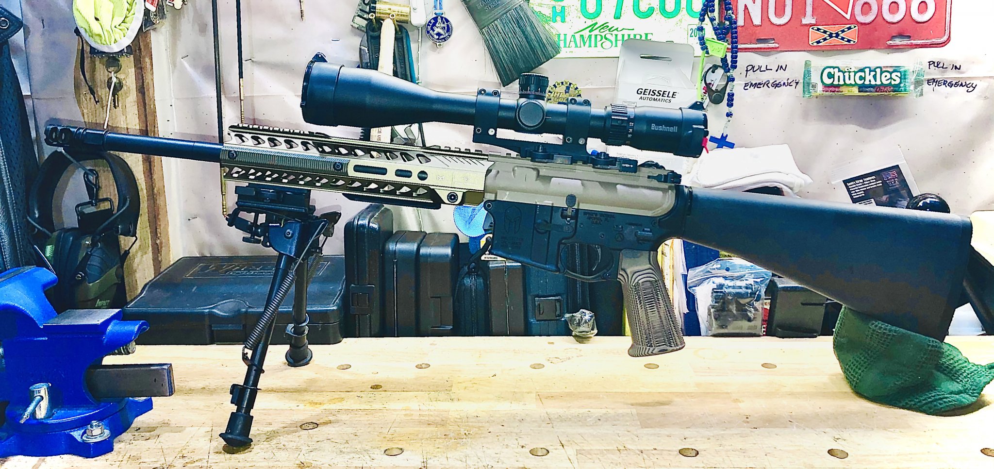

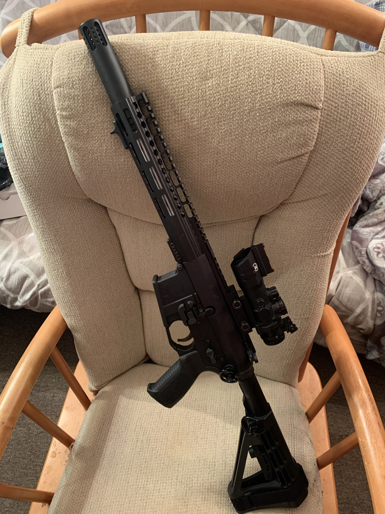

Here’s my newest dedicated AR22-
Spikes lower with Geissele G2S trigger, A2 stock, and VZ grips FDE pistol grip, Catch 22 bolt catch. Upper is FDE Aero upper with Lothar Wather dedicated 16” barrel, CMMG 22 bolt, collar, bore buddy weight kit, Strike Industries 10” FDE rail, Bushnell 6x24 Engage scope in LaRue mount, and Harris bipod on LaRue bipod adaptor.
Reactions: danr

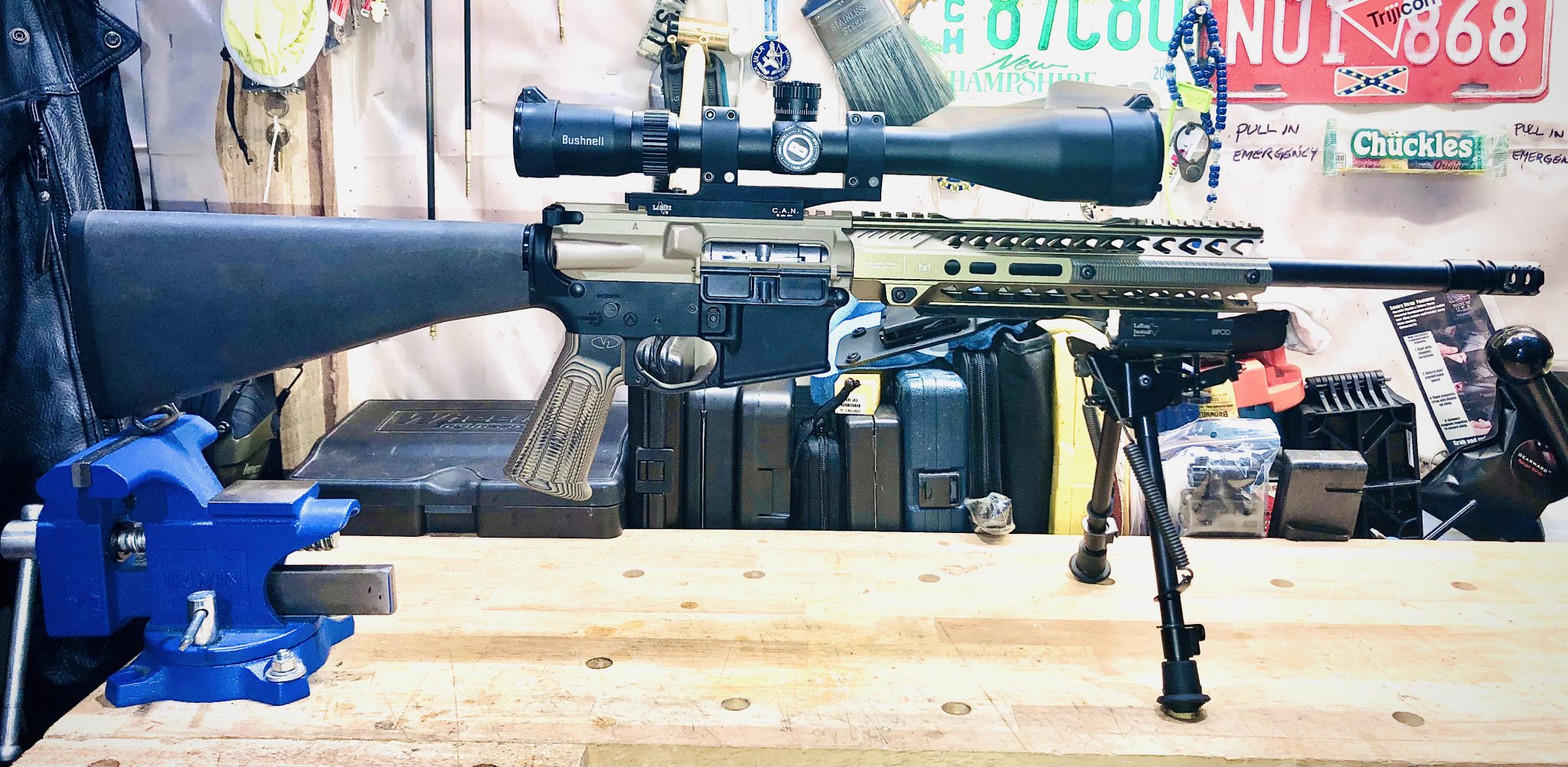

Hey, where’s the gas block! 🤣
