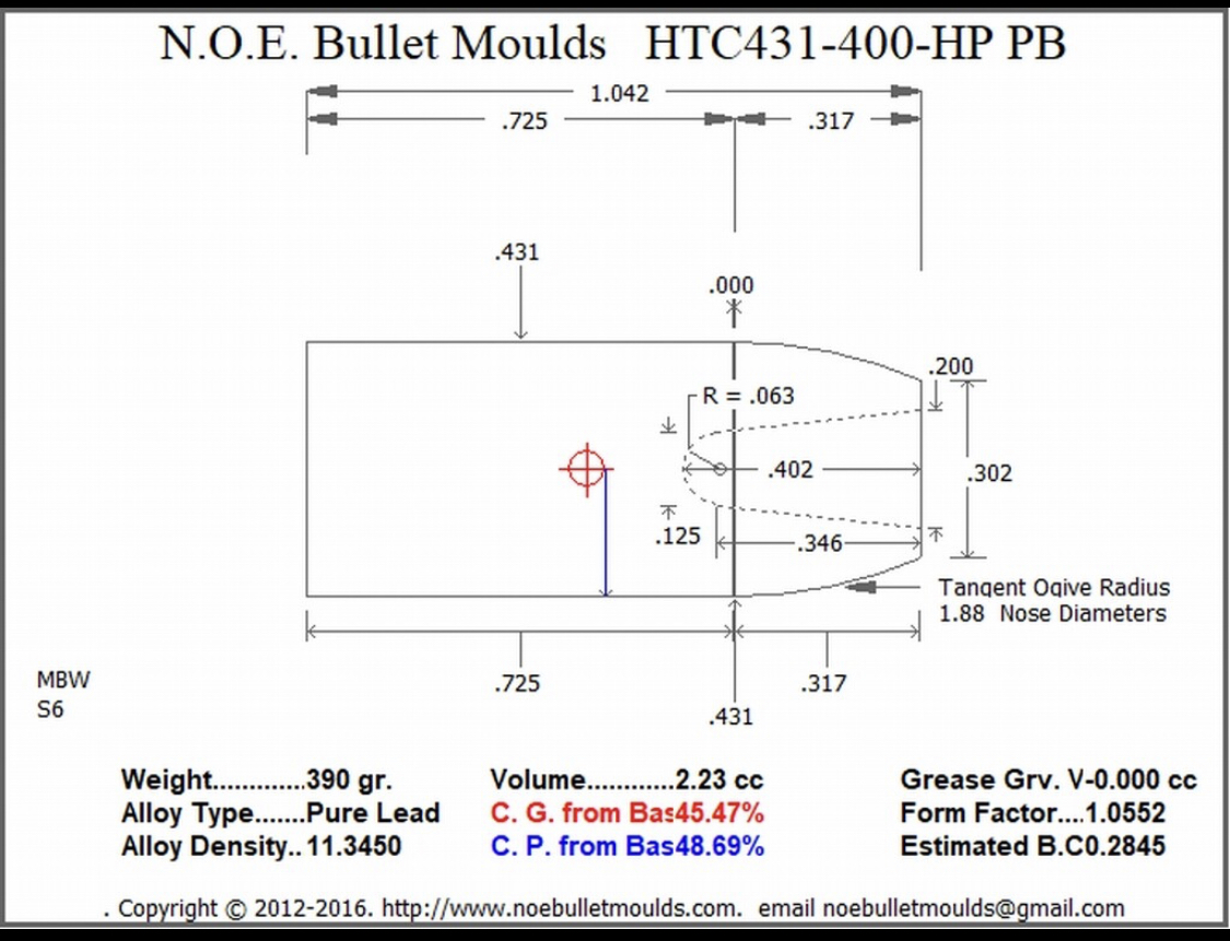

I’m about to pick up a Henry Big Boy X in .44 RM. next plan will be to get a NOE 400gr bullet cast. The 1-20” twist of the Henry will stablise them and a hard cast 390-400gr hollow point will do well at 1000FPS.

If you already have a .45-70 with muzzle threads then pick up some 410gr Sub X and call it a day. They are already 45 cal and the 410 is designed for max expansion compared to the 190gr sub X which is designed to meet the FBI barrier requirements.

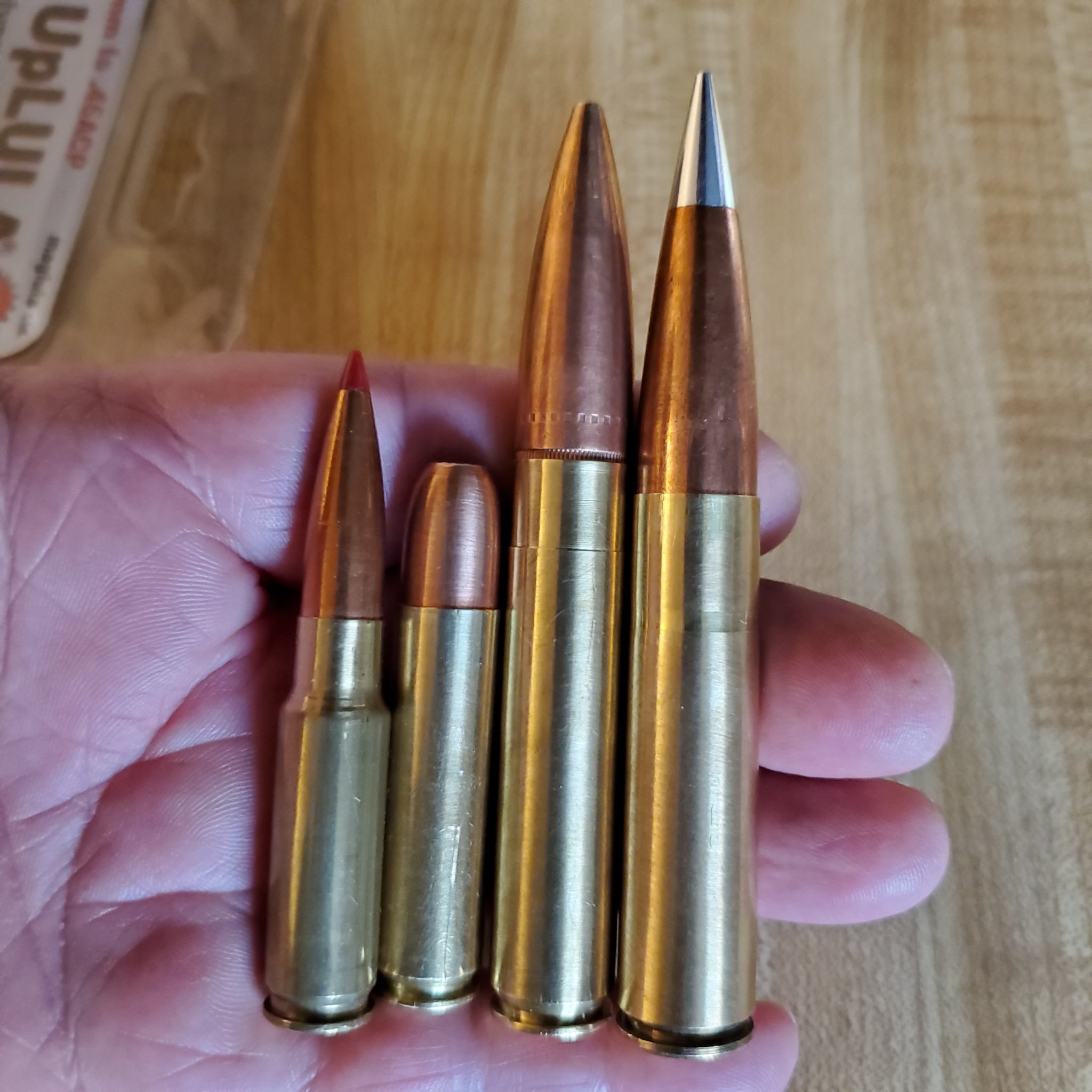

R to L here is the 8.6 Blackout, 450 Bushmaster with 500 gr jacketed S P, and two .510 cartridges on 300 RUM and 338 Lapua...I decided on the 338 Lapua brass with the 750 Amax, everything is ordered including chamber reamers and two barrels, one is just a replacement for the 8.6, 3 twist, going to a 6.5 twist.

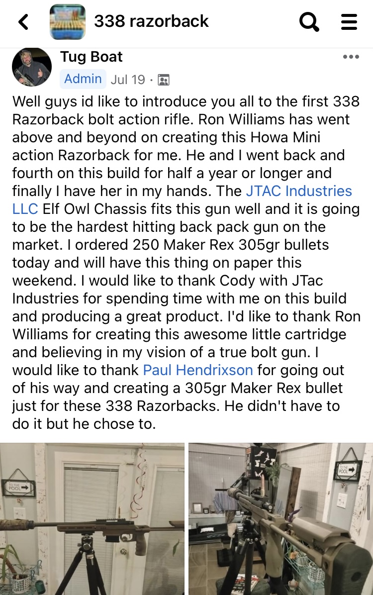

Meh. I contacted Ron a couple of months ago about getting a bolt action barrel chambered. We emailed back and forth a couple times but he was never really able to clarify or confirm if he had the ability to chamber barrels, could provide a reamer, knew anybody that could do it, etc. I ended up just doing a 338 Spectre and buying Spectre brass from SBR Munitions. The Razorback is a neat idea but it's barely a wildcat. If the guy that invented it can't assist someone with finding a reamer or chambering a barrel, good luck.

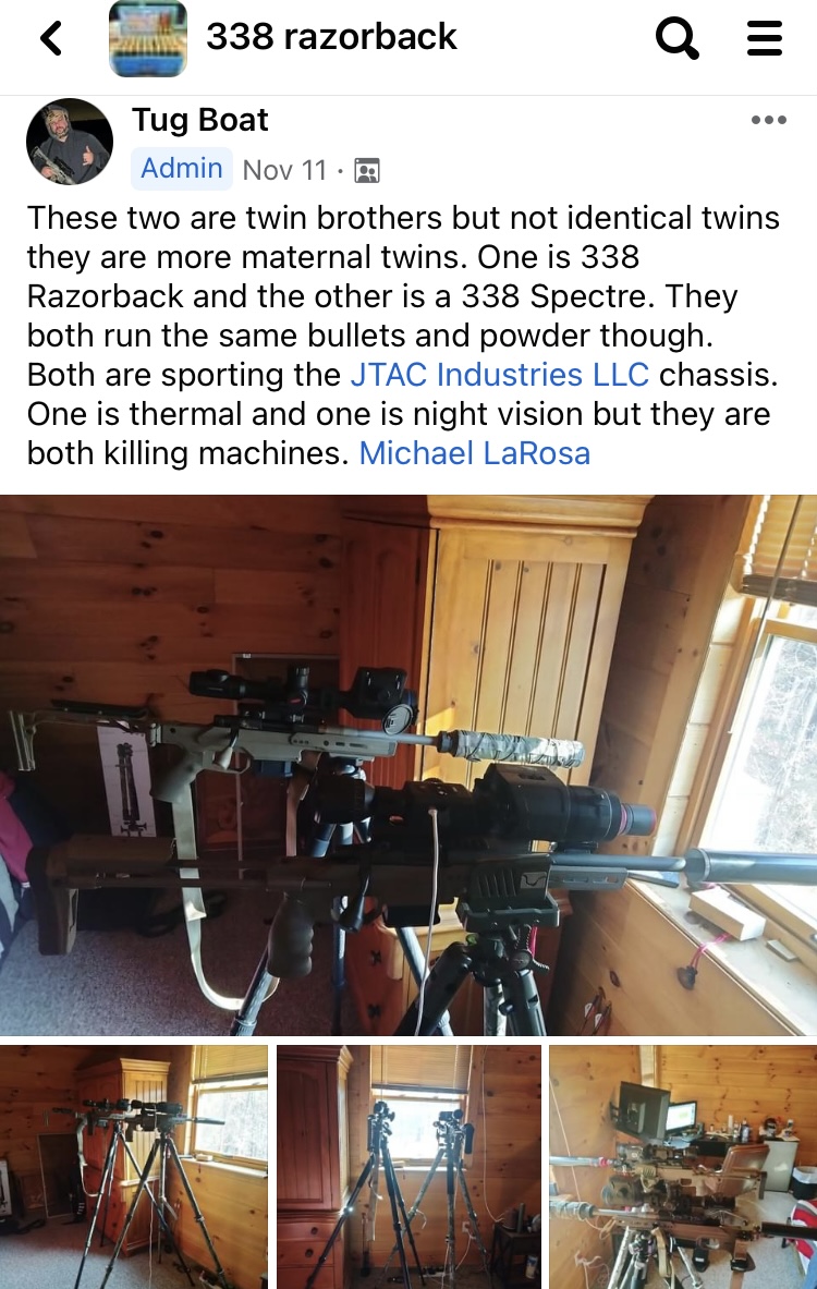

Good for him. Guess someone was able to get a barrel from Ron. Meanwhile Spectre reamers, dies, and brass can be bought or rented today. Essentially the same cartridge. 8gr of Lil Gun fills up the Spectre case capacity.
