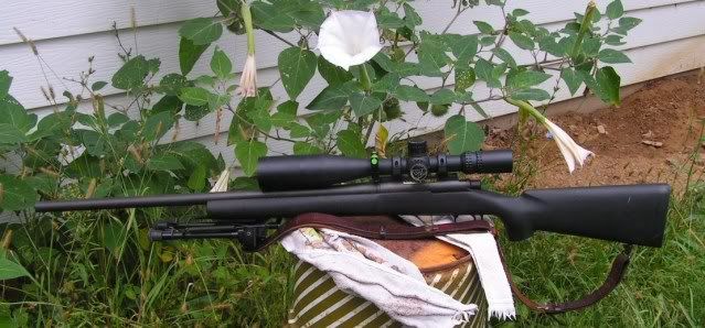

I'd like to look old school on my clone already have everything but a mount system. How would Dednutz one piece look? I'd like IBA or Texas BA set but a little pricey. Alternatives and suggestions appreciated.

It is quickly becoming my go to mount. It is lighter, cheaper, and at least as strong if not stronger than using both a base and ring system. The three I have so far have been very well made. The only down side is the cheesy name...

Ugly or not they are a 1/2 pound less weight to carry compared to a tactical steel base and ring set. They get you a lower to the bore as well.

I like my DNZ products. They are CNC machined, so I think looking like they are "welded" is not an accurate description.
They eliminate the possibility of the rings being misaligned, and also eliminate the possibility of the rings loosening on the mount. Also, like the Talley Rings, they are made in the US of A (in North Carolina, for the DNZ).
I've never had one leave a mark on a scope, and as advertised, have never needed to lap the rings on a DNZ product.
The looks are not for everyone, but then neither is Guinness.

No lug and I have not had any issues using the supplied T15 screws torqued to 22-25 inch pounds per DNZ instructions.

Outstanding sub 3oz product, I use them on a couple rifles and have installed several for friends.
The cutout makes single feeding manageable with thick gloves.
Never needed to lap them, they're on paper @100yds every time, no ring marks but I use a feeler gauge to hold gap while torquing.
This is a plus, as most aluminum rings are hard anodized and lapping destroys the coating.
They are a solid choice if you use a dedicated scope on each rifle.
I think they'd look good on an M40A1 build & they'd work great.
