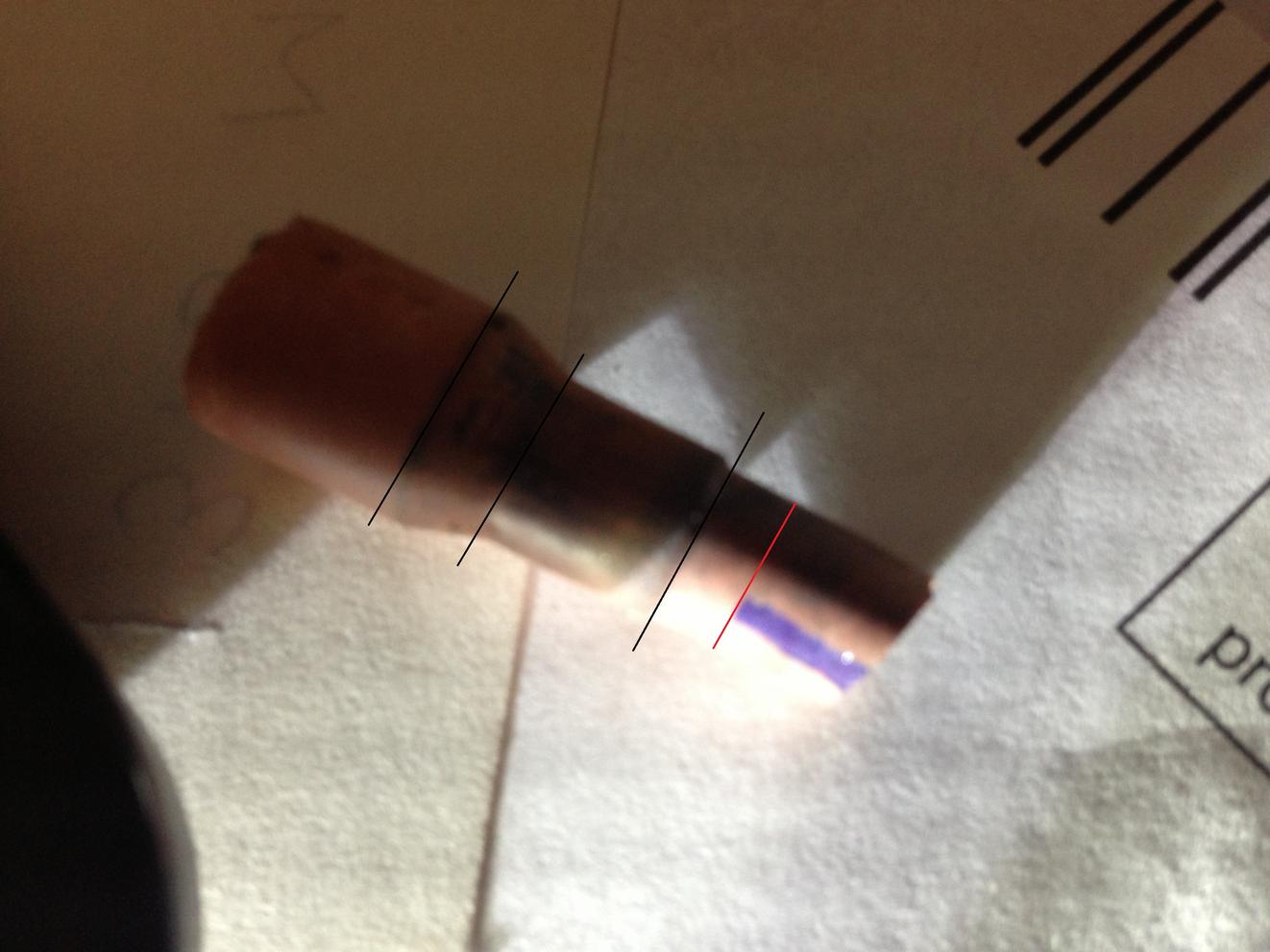

Here's a picture of the mold. The first 2 black lines is the shoulder, the 3rd is the end of the cartridge length (which is surprisingly deep, you could be running a case trimmed to 2.035 and still have a smidge of space at the end) and the red is where the rifling begins.
