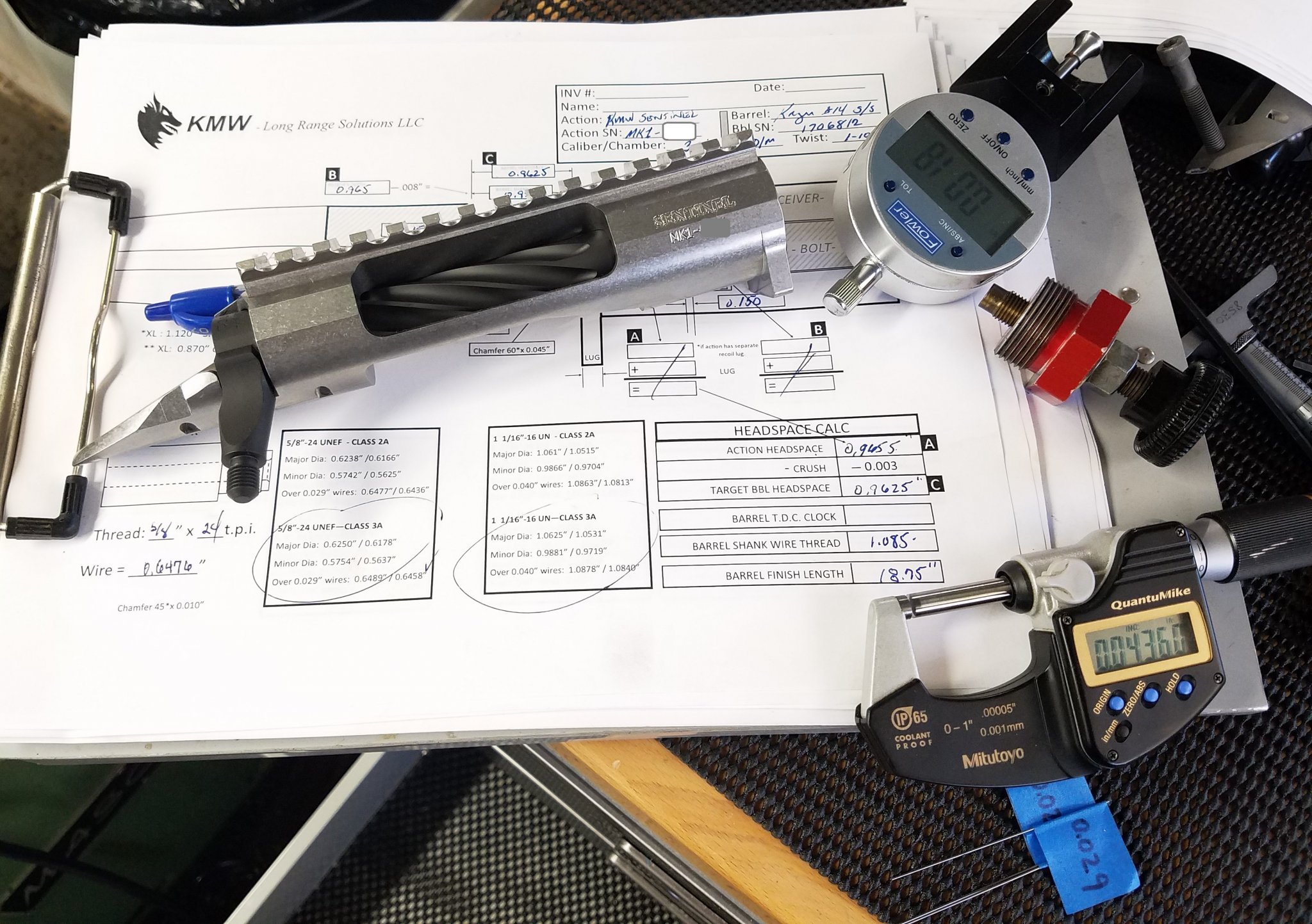

This week I have been documenting dimensions and headspace measurements from a group of actions in preparation to shipping their bolts, cocking pieces, extractors and firing pins out for DLC. This allows me to proceed with doing all the barrel breech work for each receiver even while the bolts are out for coating.
What caught my attention yesterday and tonight was the crazy consistency of the measurements across this group of 11 short actions and 4 long actions. Using my particular methods and tools, I documented 14 out of the 15 total actions being inside a 0.0005” headspace range.
That is half of one thousandth inch. The one action that was outside that limit was only another half thousandth long. So even counting the “bad” one (sarcasm), all fell within a one thousandth of an inch range.
At worse, I was previously seeing everything across the board falling into 0.0015” H.S. range which is still very good but this latest group is exceptional.
I am getting the features I need from Defiance to suit my niche and most certainly getting the quality and CONSISTENCY that makes it a wee bit easier for me to deliver excellent rifles.

Many of my customers also need asset numbers, team numbers, agency name, etc marked into the surface when shipped. If I had Defiance DLC all of my actions prior to me receiving them, I would be blasting most of it right back off in prep for other coating.
I can finish marking all components of the actions received and ship to IonBond in batches very economically and with great turn around. I can also spec exactly what surface prep and DLC version I need. For instance, all of my bolt bodies are aluminum oxide prepped for a matte finish that has more texture while still being very hard.
If I were knocking out competition guns and trying to keep the cost, labor and delivery time short I would have no issue getting them delivered completely processed already. That is not my market so that is not what I order.
