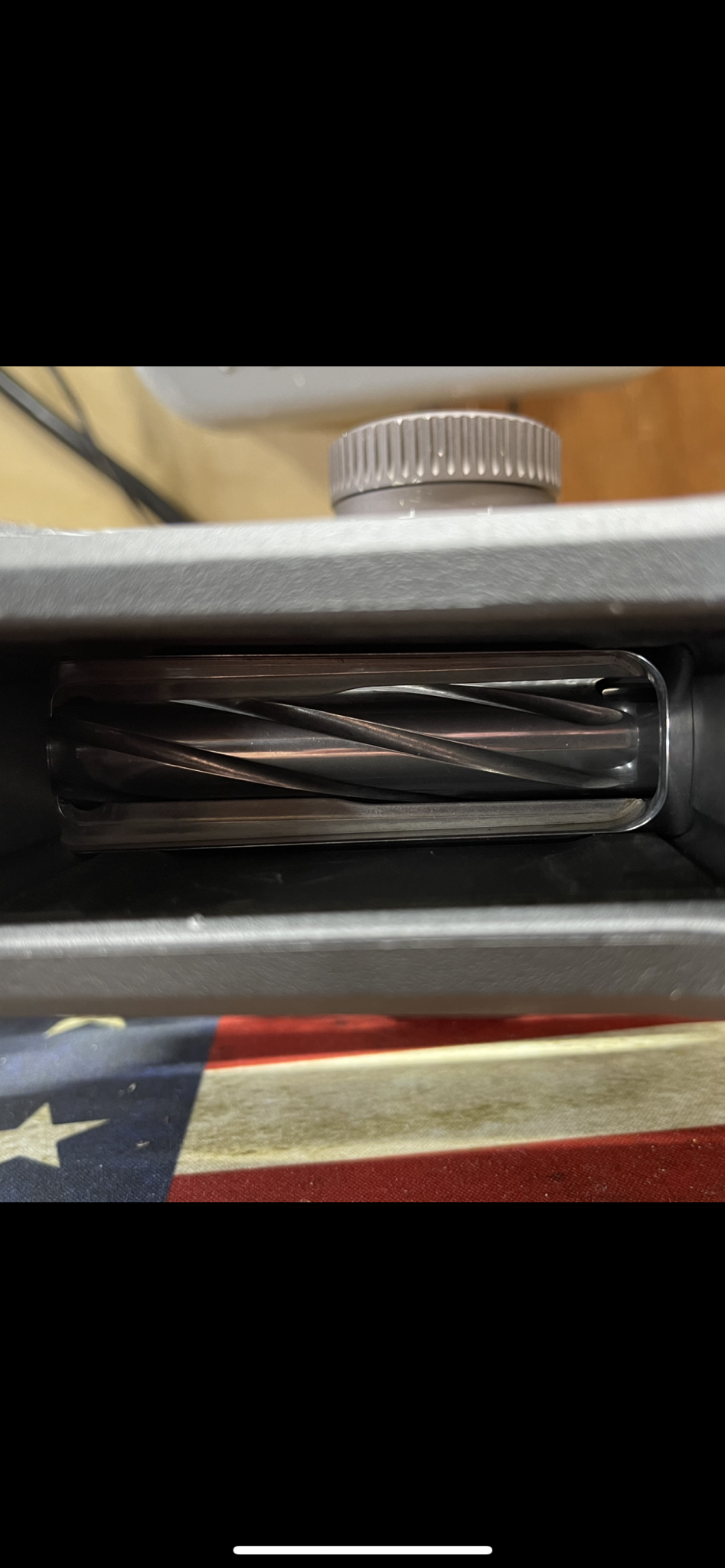

So this is my fist custom gun, wondering if the offset of the mag-well is ok and not a bit too rear-ward.
The reason I ask is I’d like to load my rounds further out to magazine length, but when I do the tip of the bullet (no matter the kind I use) gets caught under the action.
Is this something to even worry about? Thanks in advance

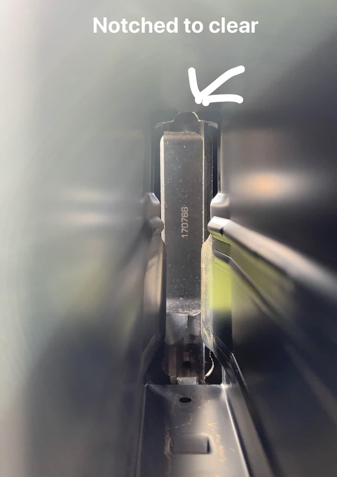

You need mags with a binder plate to keep them back from under it or you need to notch your feed ramp
