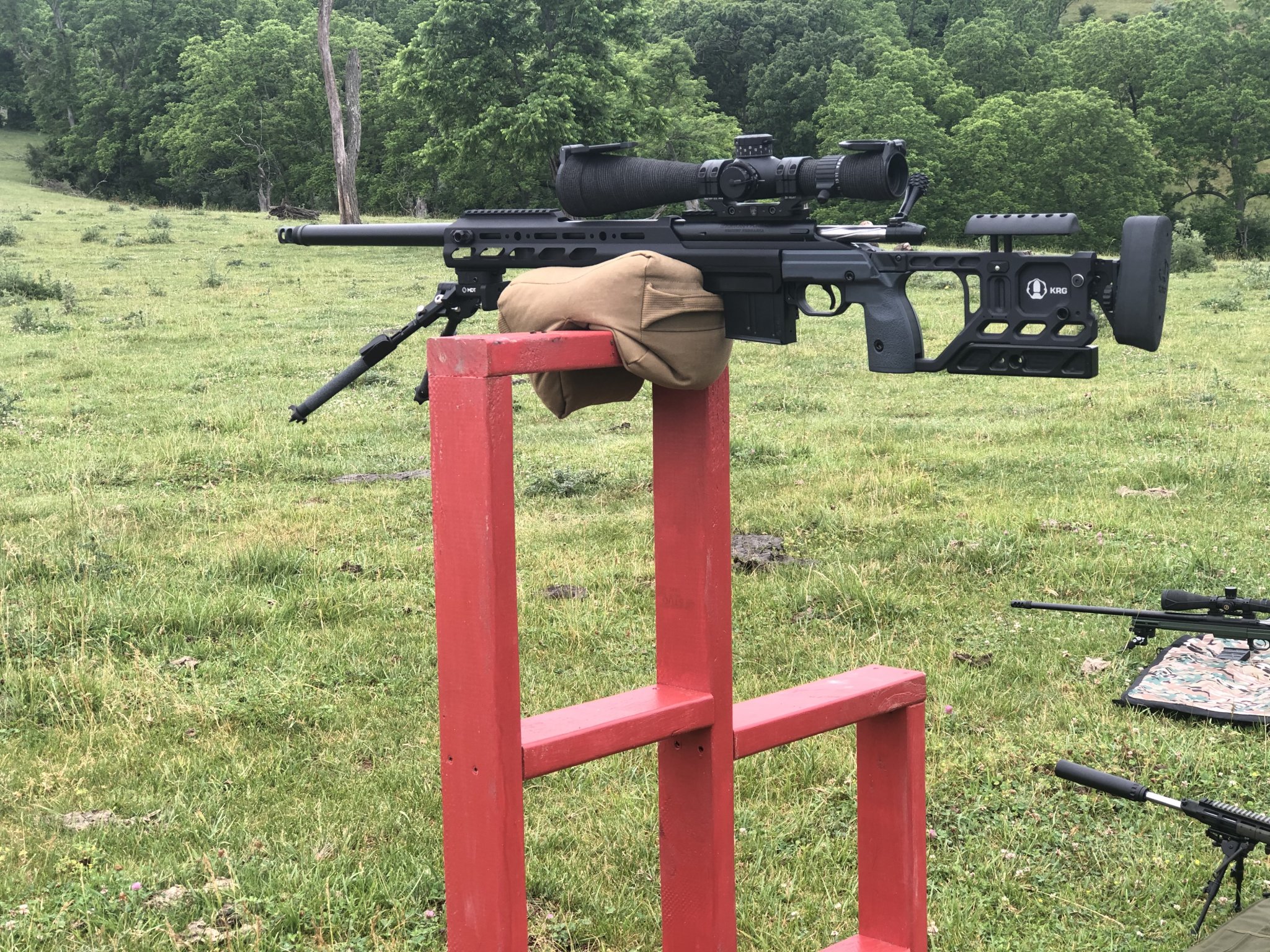

Fits good in the mpa and the krg bravo/whiskey 3.

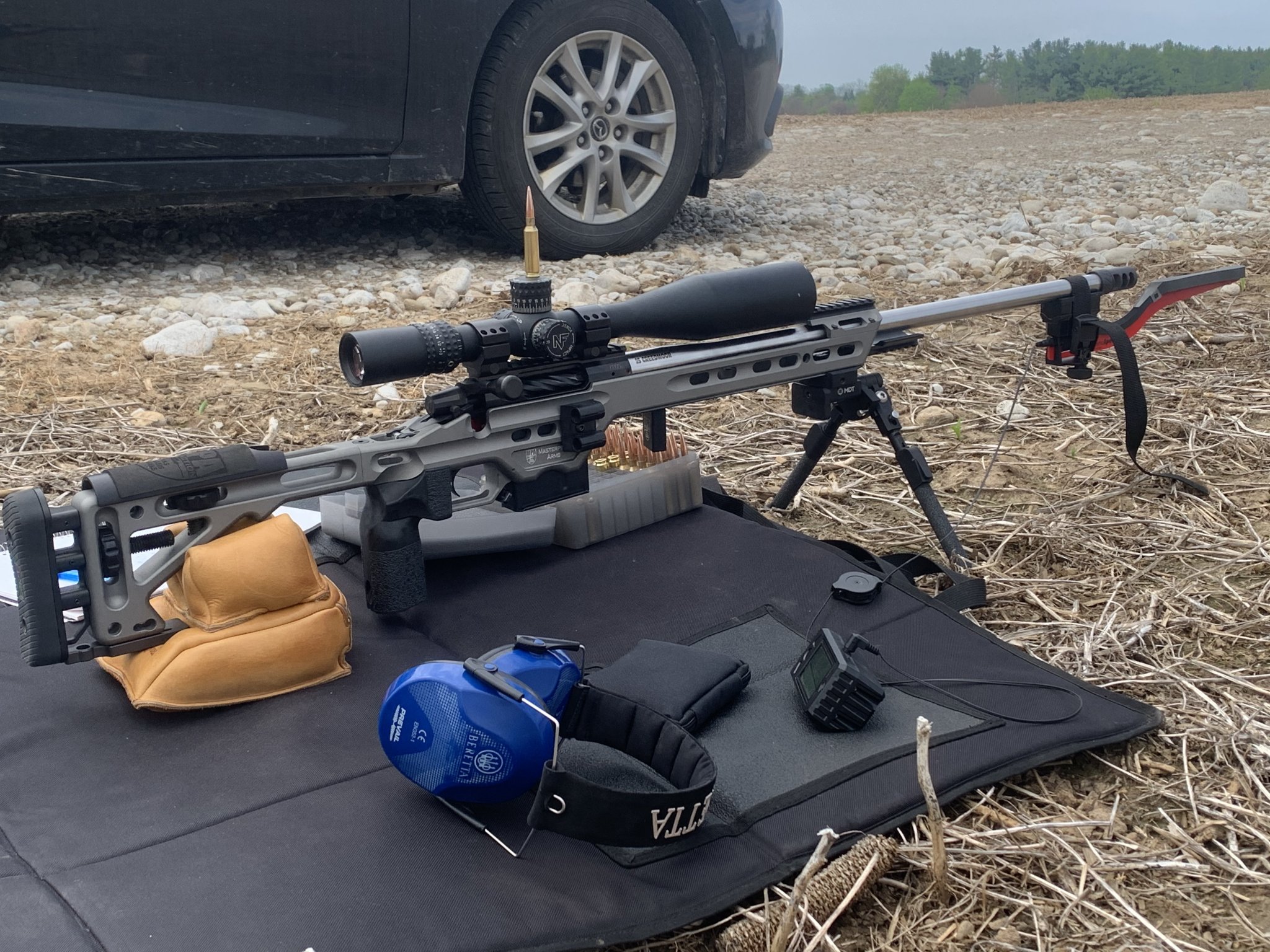

I love my bighorn but my defiance was excellent too. Both are smooth as snot. Came down to the control the bighorn gives with controlled feed and mechanical ejection for me. You'll certainly be happy any route you take.
