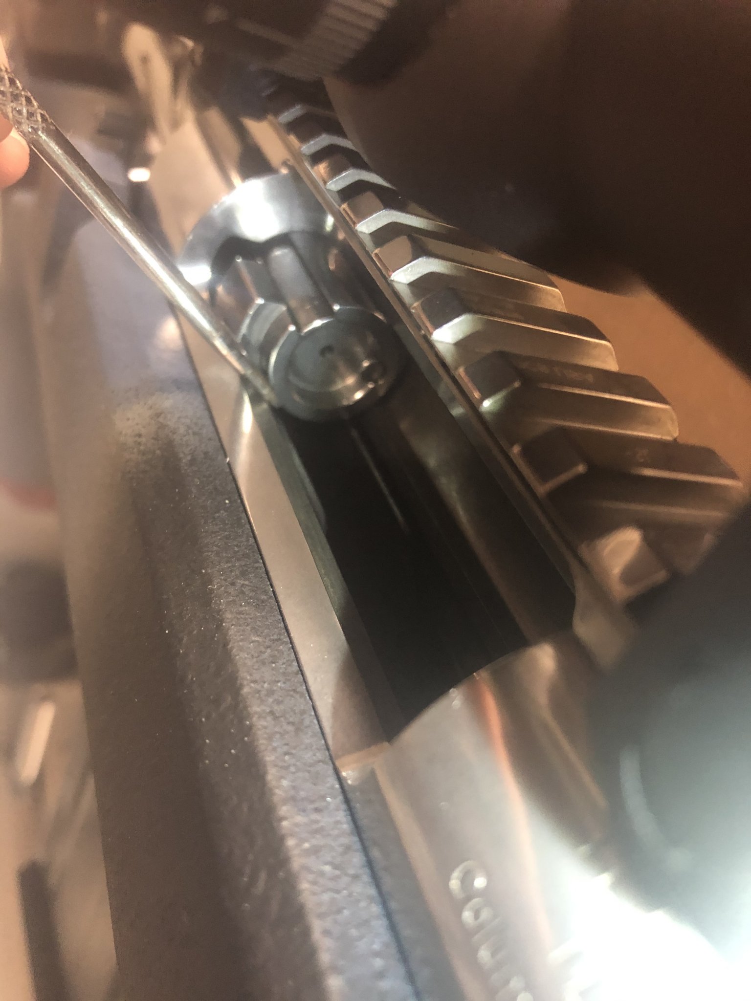

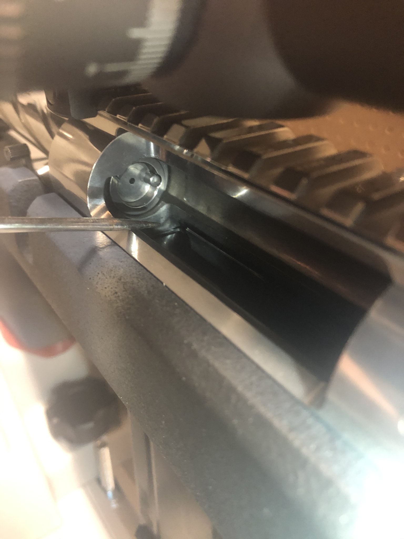

What magazines are you running on the lone peak builds? Just assembled my XM build tonight and the magazines (MDT) are not seating to “lock” in the bottom metal.
Appears that the magazines do not match the bottom port of the action, as there is contact in the rear with the action. The last 0.0625” (1/16”) is needed to feed onto the ramp vs the face of the lug ring.
Seems that little to nobody runs a DBM setup on an XM/Medium action...

Update:
Glen, Cody, and team at Defiance reached out to me and straightened out the issue. Total time without rifle under 48 hours. Problem solved.
