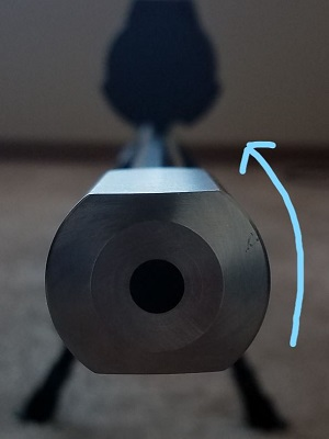

We will start with the muzzle brake. I chose a brake that had to be timed and installed by a smith just because I like the way they look. This was the result.
Notice how it is clocked counter clock wise? I know some brakes benefit from this if there are top ports but this one has none and I see no benefit to doing so.

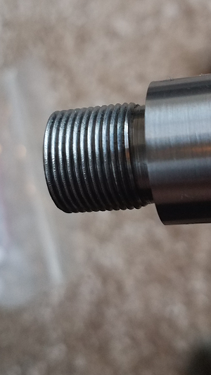

Next we go to the threads. They look pretty rough in my opinion. They function so that's what matters but just seems sloppy.

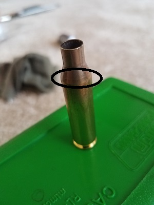

And then the chamber. Notice the ring in the shoulder? I was told by Jim See that this is due to a chip that got in the chamber while the reamer was being run through. Again, functional but sloppy.
