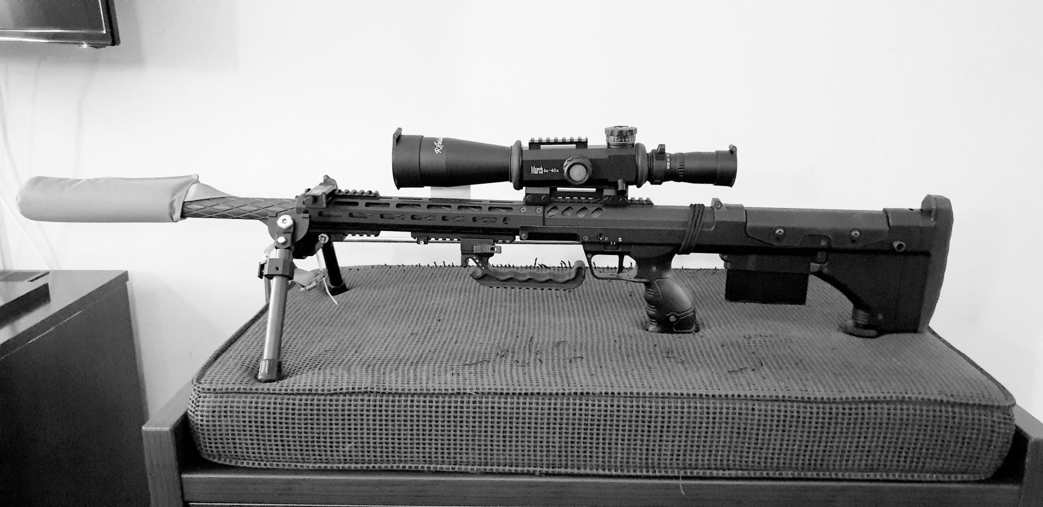

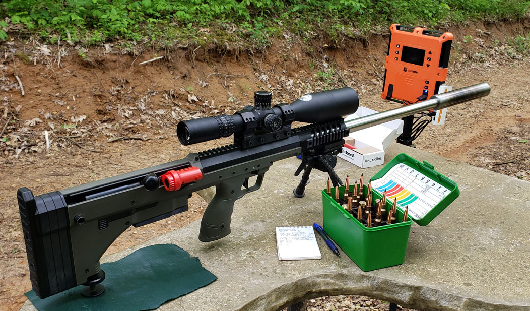

I finished up my Schneider barrel for my SRS gen 1 about a month ago and have had a chance to shoot it a couple times. I started with the 1-8 twist P5 rifled blank and turned it with a long section straight at the 1.25" diameter that will allow it to be set back a number of times to help with throat erosion. The forward 15" of the 31" barrel has a slight taper to 1" diameter. The barrel weighs about 10 lb and is pretty solid which was the point. With my suppressor installed there aren't any problems with whipping.

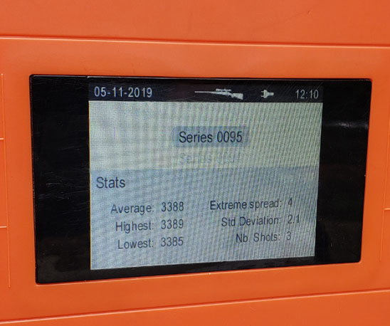

I started with 250 gr Cutting Edge Lazers and Reloader 33 with the results pictured on the chrono. Not too bad but my plan was to use the 300gr Lazer or MTAC. All I could get at the time was the 250. In speaking with the Cutting Edge guy at the NRA show he suggested the 265gr might be a better choice than either the 250 or the 300. I did some more testing and managed to get the 265's up to 3400 which should be pretty ideal. Accuracy with both weights was good but not outstanding. Groups were right at an inch but both tests were at 100yds and not under ideal conditions. I can do better and I believe the rifle can as well. I'm heading out today I hope to nail down the load I'm taking out west in a few weeks to try my hand at 2000-3000 yds.
So far the rifle seems to handle the long heavy barrel and the cal just fine. Those who think the covert length handguard won't work with the long barrel are mistaken, it works fine with no tendency to tip or wobble. Love the monopod and I just swapped out my old 5.5-22 NXS for the 5-25 ATACR and I love it. With the new 70 MOA one piece mount a friend designed I've got 120 MOA of adjustment in the scope plus the hash marks in the reticle to use. I think you'll like the round in the DT and it is worth doing. Much better than shelling out another $6K for an HTI and 375 Cheytac gear.

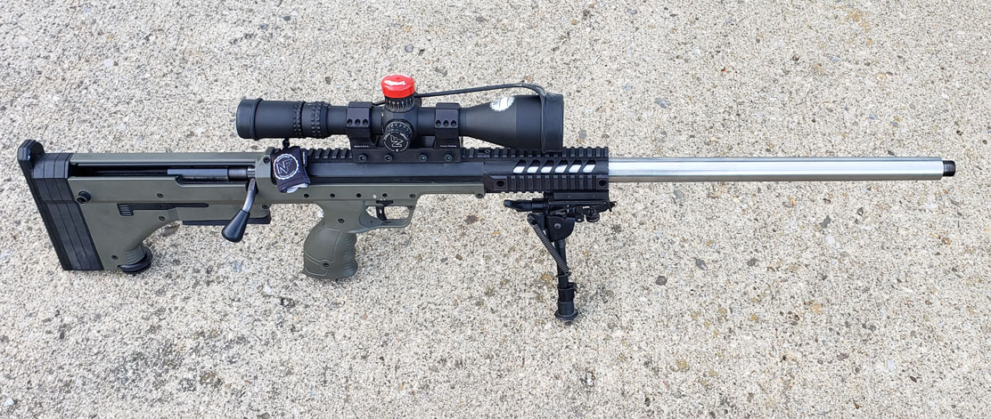

I have built a 33XC on a desert tech and very happy with it. I should have the 37XC barrel ready next month for thr 400gr lazers and a 6.5creed for training. It did well in italy to 2200meters/2400yds so looking foreard to the 37XC next. We did quite some work on the load. Barrel life is short with the 33xc at 310rounds im probably past 52%of barrel life but it s a great cartridge. Full report here
Thanks for sharing your 33xc build. Can you mag feed the rounds or do you just single load?
