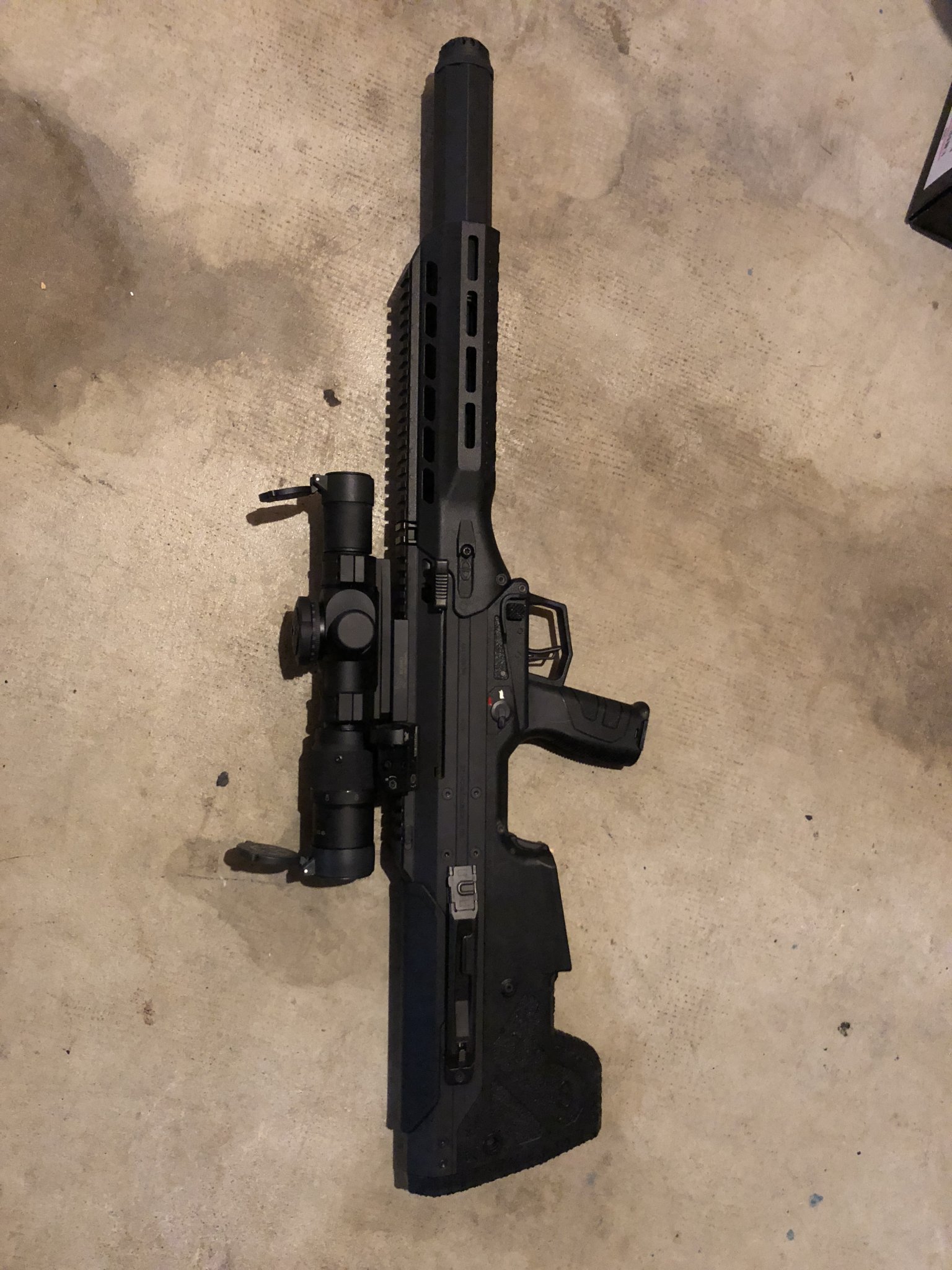

I finally think I got mine to where I think it is working reliably and not super over gased while suppressed. I run an OSS on it and the only issue I've had in the past 200 rounds was somehow the ejector arm door got blown off. I wasn't shooting it, I let a good friend of mine so I have no clue how that happened. Other then that, since getting the 2018 ^ position valve it seems to be working a lot better. It's the most infuriating rifle I own. When it works, it's my favorite but when it doesn't I just wanna chuck it. It has been thrown across the range once or twice...
Appreciate the update, I've held it a loved it enough that I'm willing to deal with some issues. I'm just not willing to buy it if it's just fundamentally broken. I'm about ready to buy one now, just want to wait a little bit to see if DTA themselves has any updates.
I have to ask whats up with that handguard? I was always planning on buying the OSS with my MDR. I just don't want it sticking out like that.
I wanted to love mine but after about 500 rounds in the issues, many identified above, were too much for a rifle of this price range. My SCAR 17S runs like a raped ape and was the same price. I'm patiently awaiting the release of the Tavor 7. Delayed due to accuracy issues at factory testing and glad they are sorting that out now.
I have to ask whats up with that hand guard? I was always planning on buying the OSS with my MDR. I just don't want it sticking out like that.
So That was the extended hand guard that went over the suppressor, but I cut it back so I can get a suppressor wrap over it.
