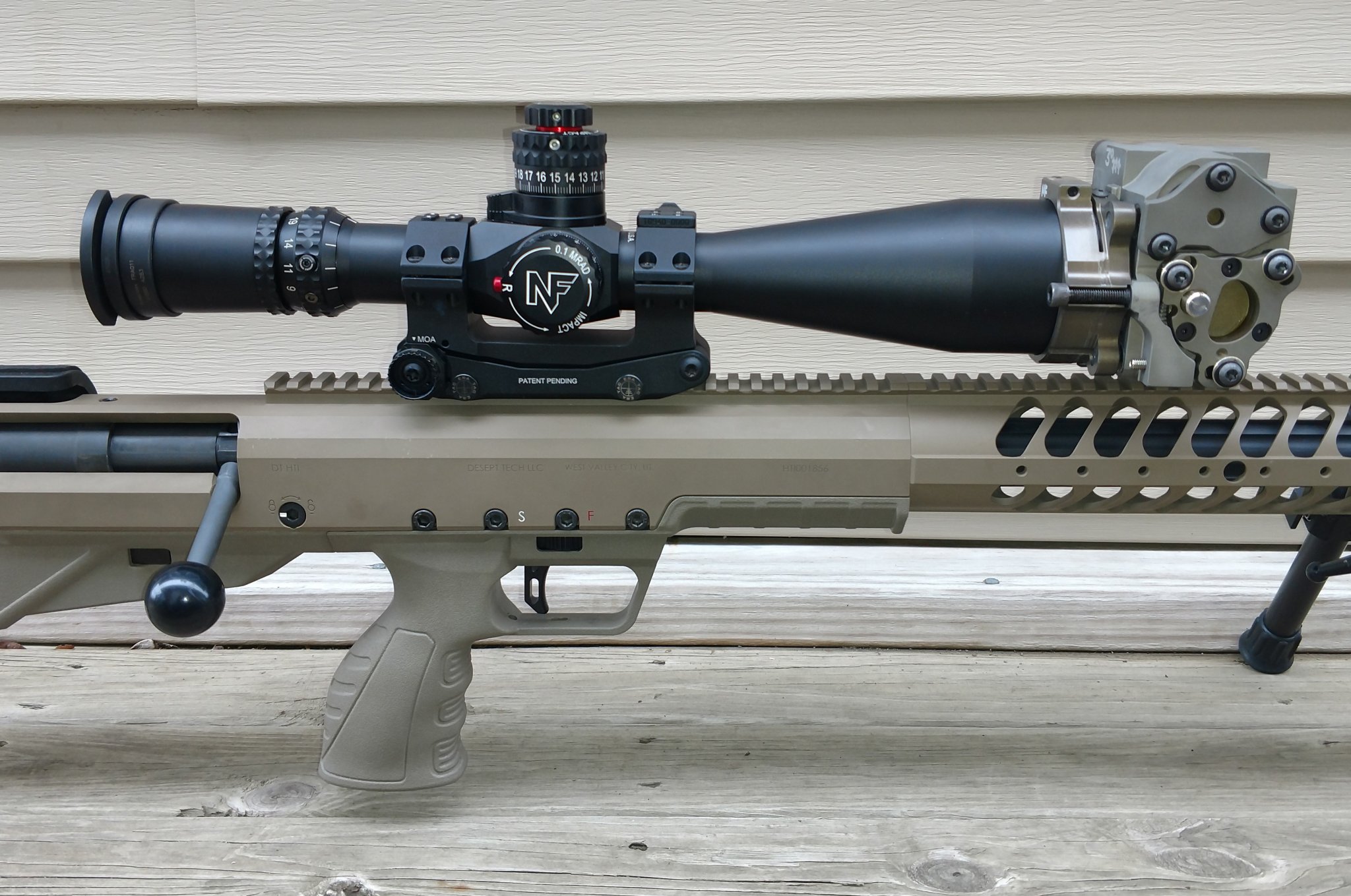

Ok guys just need a little Spuhr mount help.
Desert tech hti 375 cheytac, so a flat rail on top.
NF 7-35×56 (34mms tube)
I'm looking for some elevation so probably a 40moa cant.
Which height will do? I might be going the taco route down the road so I'll need a little clearance up front, but not to much.
Whats the correct Spuhr mount for the job?
Thanks in advance
Deano
Deano, I went with the ERA-TAC mount on mine. You will need a mount at least 1.75" in height or higher if you ever plan on adding a CT. You will probably be able to get away with 50 moa. to get the most out of your elevation turret. 40 would be a safe choice in a fixed mount though.
Todd
