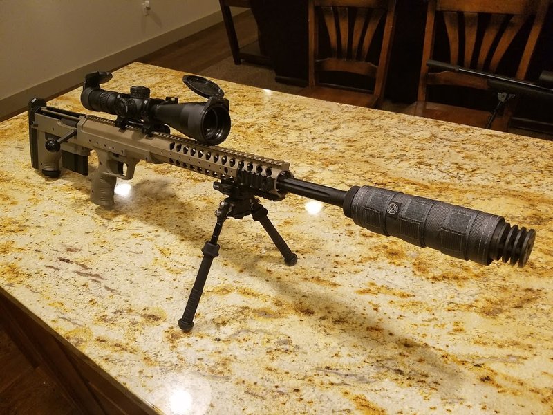

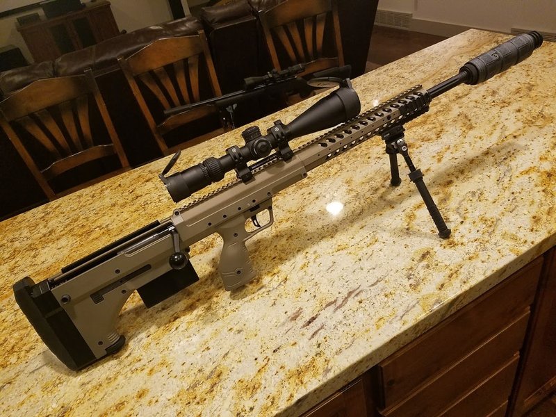

DTA SRS-A1 with 6.5 Creedmoor Conversion

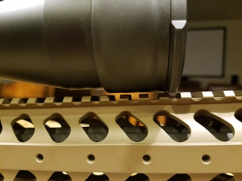

Vortex Razor AMG MRAD - incredibly clear scope glass. I could easily see my hits at 1 mile on the plate - very, very, very clear!
ARC M10 QD-L Mount (Standard) 30 MOA- great mount, but the bubble level wasn't level to the rail so it's quite off relative to the scope reticle/rifle/lo pro level.
Vortex Lo Pro Bubble
Atlas Bipod with ADM QD Mount
Silencerco ASR Brake
Silencerco Omega Silencer

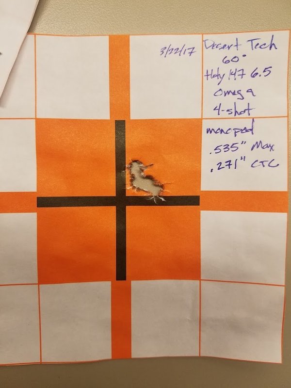

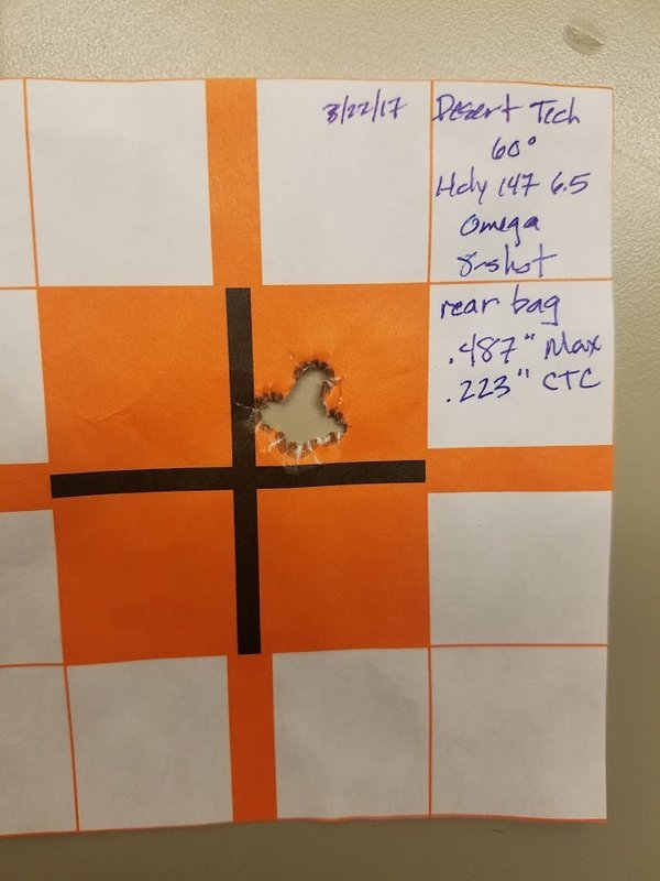

Decided to do a break in process with factory Hornady 147 ELD-M (BC of .696) by cleaning after each of the first 3 shots (M-Pro and Patches - no brushing), then a 3-round group, clean, then a 4-round group, clean, then shot an 8-round group off zero to retain the target cross hair and used the last 2 rounds to get a perfect Zero. Pics below show the 4, and 8-round groups. If you overlay the two targets the 4 shots fall right through the 8-round hole. The 4-shot group was shot off the bipod and rear monopod, 8-shot was using a rear bag. Measurements are noted on the pics - used an RCBS electronic caliper for a "close enough" measurement...

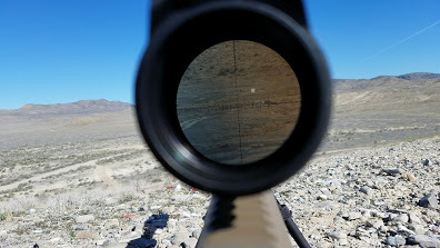

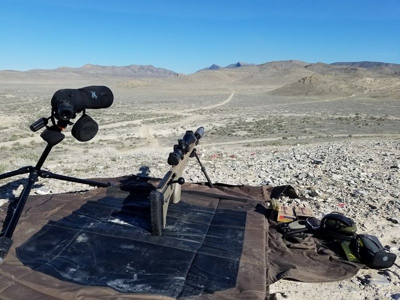

I've used Strelok for the past couple of years with good success; however, I was intrigued by the BallisticsARC app with the Weatherflow Weathermeter and thought I'd try it out. I zero'd the rifle in two shots on a 16" plate at 982 yards and used the "trueing" feature which resulted in a trued muzzle velocity of 2615.5 fps (box claims 2685 fps or thereabouts). After zinging the plate another 7 times I loaded a round, updated my drop chart, and took aim at the 30" square plate I setup at 1768 yards (verified using gps and Sig rangefinder - they were within a yard or two back and forth). BallisticsARC gave an elevation call of 22.3 MILs and .7 MILS for wind/spin/etc. My scope has exactly 21 MILs of elevation with the 30 MOA mount and a 100 yard zero so I maxed out the turret and.....forgot to hold the additional 1.3 MILs!!! My first shot was perfectly in line for windage and impacted just in front of the target - the moment it hit I realized my mistake and cussed to myself as I self-sabotaged my first shot at a mile. Loaded another round, held the 1.3 for elevation and sent it - impact 8" right off center with perfect elevation. I was absolutely thrilled - with the remaining 9 rounds I tried to hold the exact same location (difficult for an amateur shooter who isn't used to holding in between hash marks on the reticle) to see what type of group I could muster. The result is 7 hits out of 10 shots with a max horizontal spread of 8.5" without the bullet that got wonky going transonic and 18" with it included and verticle spread of 23 inches. the 3 misses were just off the right side of the plate between the frame and the plate - total horizontal spread is about 12" without the tumbler and 22" with it. I'm VERY pleased with the results and am hopeful that I can tighten up the vertical spread with my reloads as I get the best SD and ES possible. I ended up only using one box of 20 - saved the other for next time. :)
Both targets are barely visible in this photo - one at 980 yards and one at 1768 yards. Mile target is at the base of the far mountain just over the first small mountain to the far right at the end of the next valley...

One Mile target through Razor AMG at 24x

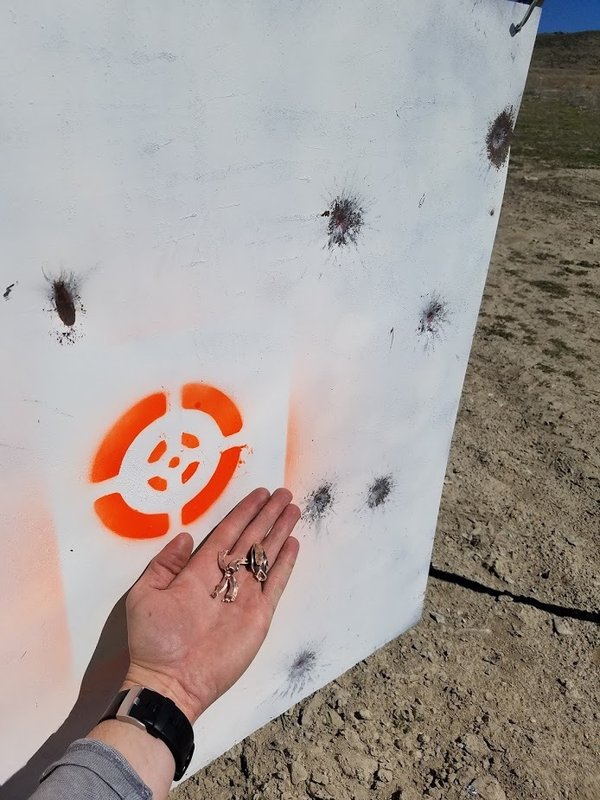

Was thrilled with my results for the first time at 1 mile - you can clearly see which bullet tumbled. I retrieved all but one of the bullet remnants...

See if they show up now and let me know - from my very limited experience, the Creedmoor DTA is VERY capable at that distance. In the pics you'll see that all but one of the impacts hit with authority (i.e. no tumbling or wobbling) so the 147 grain bullet seems to work well in the transition from super to sub.

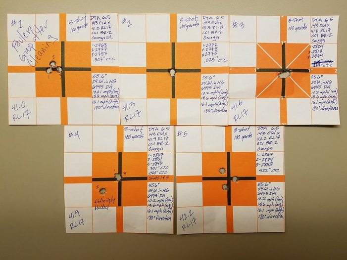

Thought I'd share my first Ladder Test with Reloader 17. First true one-hole group I've ever shot...the group at 41.9 may have been one hole as well, but I pulled the second shot badly when a braked 300 UM lit off down the line.
I'll post again once I take this load to one mile again. If it shoots as well at a mile as it does at 100 yards the group should be off the hook! :)
