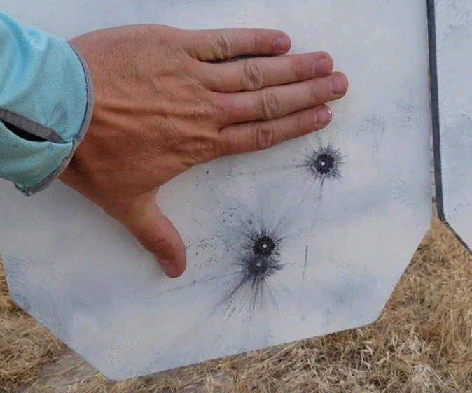

147 Grain at 1,000 Yards - first 3 shots of the day. Cold bore is upper right, second and third shots are lower left. (Sorry for the crappy photo quality - I had to snip it from a video file as I didn't take a static photo of this target) 147 Gr 1000 yards.GIF

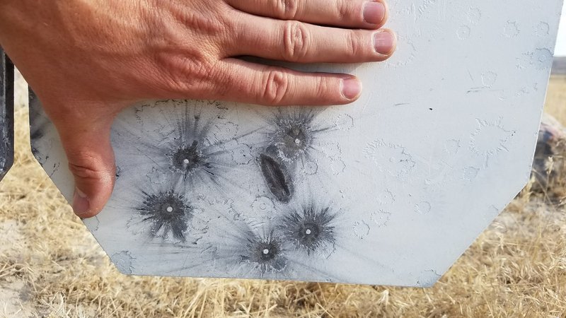

140 Grain at 1,000 Yards - 5 shot group. The one that hit sideways was from my buddy shooting a Bartlein 6.5 Creedmoor. He missed and hit low and WAY right and skipped the bullet into the middle of my group while shooting at another target. 140 5 shot.jpg

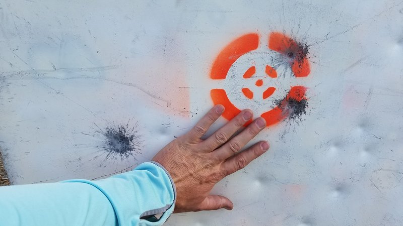

140 Grain at 1,760 Yards - 3 shot group. No wind - perfect conditions shooting almost due North. Took 2 shots to get on target, then shot two more for a group. 1st shot was upper right, second shot was lower right, third shot was left. My hand isn't extended the same on this one, so the reference is the inside diameter of the larger segmented circle which measures right at 4.25" 140 1 mile.jpg

My reason for asking if someone has software to get an accurate measurement of these is that we kept shooting until the targets were indistinguishable from each other (i.e. completely grey).
I will say that I fired the 140s in a rapid string of 20 rounds on this 12" plate and hammered it every time. Really fun to see the second hit through the scope before you hear the first "diiing"!

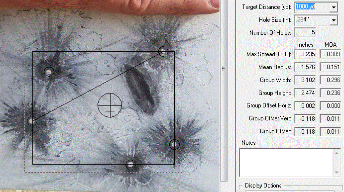

I had a second and found an app online - not sure if it's the best or most accurate, but here's my first try...
Here's the same thing for the mile group - I did it twice using different measurement references and it only changed the max spread ctc by .004. Pretty cool program! I need to bring a cheap ruler with me from now on though so I can hold it on the target when I snap a pic!
