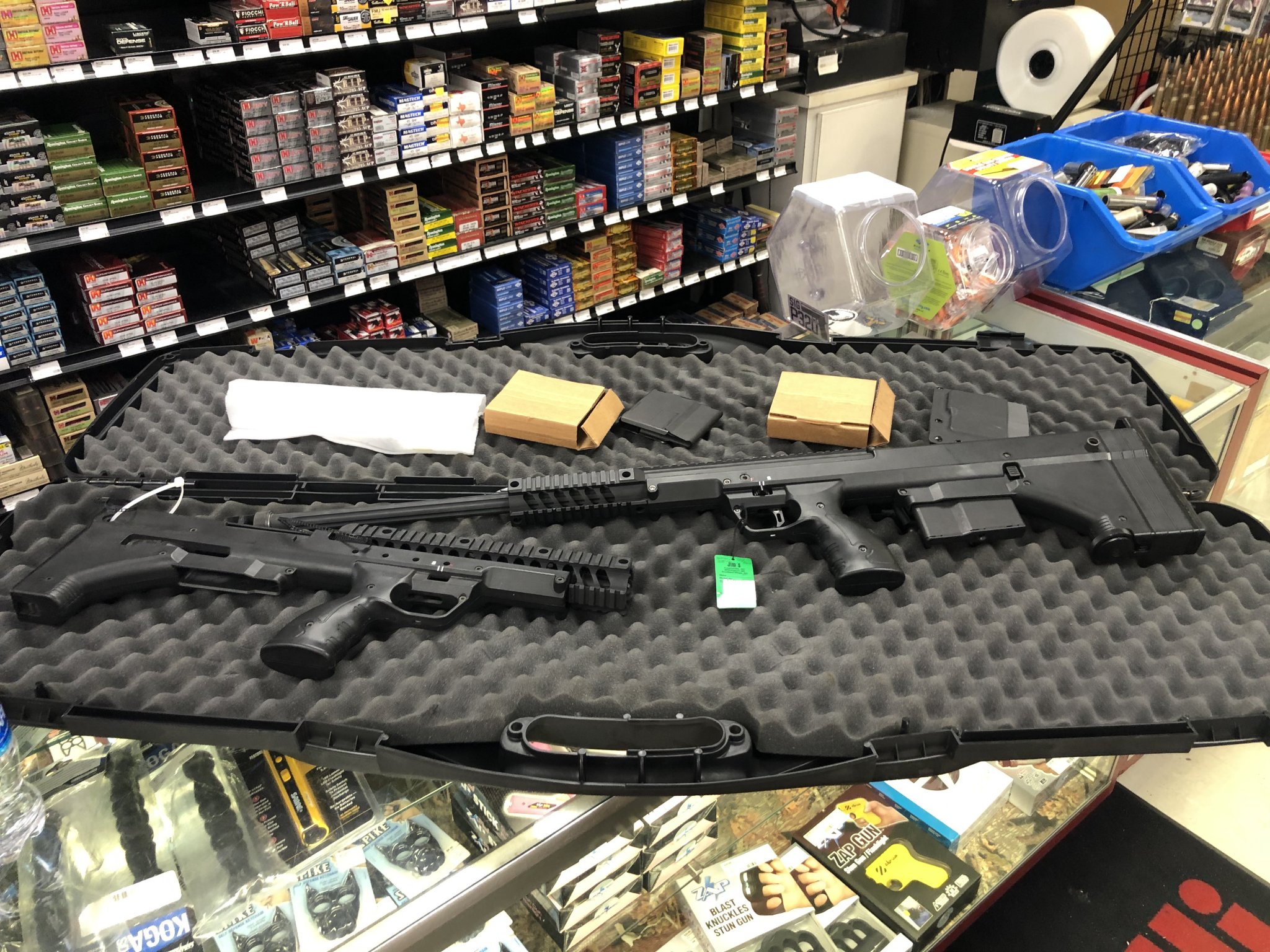

Quick question. Someone is trying to sell me a desert tech with both 308 and 300 win mag kits as what appears to be two chassis. They sent me this picture, I have never seen a SRS without a cheek riser. Is this a early gun that didn’t have them?
What you are looking at is one complete gun, extra pair of skins, and a extra handguard. If it doesn't have the cheek riser, it's just an SRS not an A1. Without being able to see the indexing pin, there's no way of knowing for sure whether it's a gen 1 or Gen 2.
There is a second barrel and bolt as well. I assume the SRS is a predecessor to the A1? I can’t find any information on just SRS.
It is the predecessor. Only things that changed are cheek riser, flat safety, non quad rail, and butt pad. The mono pod was made standard around that point too.
