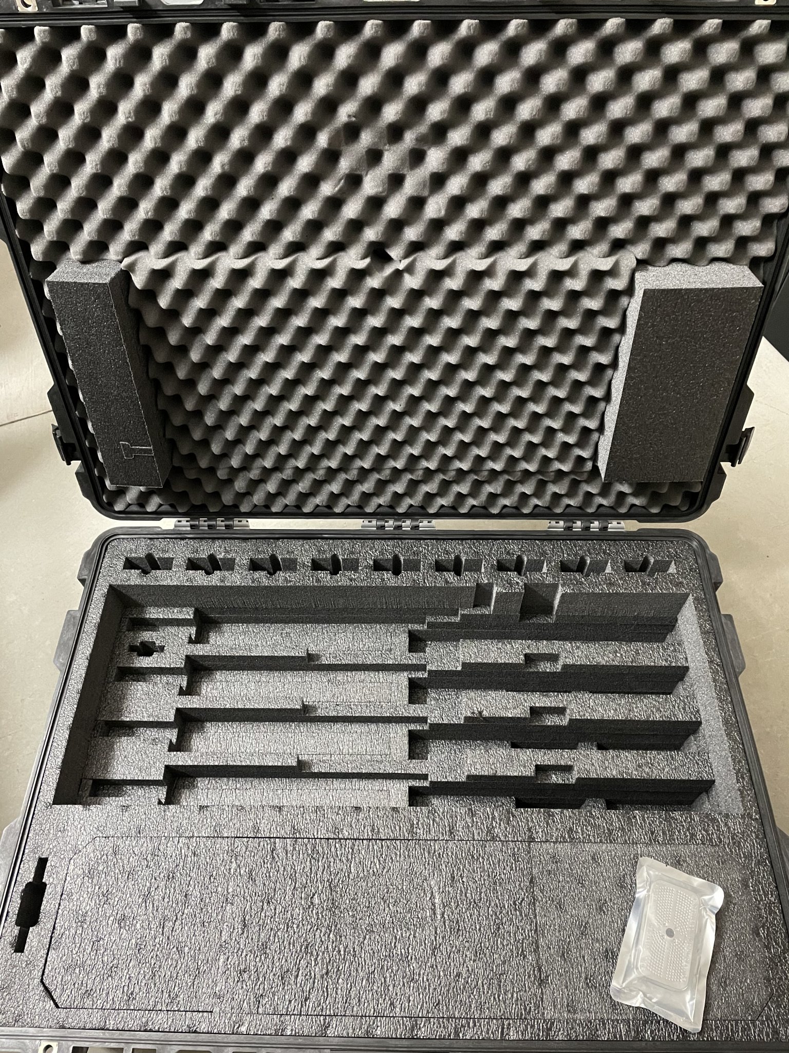

If it’s just a day or two, you should not have an issue. Here is the type of desiccant that came with this specific case. If you are interested, I can dig them out and see who makes them. I never use them as my stuff does not stay in a case over 24 hours so they are still sealed in plastic.

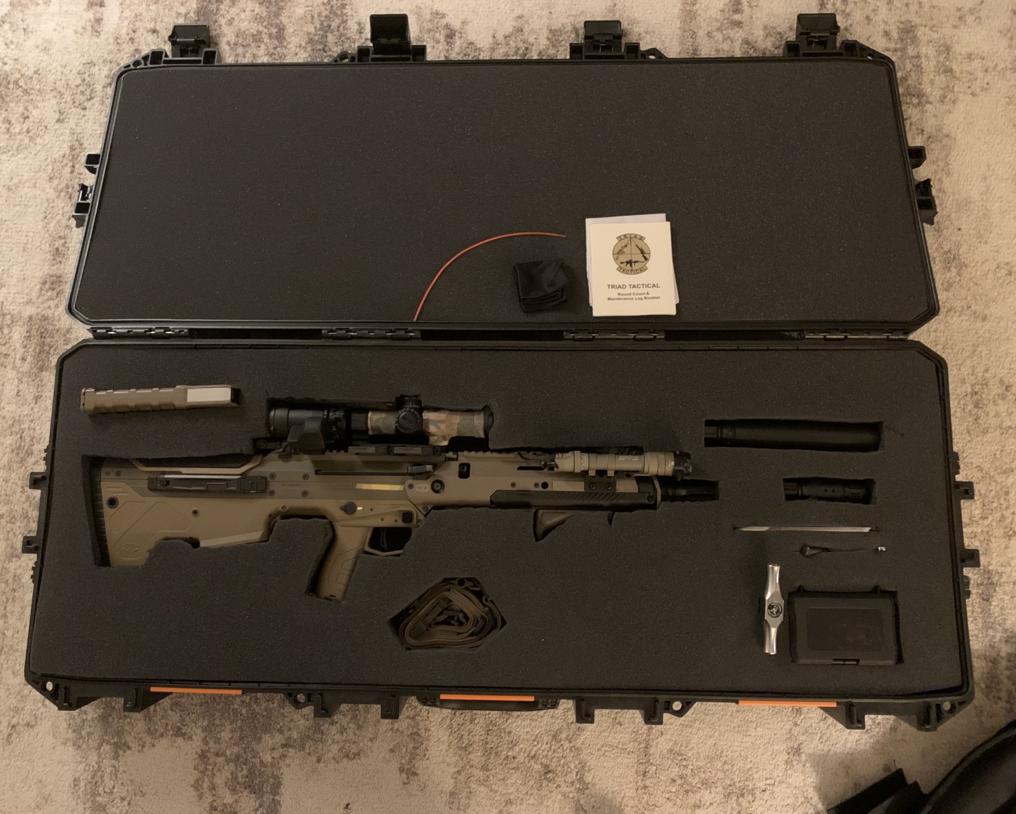

I went for the hard cases for these two as they're my best/most expensive, and more specifically I didn't want the glass getting knocked around on a particularly packed long drive across a half dozen states. I agree for the most part soft cases are generally easier to work with.
ended up going with Pelican's Corrosion Inhibitor and Peli dessicant brick after my local FFL recommended them, since they should be good for two years for that case volume.
Pic of the MDRX in its Vault 730. Leaving some room for future items that will be going in there with it (Glass options, clip-ons)

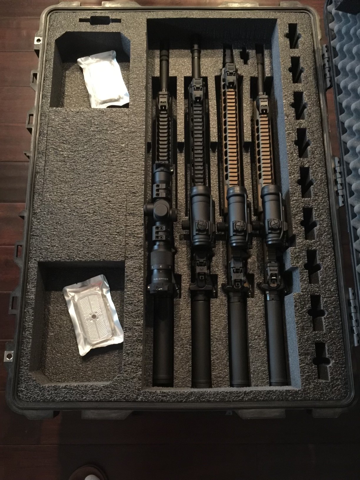

@Hairball that's just hot, which case are you using that has that kind of perfect fit for multiple carbines? :love:

Desiccant packs or canisters work best when they're in the same cut-out as the item that needs to be protected, with enough space around the entire item to allow the moisture to find its way to the desiccant. Tight fitting cut-outs with the desiccant in another tight fitting cut-out away from what you want protected doesn't work very well.
