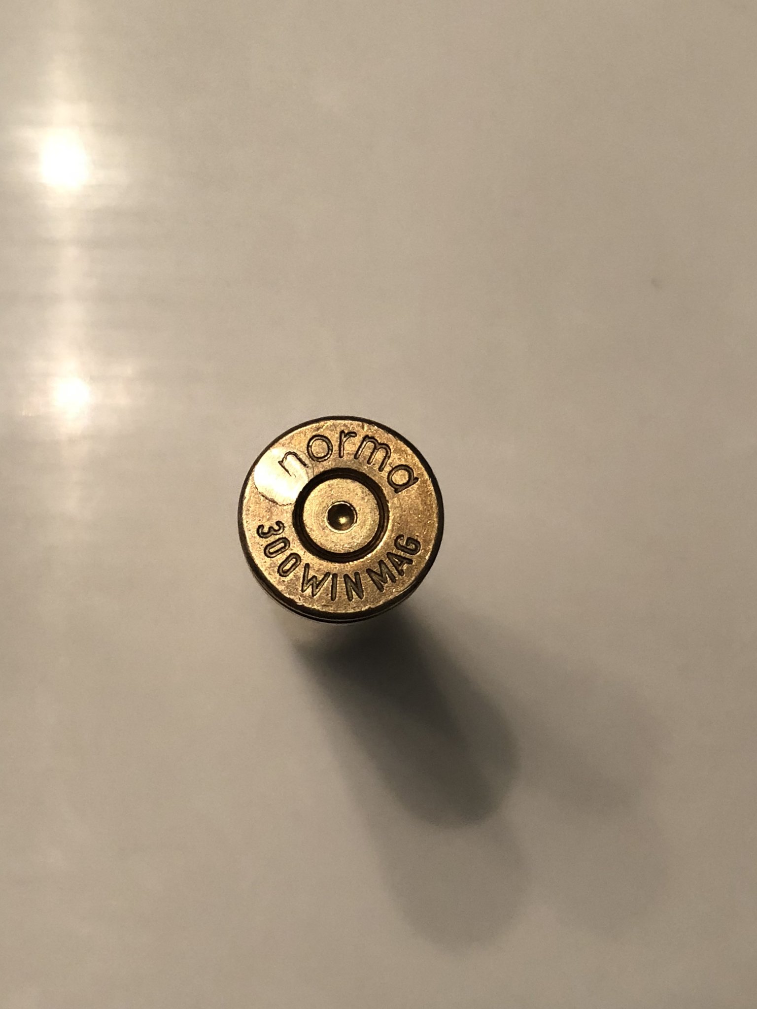

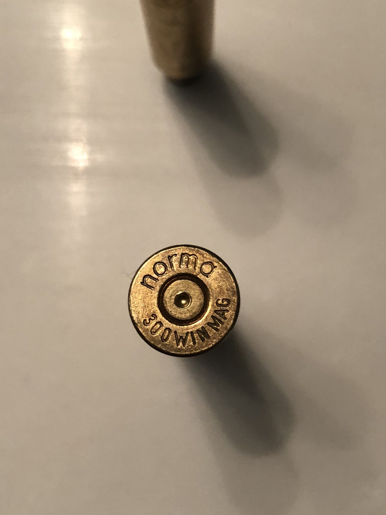

Here’s pics of both case heads

I think its your shoulder. Take a shot casing that was sticky on bolt opening, put it back in the rifle, close the bolt and feel the pressure, then start by bumping back your shoulder .002". Try it in again, see if the bolt stick is gone (I'm betting it will be), if not give it another .002". Some brass stretched more than others.

I noticed you are working with a fairly new barrel. There is a phenomenon where a new barrel picks up speed after a little while. I’m not certain where exactly that point is, but it is probably in the low hundreds.

Expanded heads will cause difficult extraction, but won’t cause extrusion into the ejector hole. If bullets won’t slide freely into fired necks, the case necks are too long or too thick. I believe you said some were +0.0015 after firing. That’s not enough.
