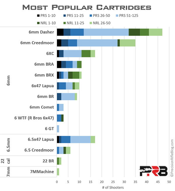

    Bah...thought I had this figured out but maybe not. Here's as much background info as I can give you without a novel. Never shot a rifle with a scope on it my entire life...an M16 at camp Pendleton in boot, and a tommy gun a friend bought a few years back for a few minutes...that's it...been a bowhunter all my life. Own a bunch of pistols but no rifles until recently other than what my dad left me when he passed. I'm 60, just went thru chemo and stem cell transplant, cancer free right now but who knows what the future holds time wise. Only a few things in my bucket list, PRS is one of them. Ordered an MPA PMR Pro initially in 6.5 creedmoor...for two months I tossed around that decision between it and 6mm creedmoor. I read about the advantages of less recoil with the 6mm and seeing hits and making corrections...and you can hunt with it just as well as the 6.5 except Elk really. Factory ammo is available for the 6mm creed...and I eventually want to load my own anyhow as I want the full experience. Is there enough time before I die to learn everything ?...I don't really know but... after seeing this chart...last week I got ahold of Woody at MPA and changed the caliber on my build to 6mm Creedmoor from 6.5 Creedmoor.
    Felt good about it for a couple days figuring the only real compromise was if I wanted to hunt elk but, who says I can only have one gun....maybe I buy another one for really big game like elk and moose...not that I would ever go moose hunting but who knows. Then I read this thread here on the hide and it put me right back on the fence about my caliber choice.
    I wasn't even looking for a thread like this but once I read it...crap...did I make the right call ?...it's not too late to get ahold of Woody and change it back if I do it soon...I feel like I've thought about it so much now that I can't even figure out how to think about it anymore 🤯 ....short barrel life and the additional cost...recoil is actually a good thing in that it helps you lock in the fundamentals better as far as position while shooting...availability of ammo...just looked on Gunbroker...5 pages of ammo for 6mm Creedmoor...25 pages for 6.5....how long does it take to learn how to load your own and get good enough so your stuff is better than factory ?...unknown to me...I have enough money where the extra barrels wont shortchange the ammo and force me to practice less.
    What I want is to bang some steel out to 1200 yards and beyond in windy conditions by using things to factor in the right environmentals and get correct dope, apply it and be successful using it...and I know I got a lot to learn. I also want to get involved with PRS, hunt some stuff with my father-in-law which may include Elk which then may require a different rifle and probably another scope...I don't think with my level of experience I would want to be moving a good scope back and forth on rifles. The scope I just bought is the Razor 4.5-27X56 MRAD with EBR-7C reticle. Super excited to get my first scope...now if I can just feel settled with the caliber choice. What you guys think ?
    Bro. Breathe. Lol. You have wants and that helps people live longer. Reloading is awesome and one of my favorite parts of shooting, its the yin to the yang of shooting. Its calm and quiet, very deliberate and exaclty the same each time. Its my quiet time. Its not magic or wizardry either unless your talking about buying primers right now and im sure you can get some for somebody. Dont let all of the choices lock you up, just go with your gut. Either caliber is fine. :)
    If recoil and spotting impacts/misses is the alure of the 6 Creed, you could just run the 108-123 class 6.5s for PRS and practice.
    Not sure if they have factory offerings in the lower weights, but once you get into loading you'll be fine.
    BC takes a hit when compared to the 140 class 6.5s, but they are still comparable to the 6mms. Most of us can't shoot the difference in BC anyway.
    As you mentioned the 6.5 gives some more versatility for hunting, so just pick a quality bullet and run with it.
