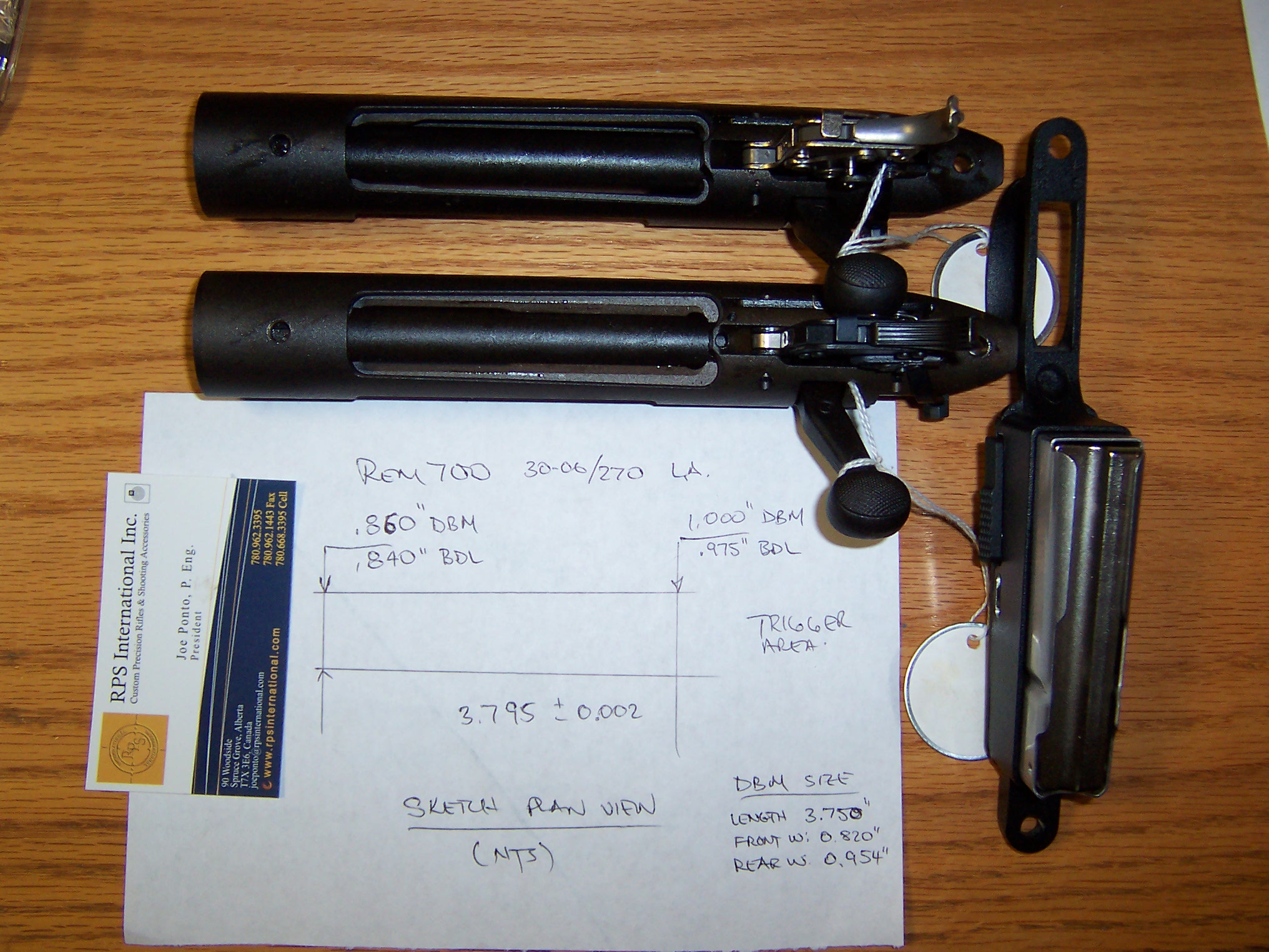

All, thank you for the replies, all very helpful in trying to figure out if my receiver is capable of becoming a good LR rifle. Several upgrades and comments in this thread were already in my mind to some degree or another but I need a answer about receiver vs chassis fitment and I think I'll be OK. I'll go ahead and snap some pictures of the receiver and post them up here just to be sure. I recall doing research earlier, when considering selling the pencil barrel rifle and buying a factory varmint barrel R700, that the DBM can not fit into a non DBM receiver, so there much be additional material removed from the interior cut magazine cutout. Hopefully the exterior dimensions are still the same and only the floor plate is different. I would presume the magazine retention on a AICS or other chassis comes from the chassis itself and I won't have to worry about a "sloppy" feeling magazine due to the extra space inside this DM receiver?
Google image search gave me this picture, was the only one I had luck with, I'll still take some pictures when I can this week.

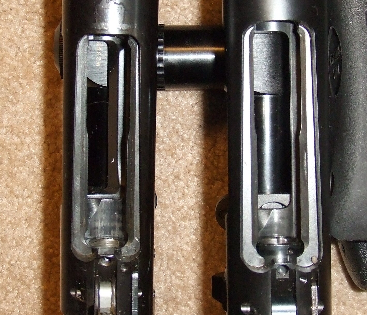

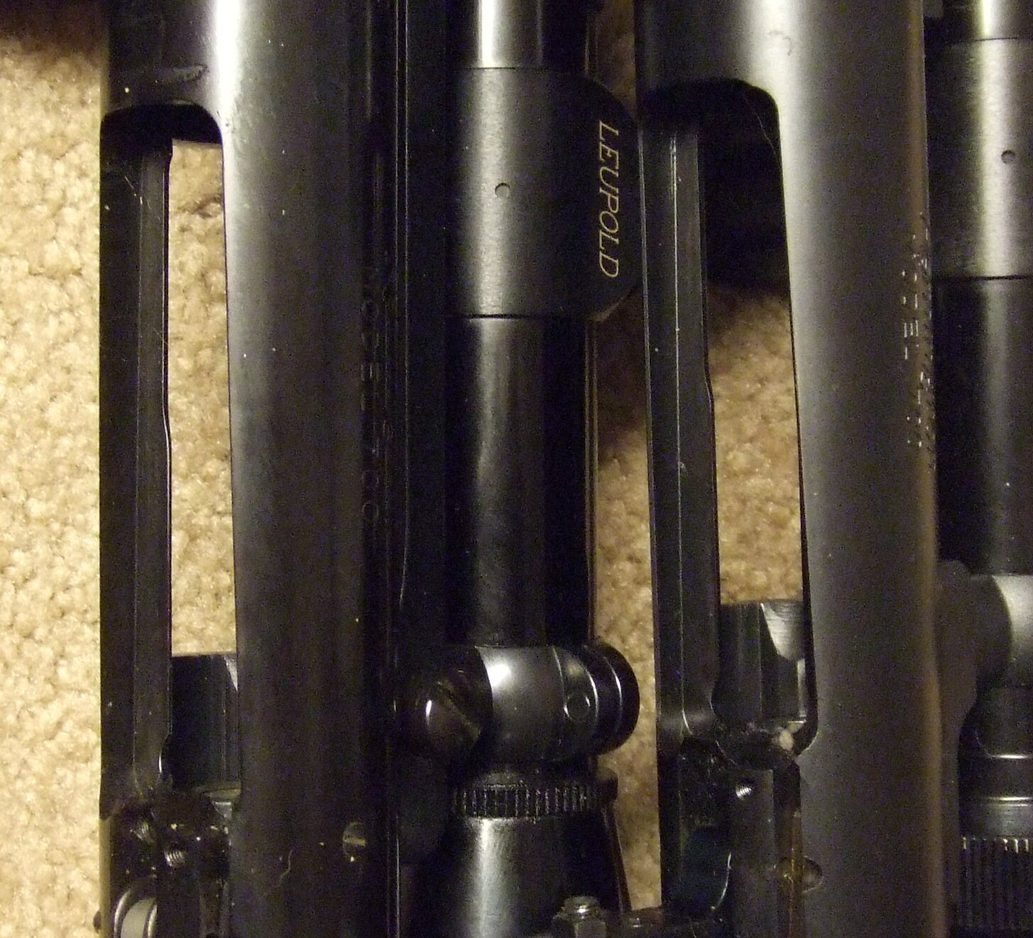

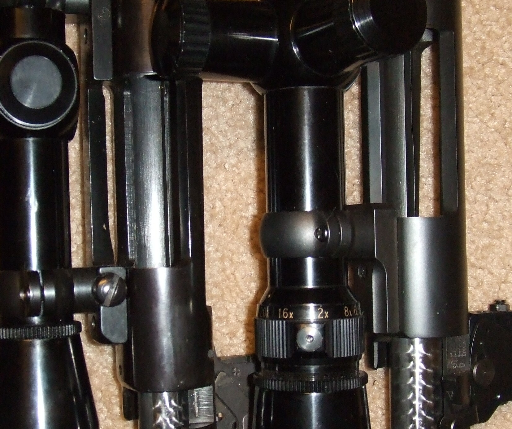

For what it is worth, here is one of my posts from a thread called Remington 700 Interchangeability:
"Well, it seems we have some differing opinions here, so I just now went up to my "gun /reloading room" (my wife calls it the JUNK ROOM!!) and took a Remmy 700 7mm-08 barreled action out of the stock (that gun is a CDL) and sat there with the barreled action from the DM .308 and the 7mm-08 right there side by side and compared them....I couldn't see ANY differences in the machining between the two of them...all rails, slots and other machined features seemed to be identical, as did everything I could see. OK...so they look the same....I then took the .308 (was in the DM setup) and put it into the 7mm-08 stock with all the stuff...floorplate, magazine "box" and everything from the 7mm-08 and put some cartridges in through the action. I then jacked them one by one through the action/chamber just as one normally would when firing a round and then reloading from the magazine. It worked perfectly...no hitches, glitches, jams or hesitations. Having compared the two actions very closely and then done this test, I now believe that the actions are the same and the only difference between a rifle with a floor plate, magazine box like the majority of 700s and the DM version is only the magazine and the stock. I guess maybe I answered my own question.....
Edit: I just went up and took some pictures...the action on the left in all of the pictures is off of the DM equipped rifle and the one on the right in all pictures is the 7mm-08 that had the usual hinged floor plate and magazine between the floor plate and the bottom of the action. I hope the pictures show enough detail so you all can see any differences...the pics were taken from the bottom right, straight into the bottom and then kind of looking into/through the loading/ejection port. In one picture you CAN see the bottom of the rear scope mount on the 7mm-08, so don't let that fool you. Just for further clarification, the one that is from the DM rifle has a one piece base and the two piece base outfit is the 7mm-08 that is from the "typical" two piece hinged bottom metal gun.
Anyone got any specific experiences or data (maybe from Remington) that would disprove my current findings? I'd like to hear from you!!"
FWIW, I'd say that you DID NOT screw up and buy the wrong rifle if you are happy with the caliber/barrel length/barrel weight, though that is easily enough changed. I haven't explored this any further, but I'd guess that if you want a DBM rifle, it won't be too hard to get your action into a setup that will work for you.
