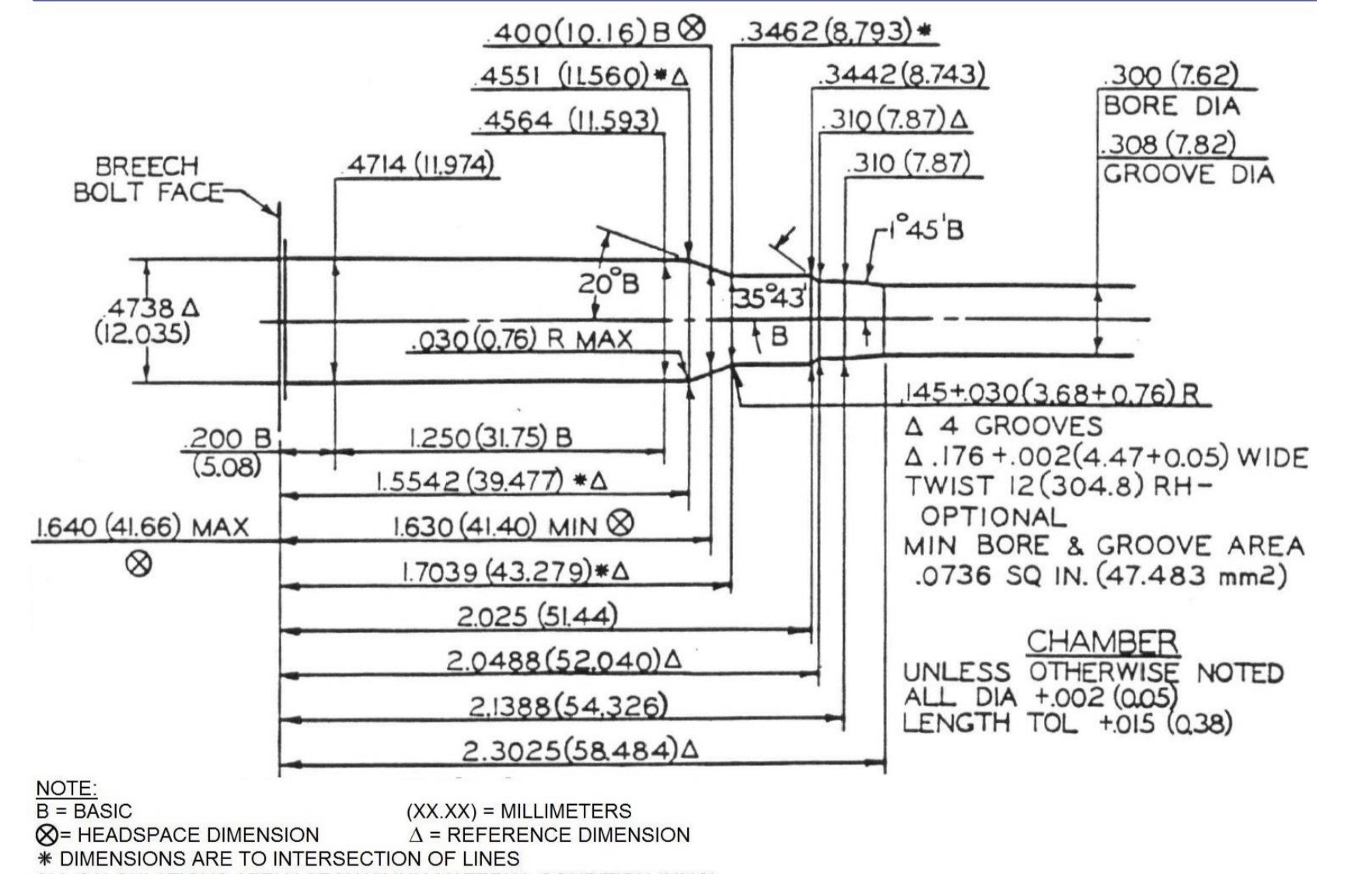

Or a tight chamber. Chamber spec is .4714”

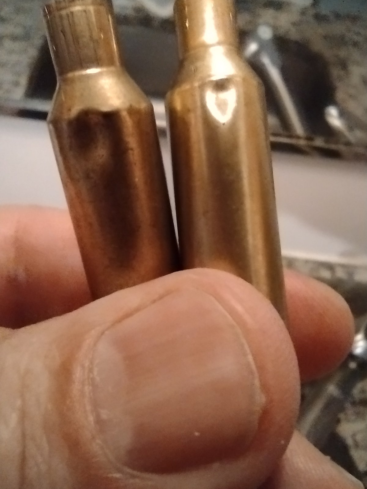

If I put the sizing die all the way down to the shell holder, it creases the casing up by the shoulder. I have to have some space.
  • Wow
Reactions: Ronin22 and lash

No. And it appears everyone to comment so far missed the bit about backing off, some are thinking you've turned in another 1/2 turn.
But the advice about turning in 1/8 turn at a time is a Fudd method that almost guarantees you too much headspace - 1/8 turn is good for .009" change in headspace. That's way too much.
OP, you'd be doing yourself a favor to understand how to measure shoulder bump. That'll tell you right away why your cases are sticking. Most likely you'll discover your sized brass shoulders are growing forward by .001-.002"; that happens when the die is sizing the OD down but not pushing them back.

Also, as already mentioned, the dents you are getting look a Lot like they were caused by too much lubricant.
