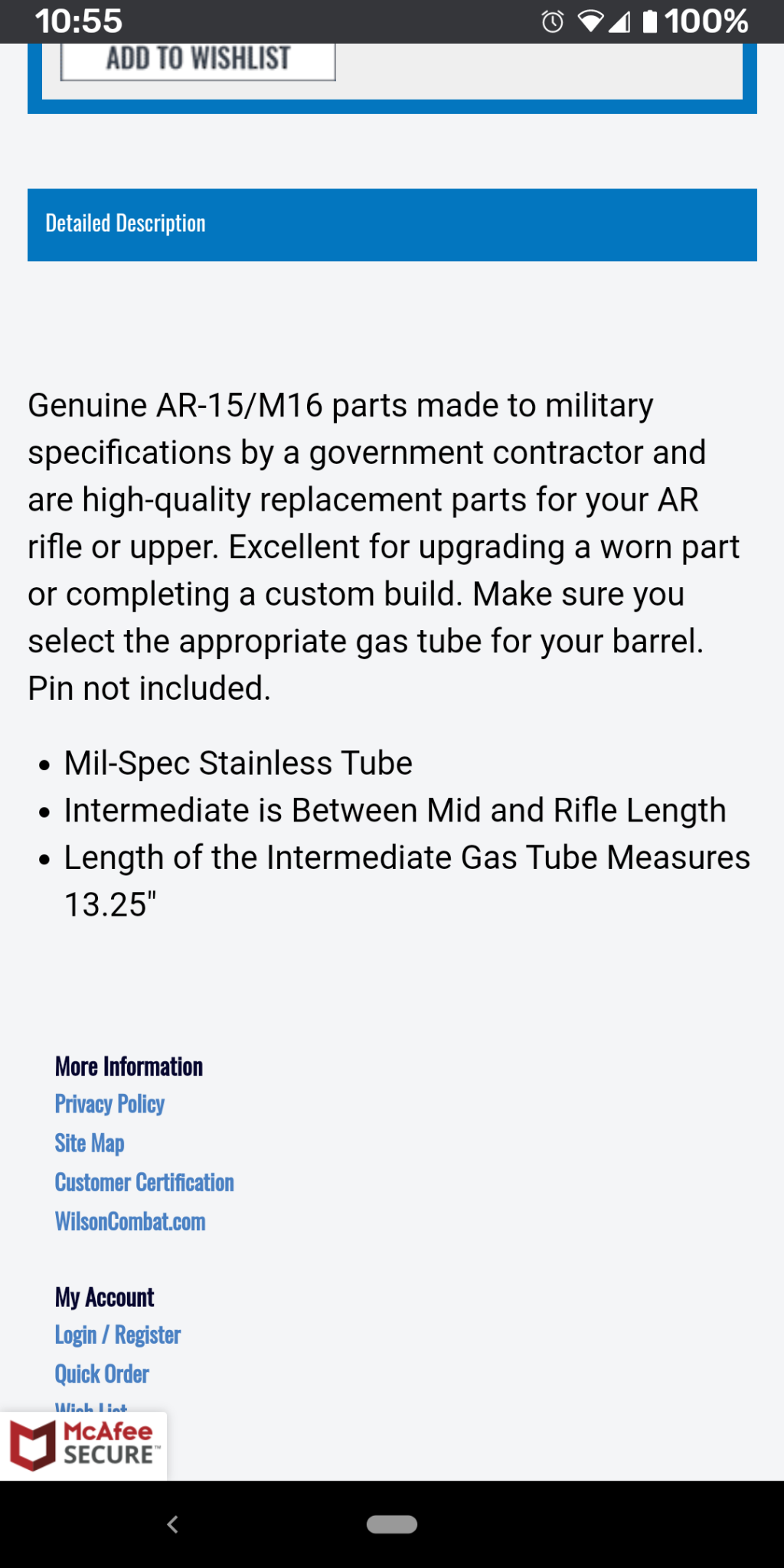

I was just reading that before you sent this! But definitely thank you to you for responding. Maybe you can answer this though. What is the length of an intermediate gas system compared to a mid length. I’m trying to figure out if my Knights armament Ras MK12 Rail will fit over my gas system. Neither have shipped yet.
An intermediate tube is between a mid length and rifle length and is 13.25 inches long.
