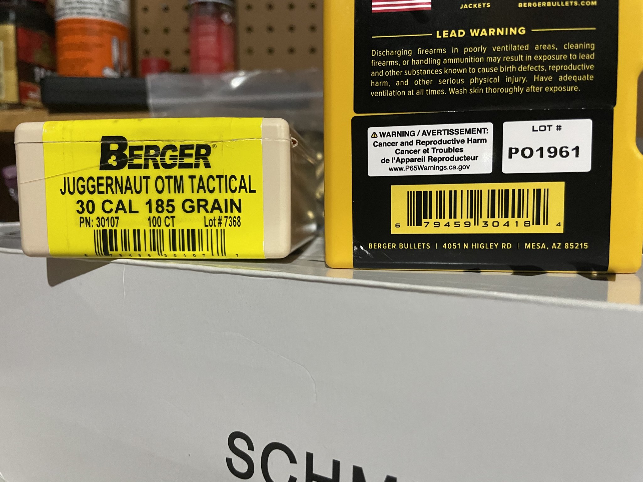

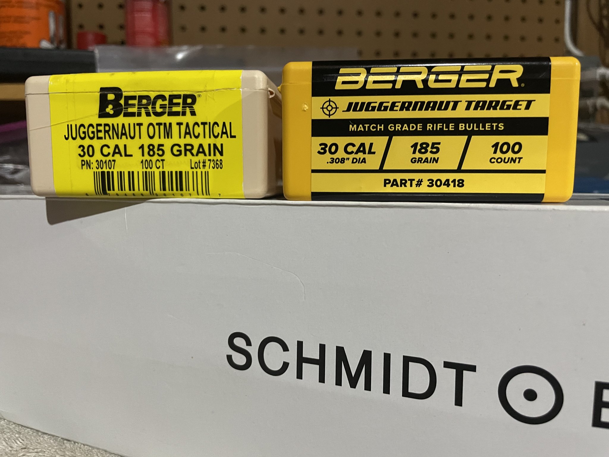

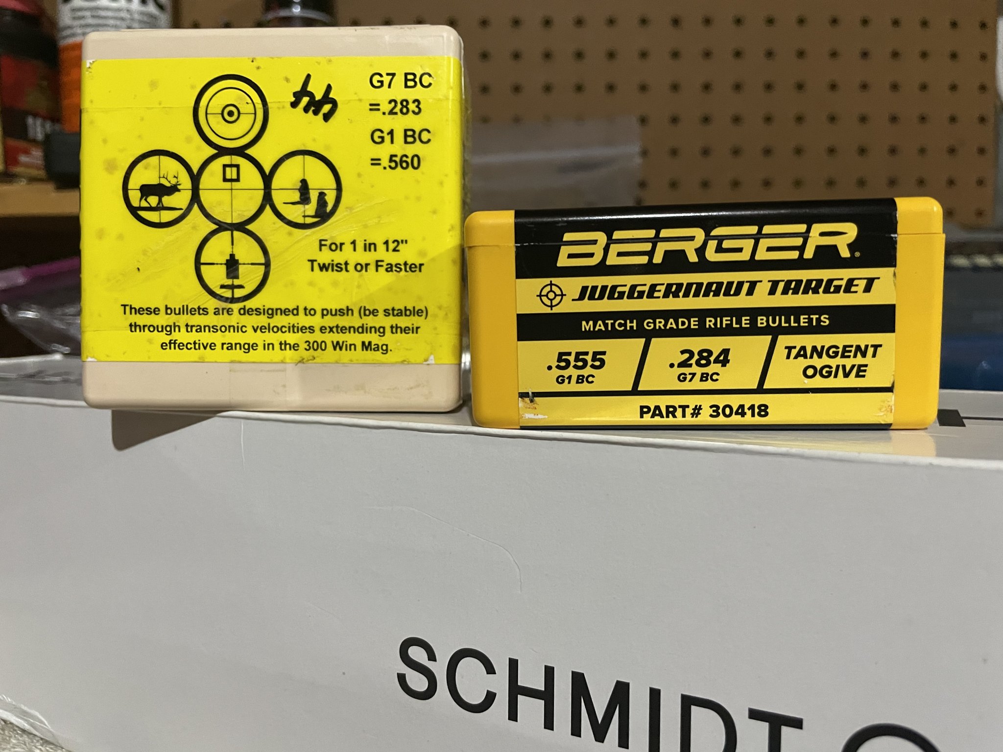

Everything I’ve read from 2012 to 2013 era says the same thing. I’m unsure how old the tactical are but the box is a different color and the BC is different. Not sure how they can be the same. Hoping to get further information. I’m gonna shoot them both tomorrow and see if there’s a difference in accuracy/POI, which I suspect there won’t much as they’re so similar. *Ogive is 0.675 and 0.664 Tactical and Target respectively.
*edited for correction of Ogives.
