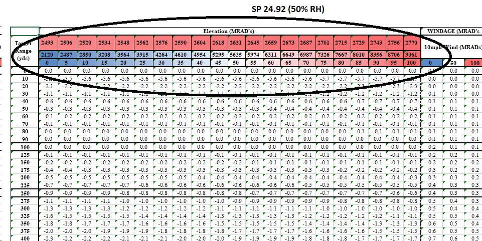

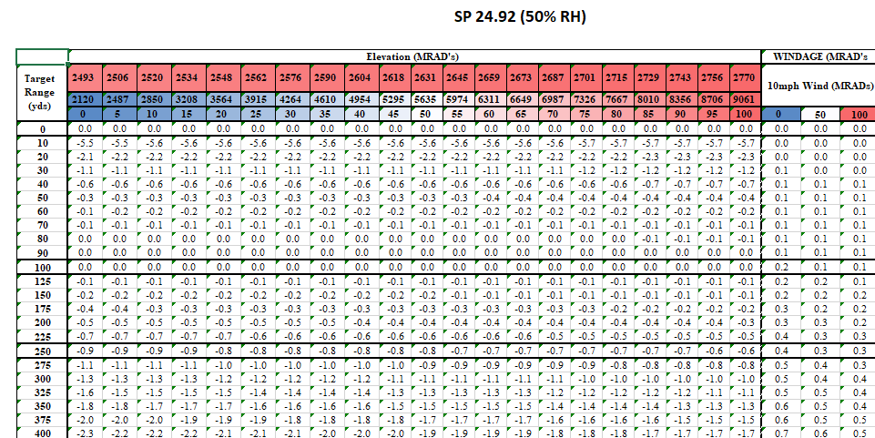

Here is how i set up my field expedient drop sheets:
i get my initial pressure reading and shoose the sheet closest to that pressure, then i find the current temp column and go down to find my range and get my drop. as temp changes i enter the appropriate temp column, but i rarely ever have to change sheets due to a pressure change. The circled data above is MV, DA, Temp respectively.
