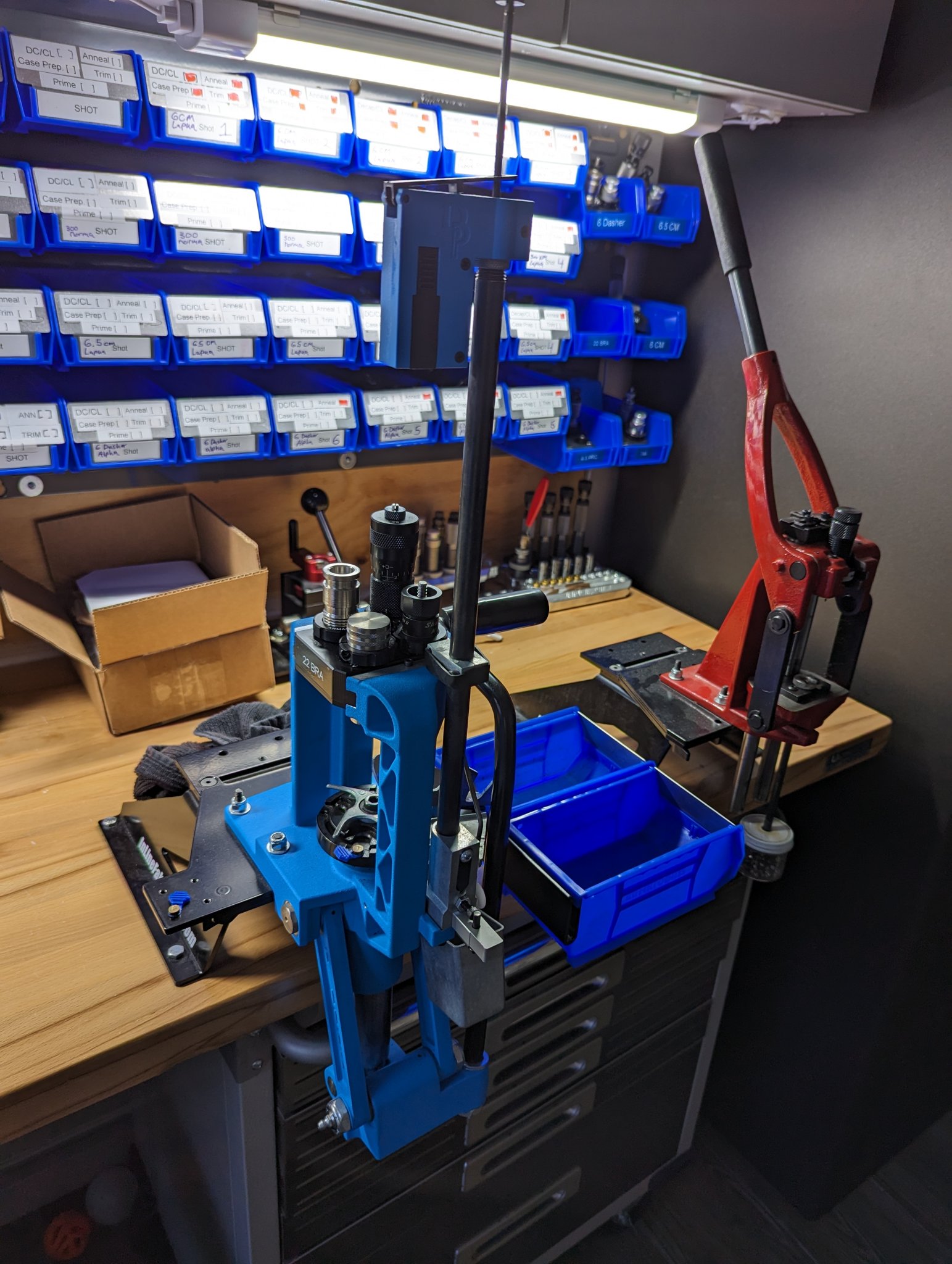

    Turbo bearing for for sure, UFO light, and A419 funnel are a must. I’m using both Whidden and armonov floating tools heads. Whidden is more convenient for taking on and off, but I’m too lazy to measure if either one makes a difference.
    I moved to a flush mount quick change plate from inline fab on this last house move. I like it so far.
    It would be nice to keep a single stage set up for decapping, if just to keep some of the crap off the 550, and the 550 spent primer catcher box thingee can be sticky/finnicky.
    I like the UFO light ring more than the singles that you have to pop in the toolhead. Better light, less faff. I've moved on from the clamp in toolheads. I have a couple whidden floating ones, but I honestly dont see a difference from the non-floated. YMMV.
    Also all inline fab gear is a must IMO. Quick change mount, roller handle, and bin system are super nice. I also got a bullet try on eBay for 20 bucks, but if you have a 3D printer I’m sure you can make one.

    Another vote for the UFO light from me. Spare toolheads, even plain Dillon ones are always handy.
    The inline fabrication mounts are great. One tip for the finished round chute is put a wide rubber band across the front over the indent for the handle. Keeps top heavy stubby rounds like 6.5 Grendel or other BR/PPC from falling out of the chute onto the ground.
    The primer catch cup can stand to be a bit taller, I taped a cut up primer box sleeve around it to reduce spillage when I still used it.

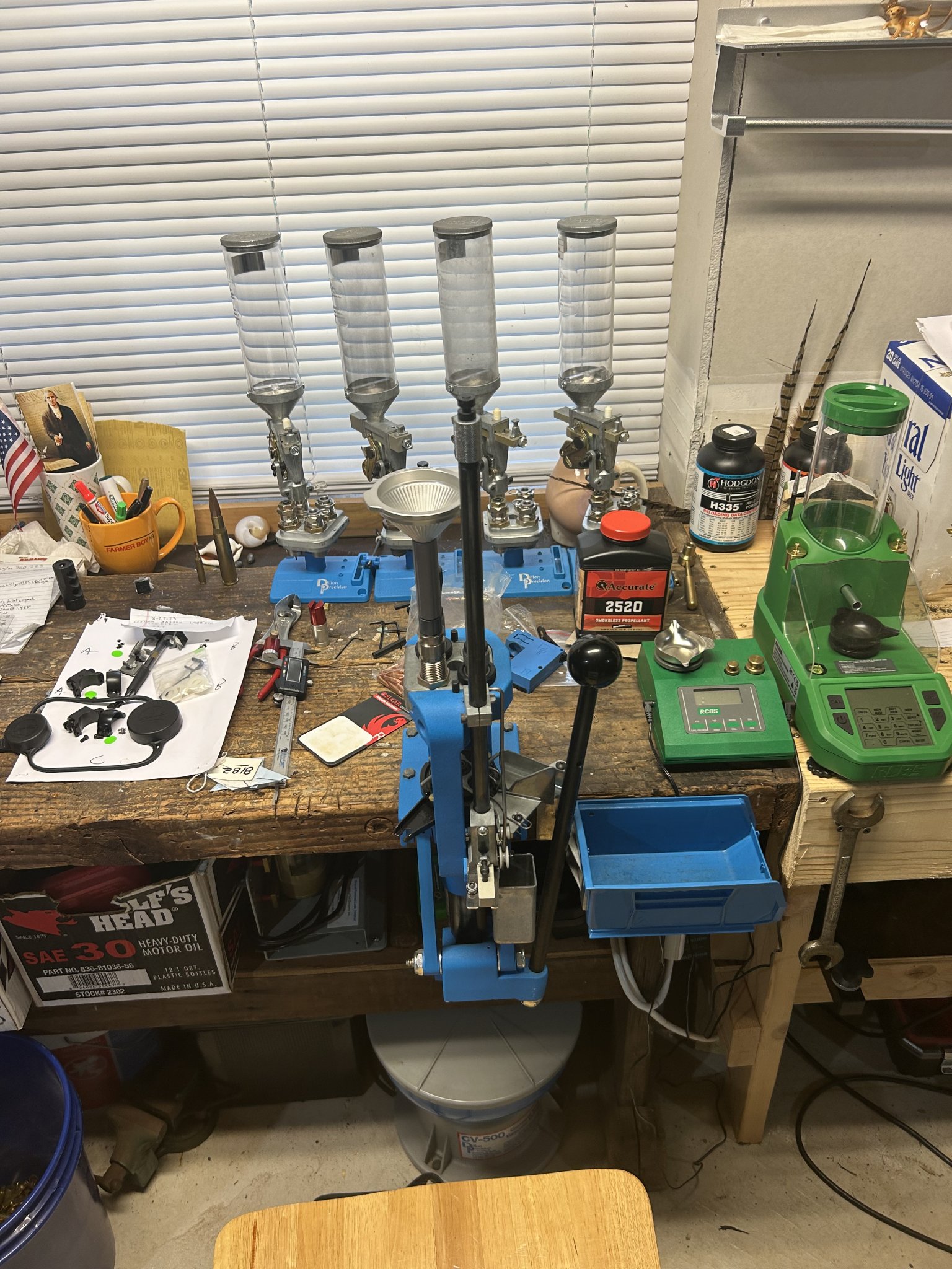

    I only have 6' linear space to work with and here's how I setup my 550. Armanov heads; I haven't measured if they make better ammo but the concept is sound. Inline Fab stuff; mid-height quick change mount, roller handle, bin mount & chute, bin barriers, locating pin tabs.
    I don't try to change the primer system between small and large primers, I keep it setup only with SRP's. Trying to change between primers for different cartridges is too impractical with the Dillon primer system.
    Other than that for setup my Autotrickler is off to the left so I can take a charge out, drop it in the 550, place a bullet and replace the cup in the trickler.

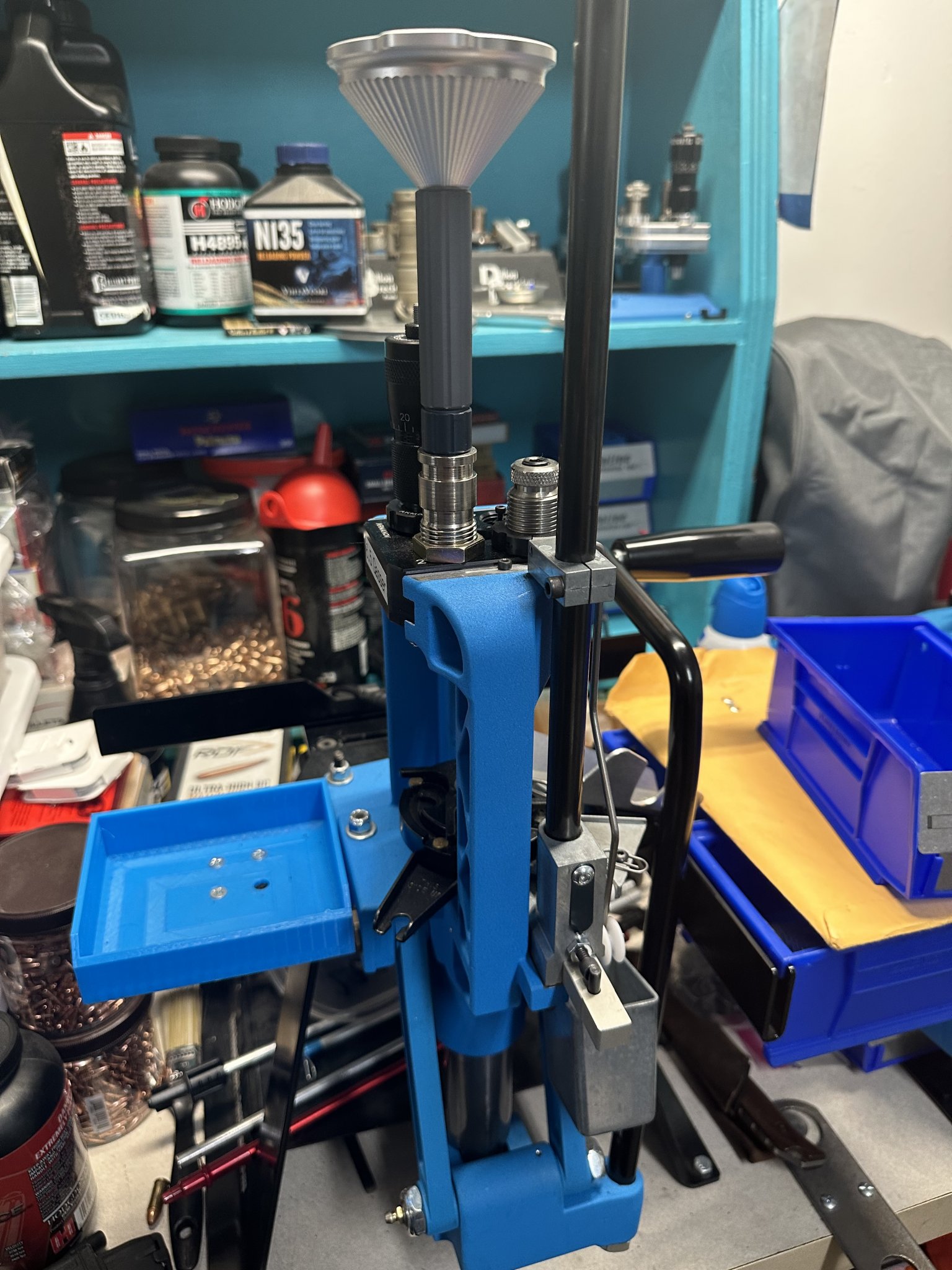

    I’m throwing the powder off press with a ATIP setup. Using the A419 funnel. Look at my picture above. That’s setup for 6.5 creed. You’ll need the dillon powder through die and the dillon powder funnel that’s specific for the caliber you’re loading.
    Here’s a good video explaining how to load. I did a couple things differently, but the gist is there.
    Oh ok. So, what kind of seating die is that? I watched that video earlier today but will watch it again. The dies and the order of them is my main struggle with what to do where and in what order. Is that a powder check die you have in your picture ?
    That seating die is a forester micrometer. I also have a couple of tool heads with Whidden seating does. I don’t have a powder check die. Station 1- mandrel, station 2- powder through die/charge, station 3- seating, station 4- empty.

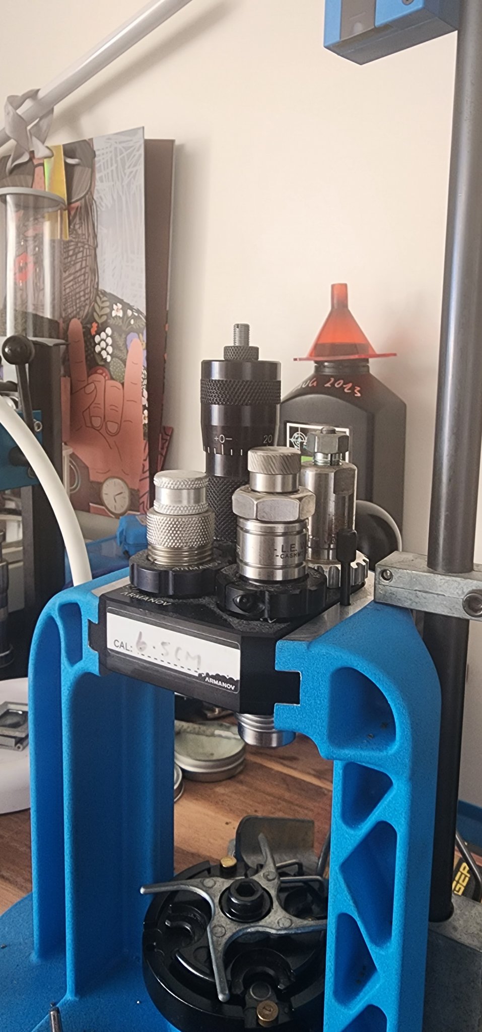

    I have very limited space (a bench on a tool chest in the study of an apartment) and only use the 550 for PRS and hunting ammo. My process is:
    Anneal straight off the range. If the brass is mangy, I'll tumble it with the primers in. I used to de-prime first, but found no difference in accuracy or consistency (single digit ES's on 10 shot groups).
    Cases then go on the 550. Station 1 De-prime. Station 2 Wilson full length die with bushing. Station 3 Expander Mandrel to set neck tension.
    Rounds come off the press. Henderson to trim, chamfer de-burr. Auto-trickler to fill with powder.
    Back on the press. Forster micrometer seating die.
    I use the Armanov heads and have a 550 for LR and SR primers.
    I also use inline dies and an arbor press for seating depth during load development.
    Runout with this setup is as low as I get using inline dies. Neck tension is also as consistent as I was getting when I spent hours messing around with necks.
    I load this way for .223, .223AI, 6.5 CM, 30-06 and 300 PRC. Occasionally I'll skip seating on the 550 and just use the Arbor press. Brass is ADI for .223, Alpha or Lapua.

    I have a 550 that I use for all my match ammo in 6.5 Creed and Dasher. I 3d printed a funnel that sits on top of the powder die and drop powder by hand off the FX120. My first die sizes/deprimes, second is mandrel, third is powder and fourth is seating.

    I have four flush mount Inline Fab plates on my bench. One has the Dillon and another the Zero. The other two will have the CPS or Henderson or nothing.
    I also have the Dillon toolhead holders since I have many, many feet of their rail system on the wall.
    I modified the Dillon toolheads with a kit to hold them tight in the Dillon and then I drilled holes in the toolhead/die ring and use pins like the Whidden toolheads. I can't say that did anything for improving my loads over just the straight Dillon floating toolhead. I simply spent a lot of time doing it and probably wouldn't do it again. I'd just run the Dillon stock in regard to toolheads.

    Good thread, here’s my set up for precision .223. I also load for 4 pistol cartridges that I quick change to with a powder funnel throw bar set up.
    1. I anneal on an annealeeze.
    2. I dry tumble in either walnut or corn cob.
    3. I lube the brass with the lanolin/alcohol spray.
    4. Full length resize/ deprime on first stage in Redding full length sizing die with neck bushings. However, I just keep feeding them in and spinning the turret to let them land in the loaded cartridge tray so I’m not putting in and taking out every piece, just putting them in.
    5. I trim/chamfer/deburr on a giraud case trimmer.
    6. I put the cases in my ultrasonic cleaner out in the shop to take the lube off them. Still haven’t found the recipe for solution I like, might try boretech next, but I only really care about getting the lube off.
    7. I blow the cases out with compressed air, and I’ll throw them in the oven at 150 for a few minutes if I want to load right away, but just let them dry normally if not.
    8. I prime on station 1.
    9. spin to station 2 and load charges via RCBS chargemaster through area 419 funnel.
    10. spin to station 3 to seat on Redding micrometer seating die.
    I just keep the turret full when loading known charges, and just keep advancing. Just have to be mindful to not size brass which is easy as long as you get used to it.
    Added the primer bearing plate thing to mine and haven’t had issues with the priming arm jamming up since. I’ll have to grab the ufo light and turbo bearing as mentioned in this thread!
    Excuse the mess on the bench.
    The bench was my great grandfathers that he build after came over from Germany. My grand pop told me that he (his dad) always wanted a work bench, so when they finally got to America, he built this.
