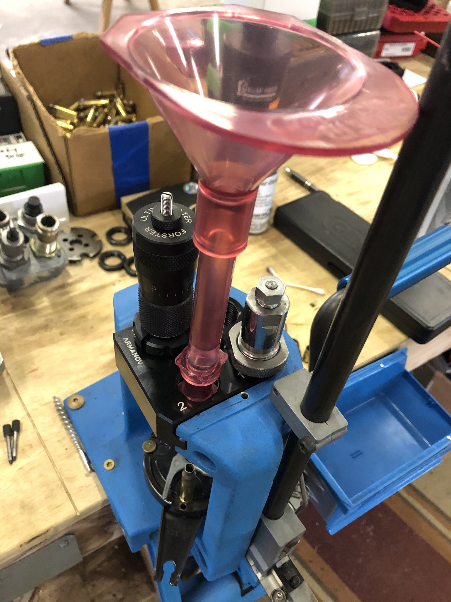

So despite already owning the 1050, I don't think it's the right tool for this job. I'm determined to use the 550. The list of stuff is below:
Dillon 550 with the fancy mount and extra bins
Whidden tool heads
Whidden 6.5 dies
Redding Valk die
21st Century expanders
Lee universal decap die
Chargemaster
419 powder funnel and adapter to use Dillon powder die
Forster trimmer

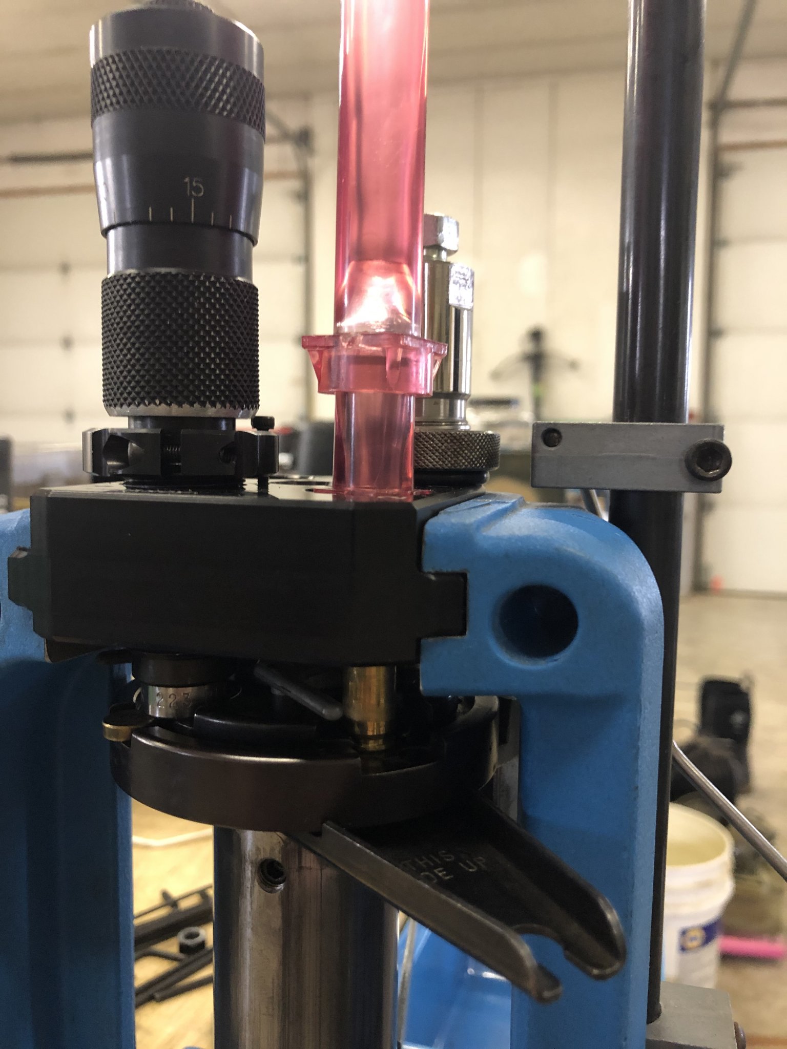

4.) Toolhead #2 - Mandrel - powder - Seat bullet. For powder I use a MTM drop tube and funnel. It fits perfectly in the die hole (shown below). I'm still playing around with using my mandrel twice. this next batch, I'm going to resize then immediately mandrel with a turning mandrel (.002" under). Then opposite my seating die, I'm going to run an expander mandrel (.001" under). Hoping this works the brass less in one motion, and results in better neck tension.
That being said, I'm getting great consistency seating bullets for my 6.5cm on the 550. having the mandrel opposite the bullet seater seems to help. It also helps the physical act of working the press consistently. Theres less slop and play since the mandrel creates a little friction.

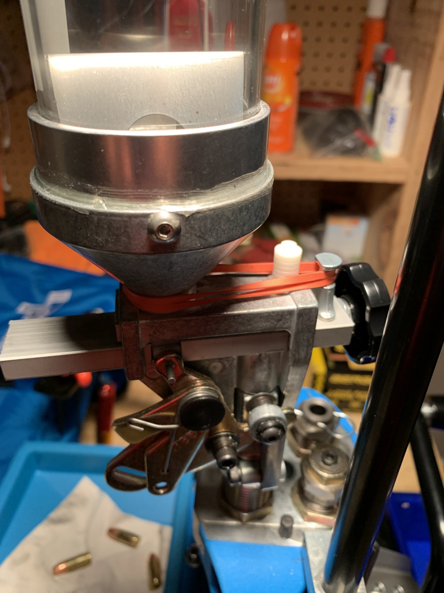

I've had a hell of a time getting my dillon powder throw to be very accurate. It has been all over the place, even with 6.5 staball which literally drops perfect every time in my rcbs powder dump. Anyone have any suggestions? I usually use varget, but practice ammo I powder dump staball.

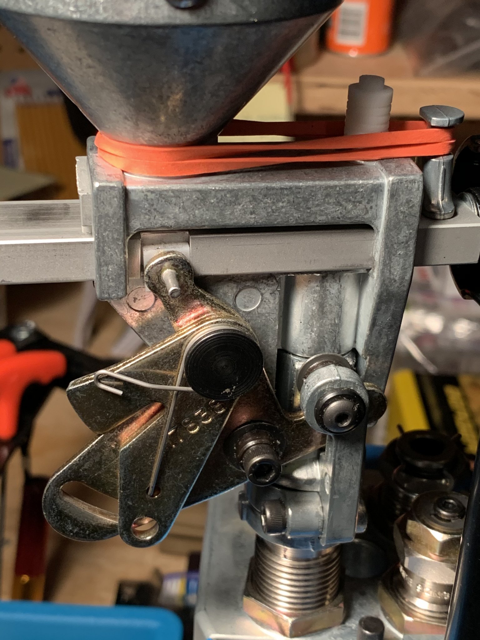

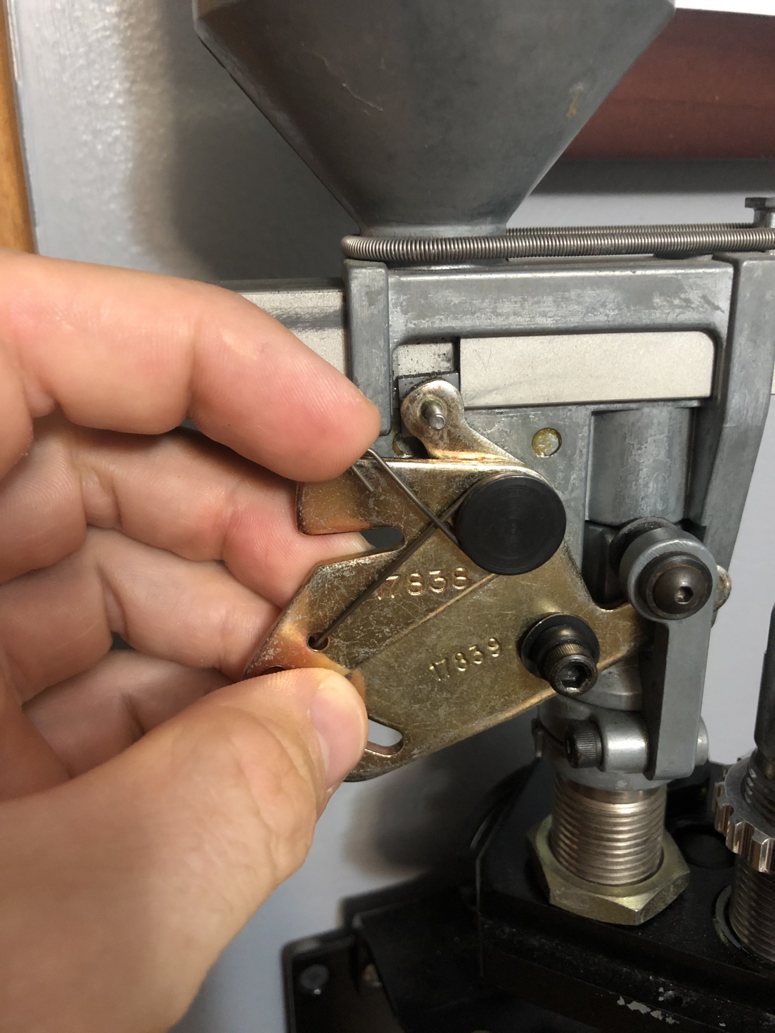

Ive heard of a couple things for the powder measure:
1.) Put a powder baffle in the powder hopper
2.) take apart everything that’s metal and put it in your tumbler with corn cob media and polish for half a day.
3.) If you’re using the failsafe Rod thing, try it without. I use two of the old long springs wrapped around it. If your failsafe Rod isn’t Set up just right, you’ll get a knock half the time and it seems to settle the powder for some charge and not for others, creating a bad variance.
I don’t have any issue with mine. It throws H335 to +/-0.1gr... at least every time I’ve measured it.

like @Gustav7 said get rid of the fail safe rod....and dry graphite is the powder throws best friend

Exact same setup I use, except I add the Redding Instant Indicator at stage 4.

you guys should check out these tool heads they lock in tight and don’t have any play they give you the option to free float a die in them I don’t I lock them down tight but you can if you want and the quality of armanov is second to none I’ve got about every up grade they have and am very pleased for the 650/750 stuff. Their euro site has a little more on it as far as upgrades but you pay more do to $ exchange. Ussually get it in less than 2 weeks from euro. It’s really good stuff though makes the machine run smooth and Some of the upgrades like primer shut off and case feed shut off are nice.

I started a thread a while back on this. I still need to run the tests with the Armanov toolheads vs. the regular Dillon toolheads. Unfortunately its a bit of a time consuming process. Switching the exact same die set ups over to two different toolheads, and then running a batch for each lol..
I'll get to it at some point and I'll update the original thread I started when I do. SO FAR, seating depth consistency is great, and appears to be more consistent than my old process. When I do the testing side by side, I may get a more representative experience.

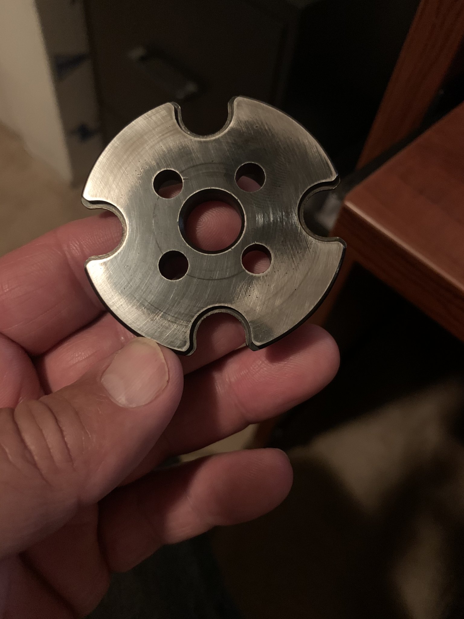

when i first got my 550 a few months ago first thing i noticed was the the shell plate would bind unless i left it pretty loose and this was causing some primers to be just a bit proud which was causing a few FTF with 9mm.
i did a little research and found a lot of complaints about the shell plate binding and most were the same thing as mine where it was only binding on one or two of outer areas where the cases go into the shell plate.
so im guessing these shell plates are punched out?? so i took my 9mm shell plate and some 800 grit wet/dry sand paper on a piece of glass and started sanding down the bottom side of the shell plate....i wish ida taken more pics but when i started the sand paper was barely hitting the outer edges so i kept going until all the black was just about gone then continued using 1500 grit then finished with 2500 grit.
i bought the bearing kit for the thumb wheel and i can now tighten the retaining bolt down to where the shell plate is hard to turn then back it off just a tiny bit tighten the set screw and the shell plate runs smooth with no slop.
i did the same to the 308 shell plate and the pic kinda gives you an idea of what im talking about.....
i did the same to the 308 shell plate and the pic kinda gives you an idea of what im talking about.....View attachment 7417330

like @Gustav7 said get rid of the fail safe rod....and dry graphite is the powder throws best friend View attachment 7417137
I think my first step for accurizing my 550B should be the powder measure /thrower. I suspect bullet and primer seating depth is important, but less important than a consistent powder charge.
The actuating rod does get hinky at times. Considering the rubber band trick / dry graphite thing.

Can I see a picture of how you guys are removing the fail safe rod and bolting the links together? I keep reading this but I cant picture it. I'll probably pull and polish my hoppers this week.
Does anyone know if you can add the auto prime system to a Dillon bl550. After reading the article on modifying a Dillon 550 I'm interested in getting one and trying it out running full progressive without a powder drop. Buying a bl550 would be a lot cheaper if you can add a auto priming attachment to it
Yes. It's about $125 for the Auto prime and the primer warning system together.
Reactions: Gustav7
If you’re planning on polishing the actual hopper, I wouldn’t. If you just used the word hopper to mean your actual powder drop, then sounds good lol. You want the powder bar, housing, and drop tube polished in the inside.
For the linkage, I just undid the little clip spring. Picture to show...

Related to the fail safe mod. Powder Measures made after 2000 do not have the return springs.
The Dillon part info is #14036 Powder Bar Return Spring, $3.99
Handy to have at least one so you can try to match something up at a hardware store.
I'll give you a secret. If you pull the ram up and look on the left side of it below where the shell plate goes there's a set screw. You set tension how you want it above then use the set screw to retain the bolt in place without having to crank it down.

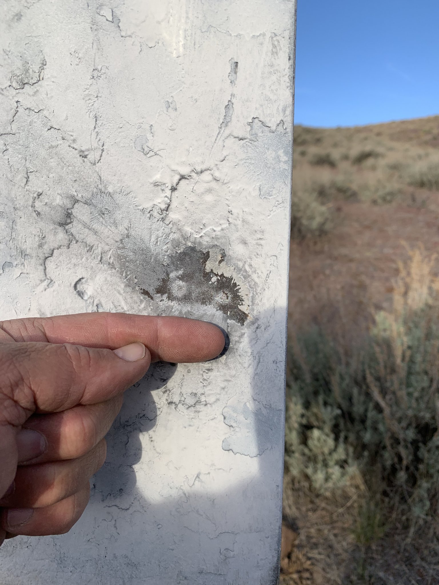

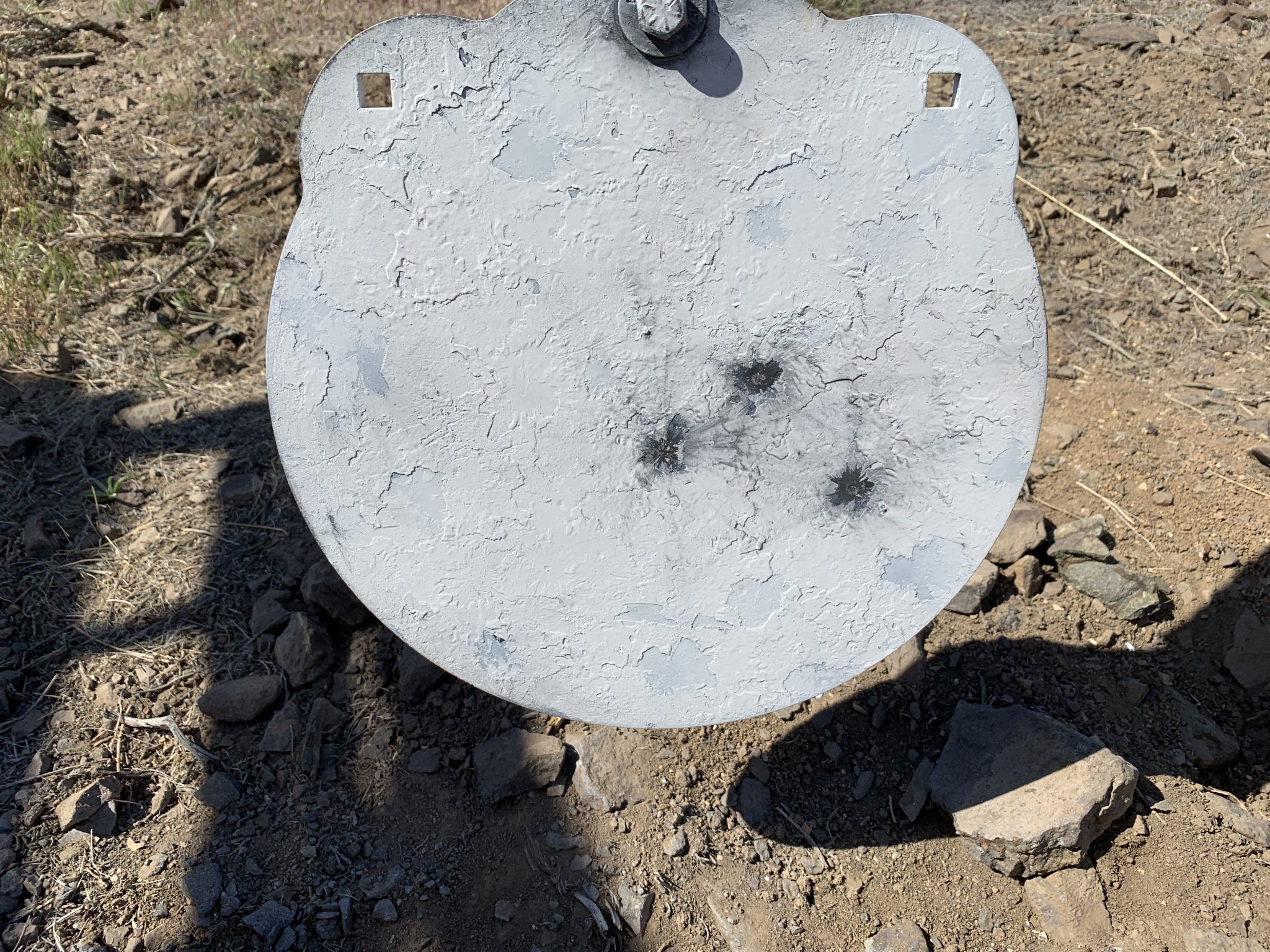

I made it to the range to Chrono the first loads.
Process:
New Lapua SP brass
Primed on the 550 with a forward stroke, rotate case, and press again to be sure. Station 1, CCI400 (skipped sizing)
Mandrel in station 2 to ensure consistent neck tension.
Pulled case, charged with chargemaster and 419 funnel, replaced case. More on this later. 40.5 grns H4350
Seat bullet in station 3. Berger 144 Hybrid
Data: All 5 shots each. I have more data on the factory ammo, but for comparison sake left the 5 round data.
0.020" off lands
Vavg: 2832
ES: 25
SD: 9.8
0.060" off lands
Vavg: 2819
ES: 18
SD: 6.7
Berger 144 Factory
Vavg: 2869
ES: 16
SD: 6.8
Groups sucked, but so did my controls. .75-1 MOA bad. I could have been having a bad day, but I'm also new to suppressed shooting vs braked, and the recoil impulse is very different. It's also been a very long time since I cleaned my rifle, over a case of ammo. So I'll clean it and try again along with some variable charge weight testing.
So what did I learn?
OAL variation was minimal. Within 0.002".
Modifying the whidden toolhead to allow me to seat in station 4 took all of 10 minutes, 8 if which were searching for my transfer punches.
Using the mandrel is awesome, but pulling cases to charge defeats the purpose of using a progressive press. I'll have to spend time setting up my dies again, but it's fixed now. The plan is size in station 1, expand 2, powder 3, seat 4.
ES/SD numbers were quite good, definitely good enough. If I can learn to group from a bench again, I think this will work out okay.
i do the same as @Gustav7 but i just use a rubber band for the return spring.View attachment 7418013

i know all about the set screw thanks.
I wish my LNL AP had that feature. It's really fantastic IMO.
The set screw is great to have, but its not the fix for some of the shellplate wobble. Unfortunately the shellplate is not perfect on the bottom and can have rough spots, high/low spots, etc. So it creates an imbalanced plate when you lock it down. Doing what @47guy did with his shellplate, and I've done the same, creates a much smoother bottom to the shellplate and makes it more even and square, noticeable on the picture he put up where the outsides honed first.
When I did it to mine, it made the 1st station case wobble almost disappear. It also made the rotation of the shellplate smoother. You always get slightly more wobble on the 3rd position as this is where the detent ball is. You can also cut the spring down to reduce this as well, but sanding and honing the shellplate helps tremendously. Also using a good lube on the detent ball and shellplate screw helps too.
