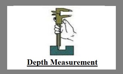

Can you measure them? Measure the depth of the primer cup in between the anvils, measure the depth including the anvil, subtract those to see how much crush of seating the anvil is and then take the depth measurement of your calipers to see how deep the pocket is in the case.
