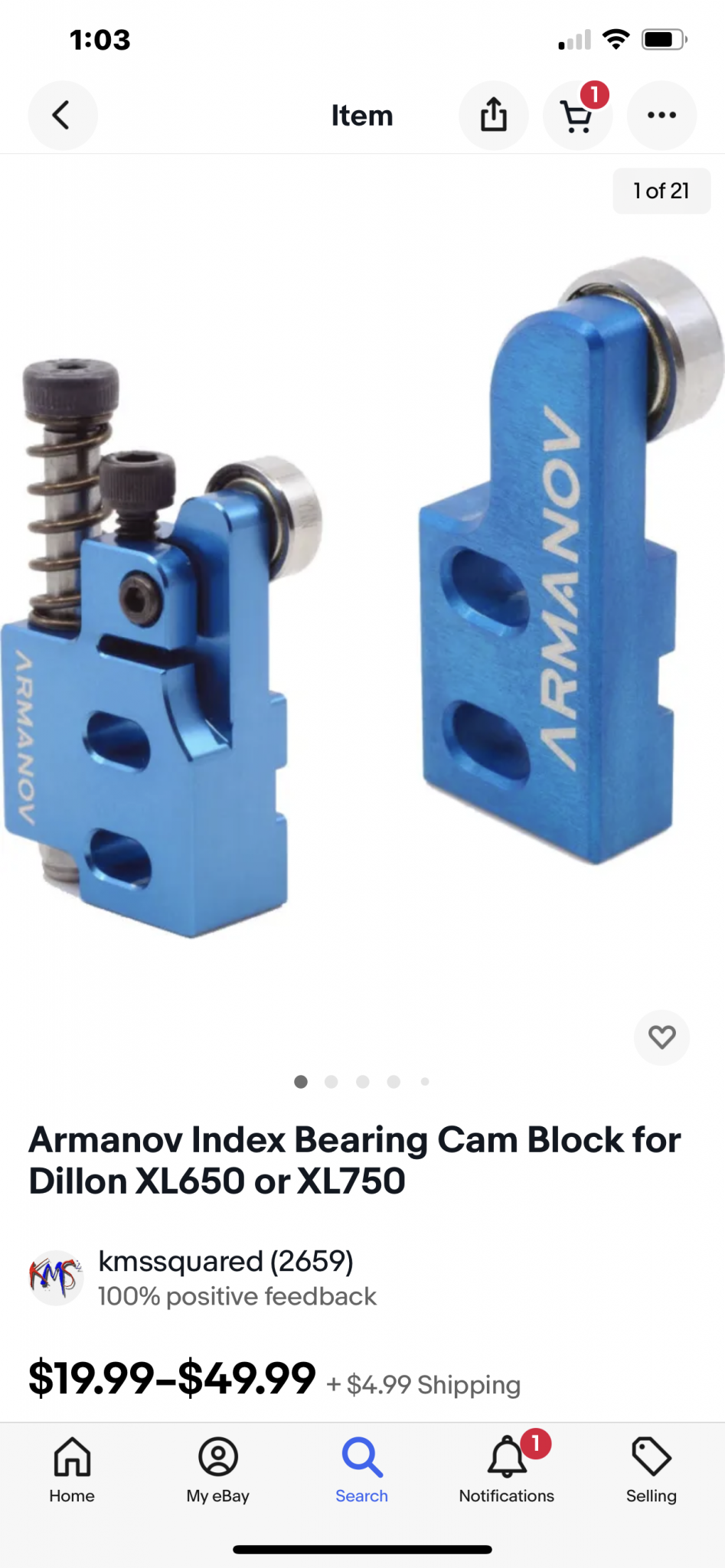

I only do 9mm on my 750.. but I've looked over the edge at doing .223/5.56 and these looked interesting, might be worth a try?
Saw those just today. Seem interesting...
