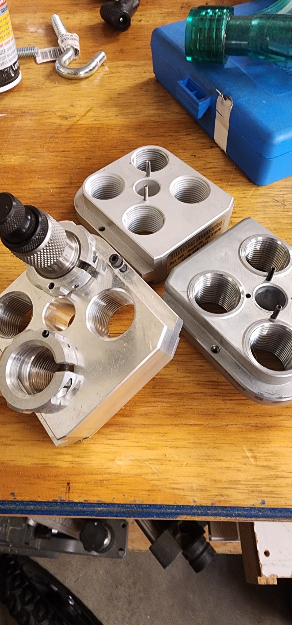

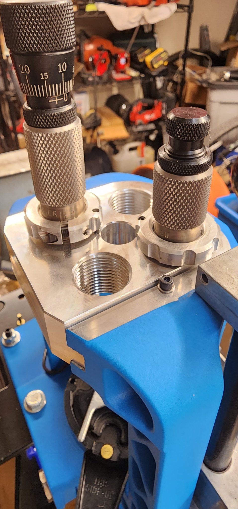

Wanted to add these images. I just got the roll pins and floater lock rings. I think I paid $100 or so for 3 whidden heads. The 4-40 Allen head cap screw locks out upward movement between the body and the tool head, and I think that keeps the adjustment in the seater / sizer die.
Also the shellplate bearing upgrade.
