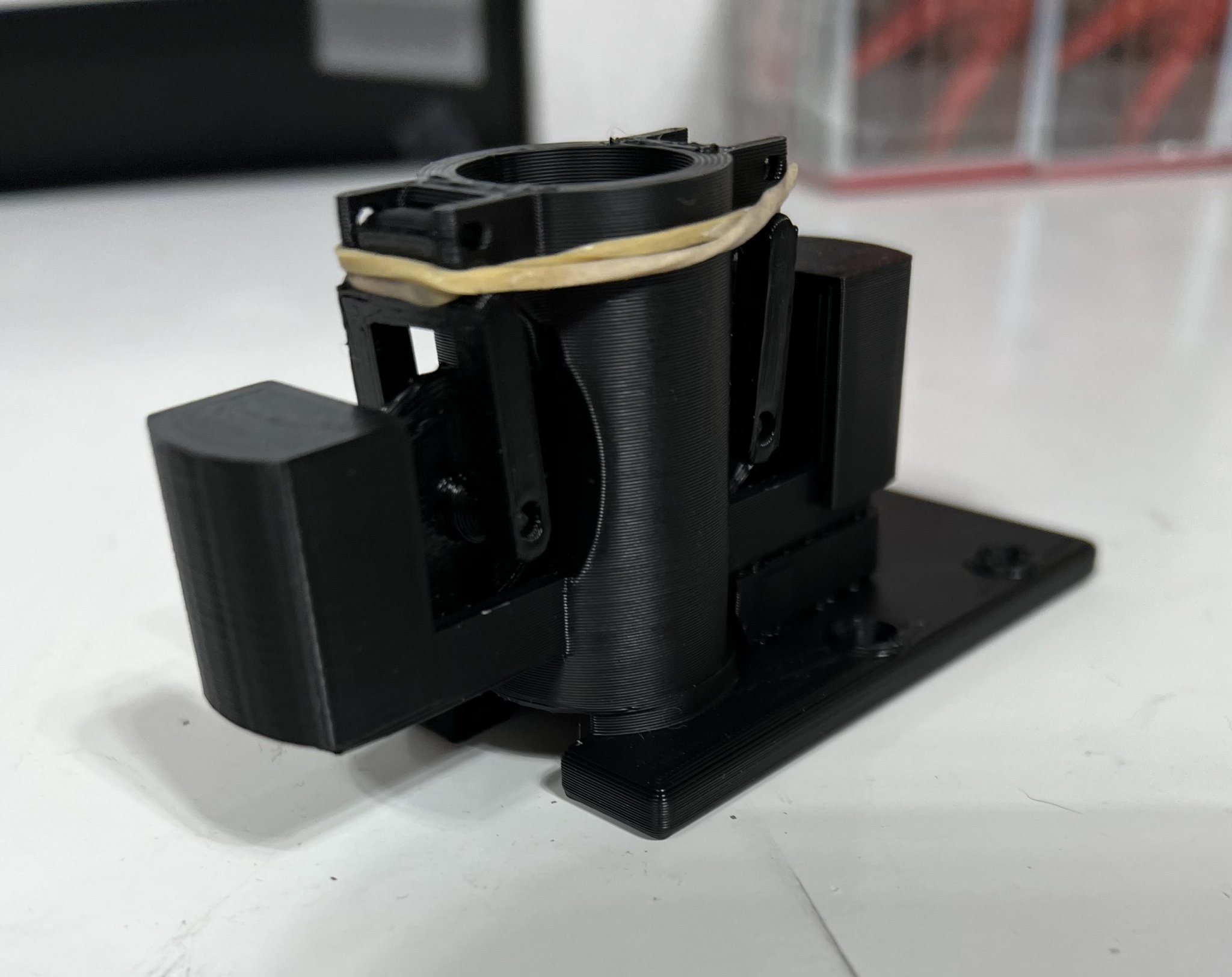

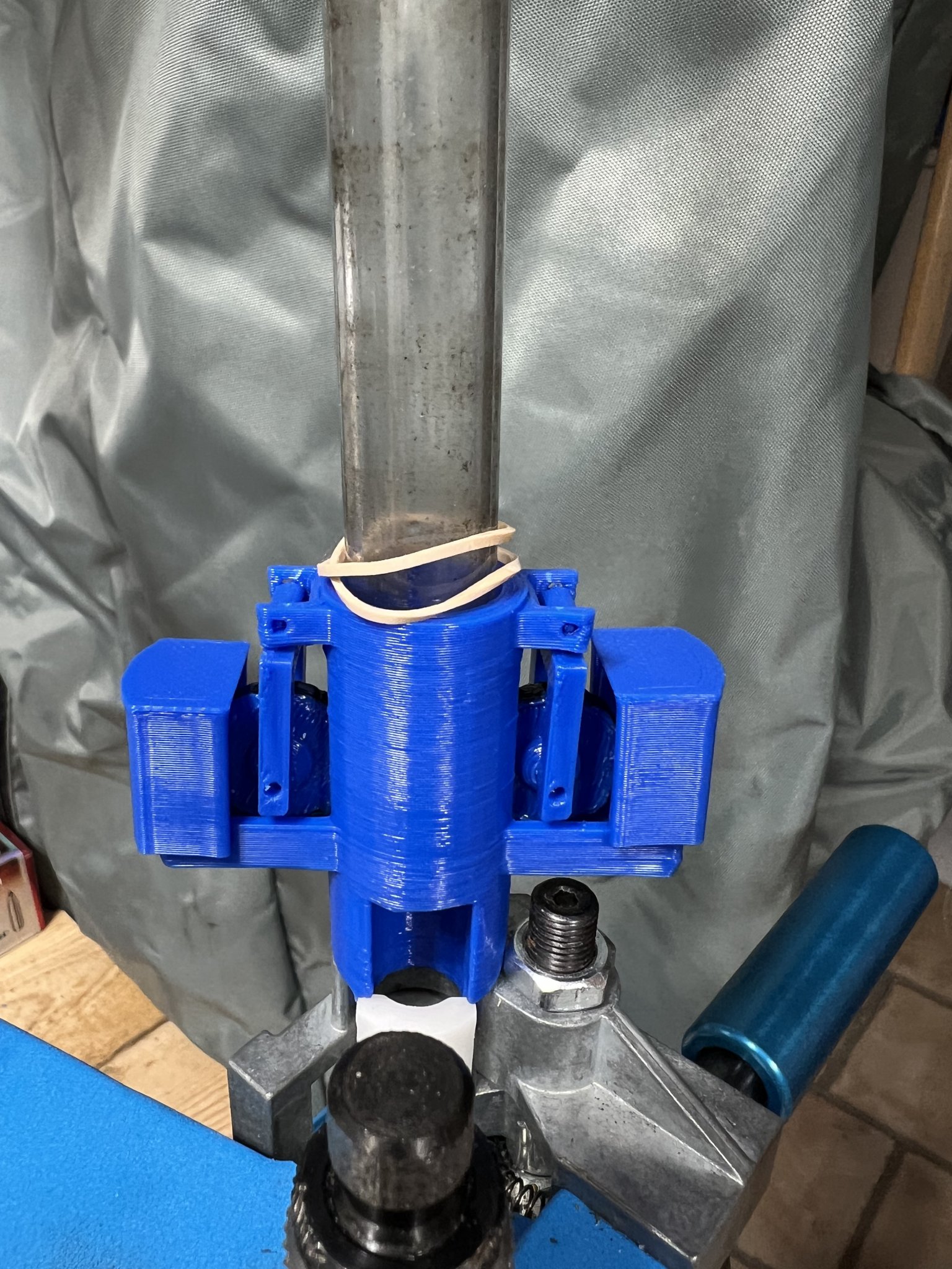

Hi,
First of all - it is not a commercial and I do not mean to violate any rules - just wanted to post it here to get more opinions on the contraption i've crafted recently.
It is meant for a direct replacement of the standard Dillon tube connector adapter, and lubricates cases as they go down the tube - this way i can run batches of tumbled brass without pre-lubing and drying them. It was always an issue for me to deal with 308 that was getting stuck during depriming.
I am mostly active on NES (northeastshooters) forum - if you google the thread name, it will come up with more pictures of it.
Just wanted to get into discussion with a wider audience on what would people think, as i do not think anyone did something like that before, and what, if anything, would be worth enhancing there.
I run it usually now on .223 and .308 batches, when i do not want to weight an every charge. I do not reload pistol at all - so, just wonder, would that be of any interest to those who reload 9mm/.38/.45? Do those cases ever have issues getting stuck in the resizing die, or is it not an issue that needs any kind of a solution like this one?

i tried lanolin for a while, but, being a brass rat and feeding in picked up random old 308 brass into a full body resizing die - that is where the issue was. after i ruined one plate as stuck case ripped up steel edges out - i made this thing.
a lot of people swear by lanolin, though, may be i just never got mixing it right.

8 to 1 for that kind of brass and you shouldn't have an issue.
What does your inline luber use for lube?

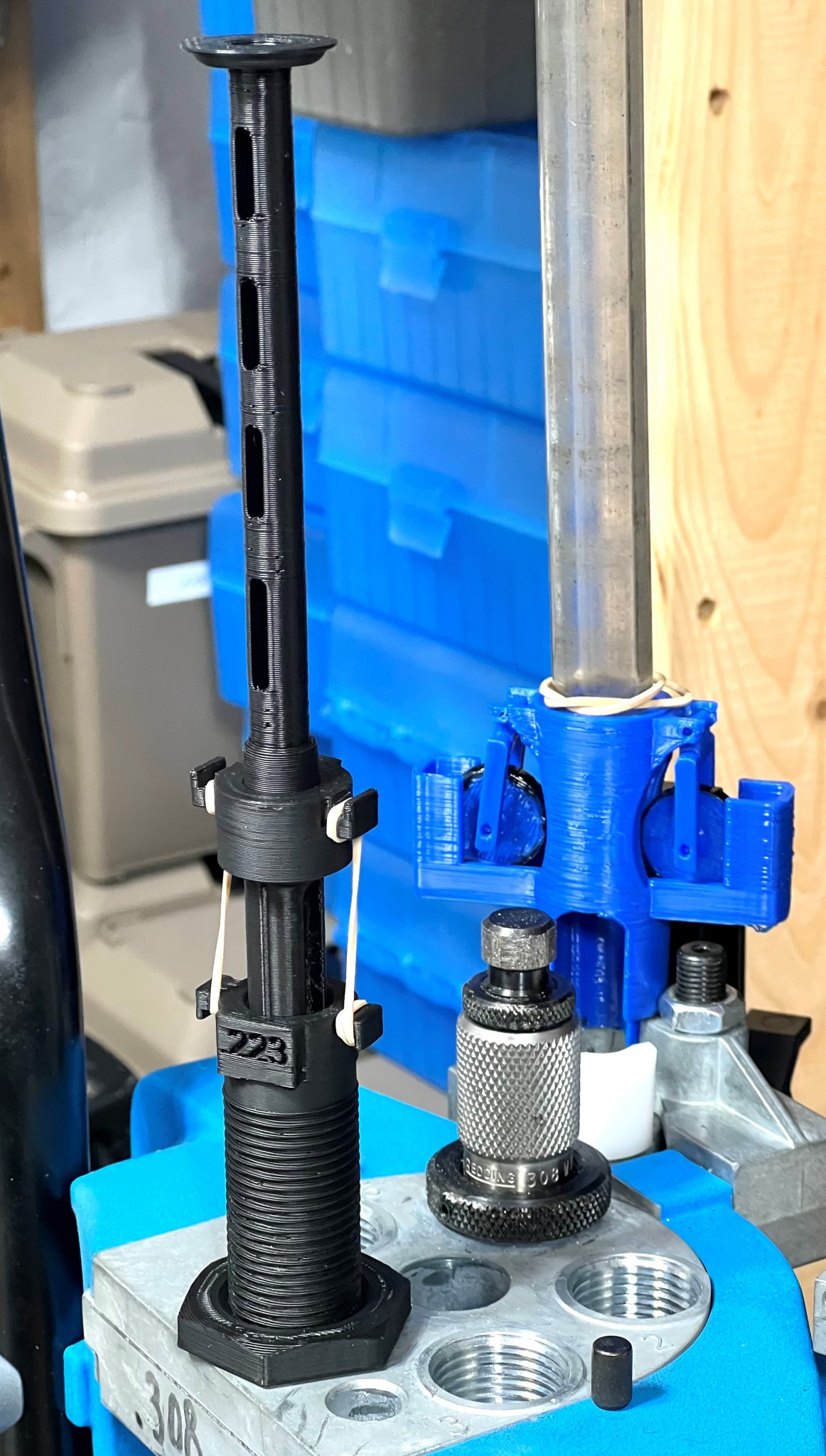

i got couple of new things to offer - made a set of simple bullet seating dies. i prefer to drop bullets 2-3 at a time instead of having a stack of them, and die just makes it easier to stack them into the tube instead of placing bullet into the brass every time.

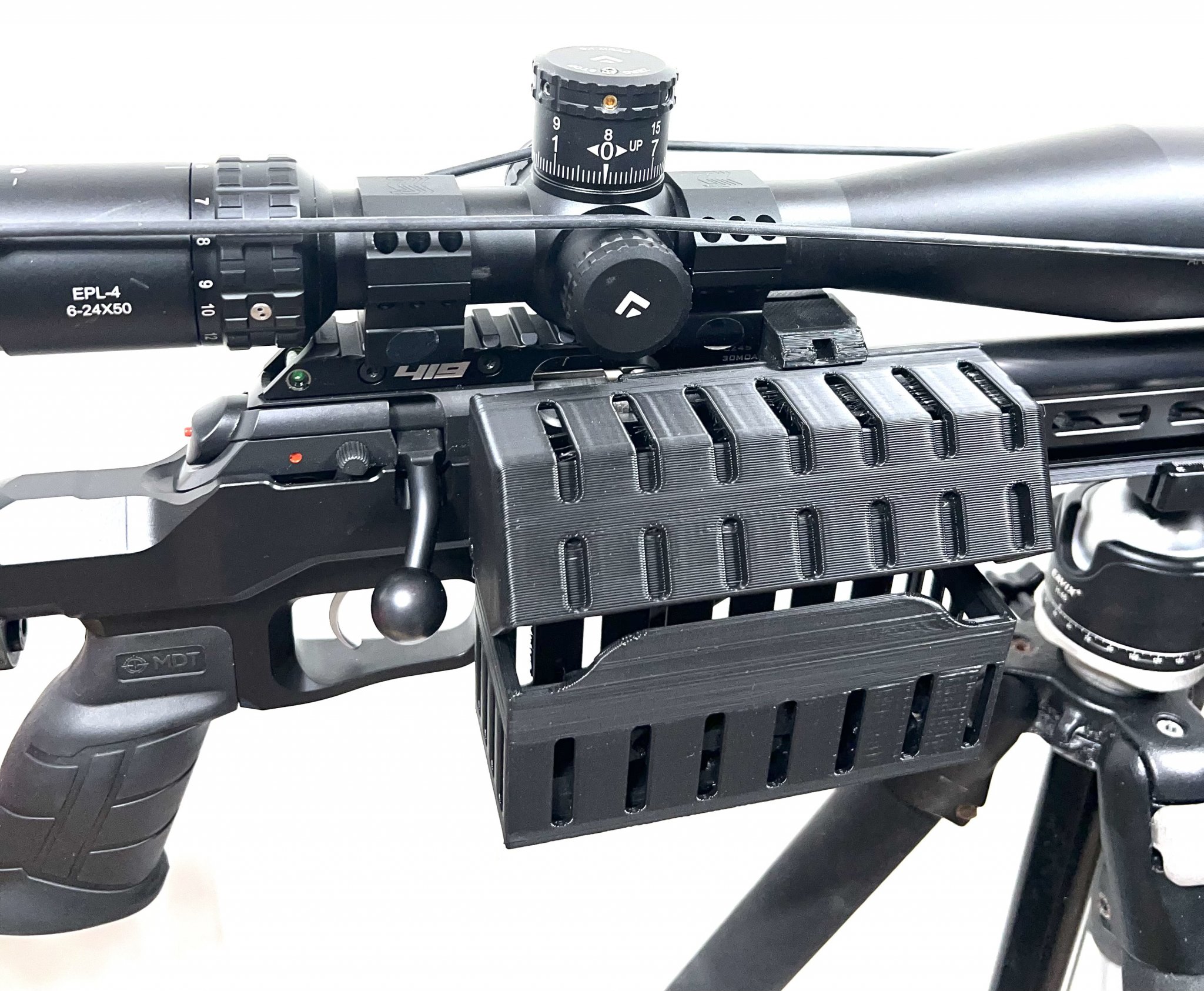

and got a brass catcher that is also pretty neat.
