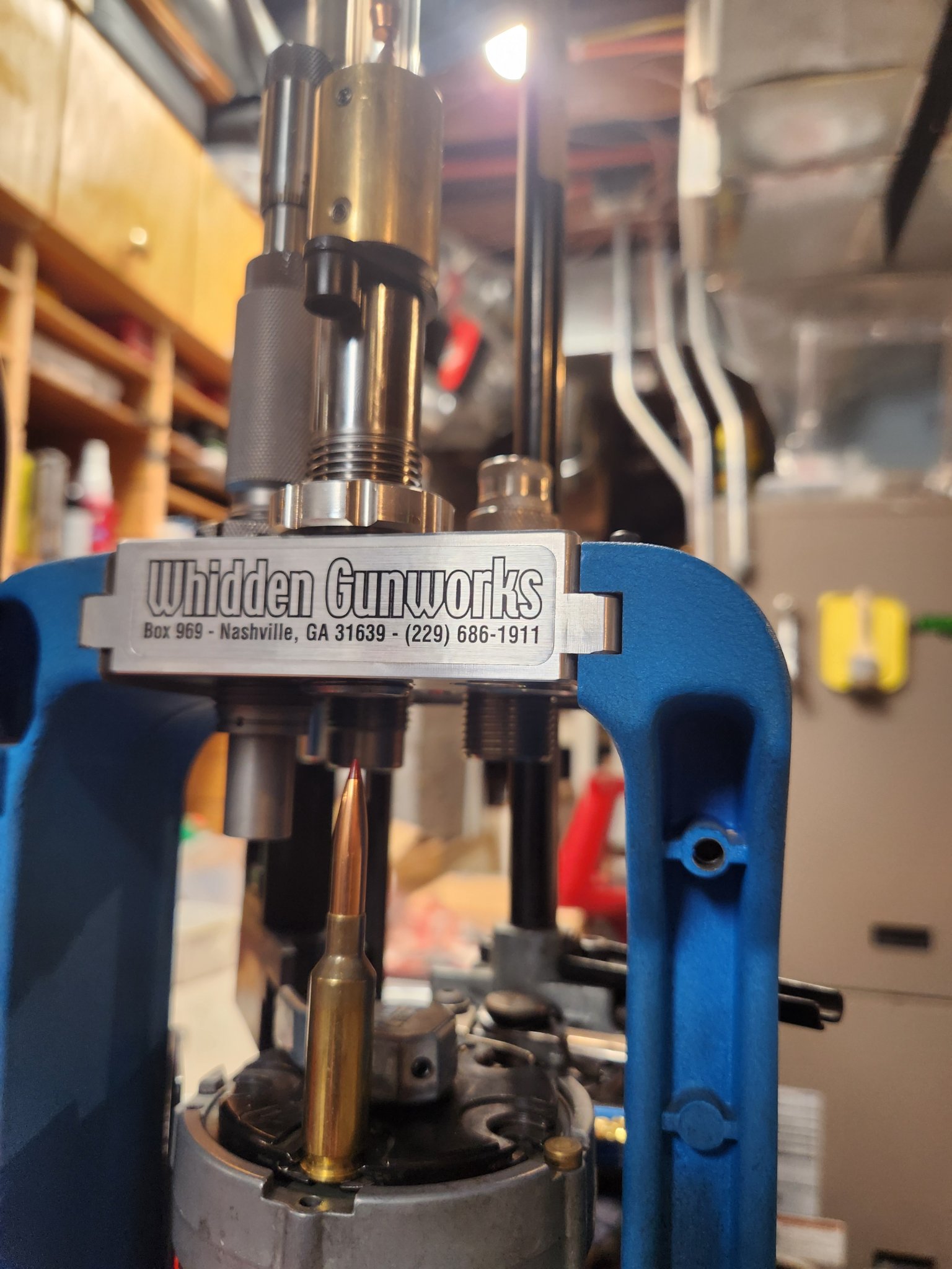

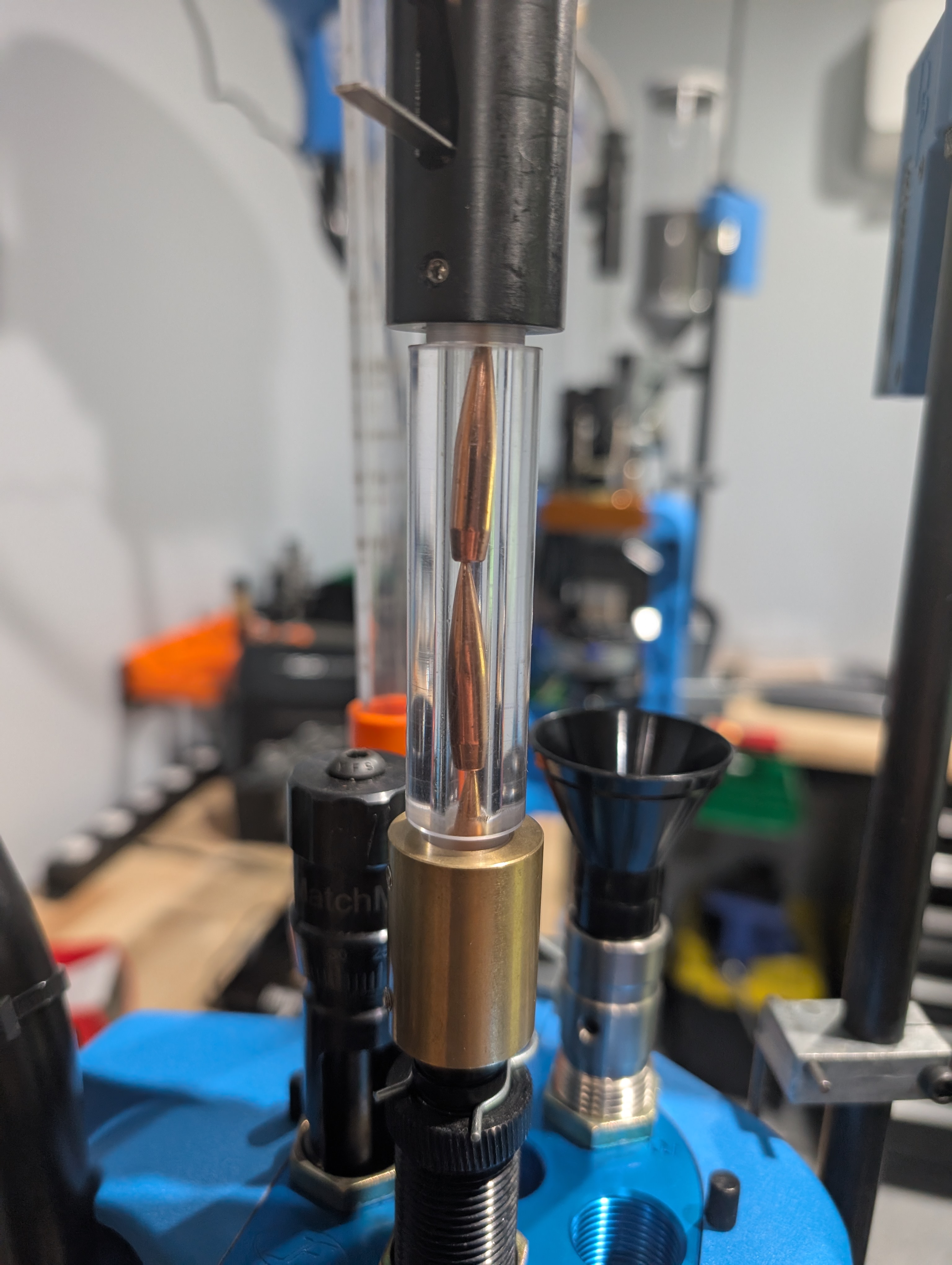

So, I have every type of Double Alpha Bullet Dropper die... But in my experience, none of them have ever worked well with 6mm bullets.
I load my match ammo on my Dillon 750 and wanted to automate the process (Mark 7 autodrive en route) but the bullet feeding has always been the hiccup.
Not anymore! 😬
Collator setup: https://www.snipershide.com/shootin...king-6mm-bullet-dropper.7196608/post-11347122
Bullet Dropper Setup:
Lee Inline Bullet Die (for 6mm)
DAA MBF Dropper Assembly
I used a 1/2" ID nylon bushing to mate the Lee dee + DAA assembly (it's press fit). Tighten the set screw.
(This setup is assuming you have the MBF... So, you may need the DAA Output tube depending on what you already have. And, of course, the MBF feeder plate)

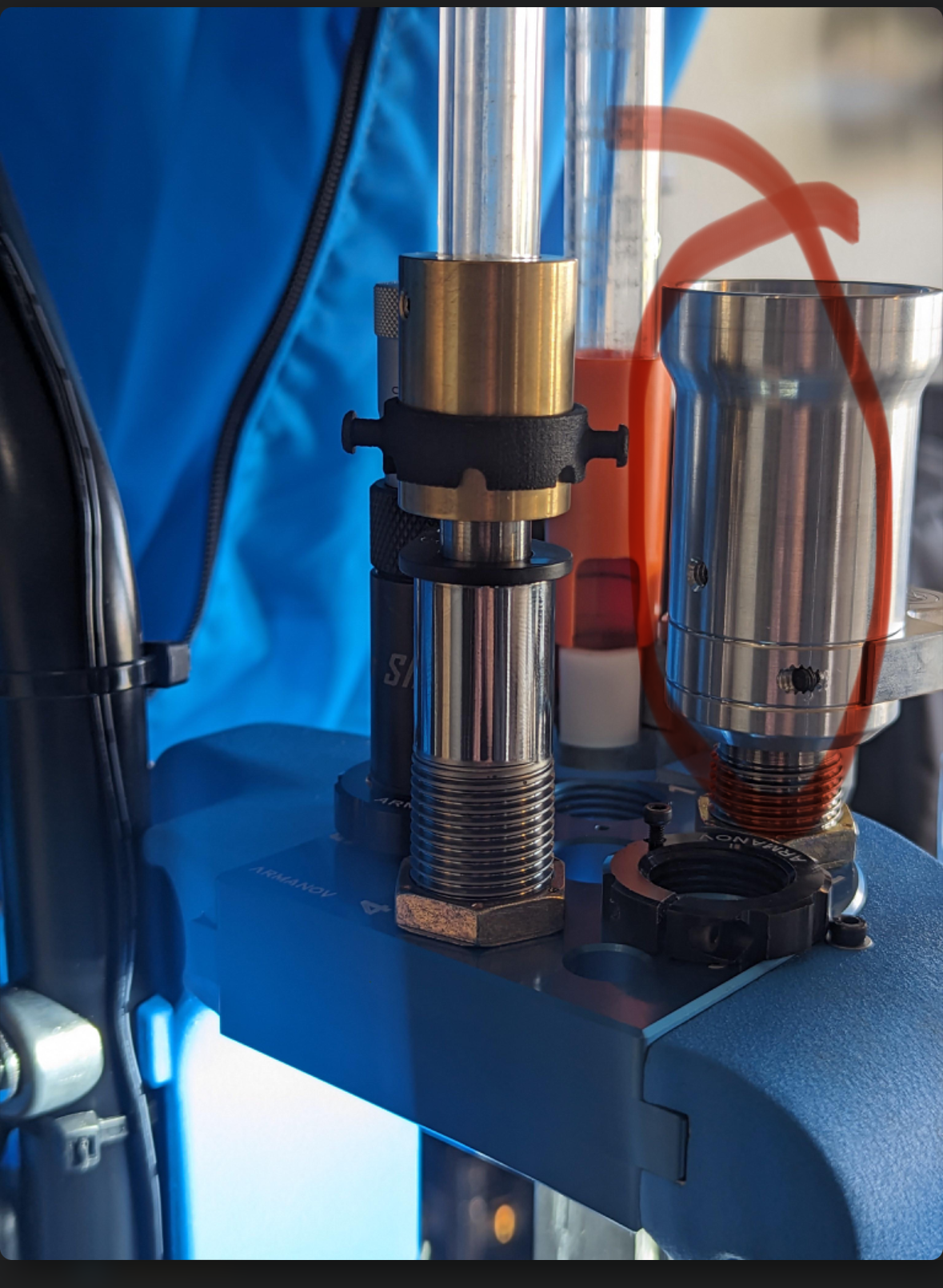

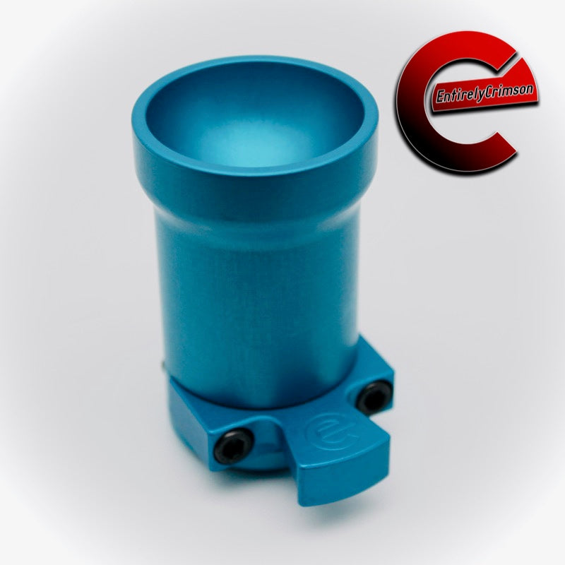

That's a powder funnel. I find it more useful than the area419 setup. It drops powder quicker and smoother in my experience. It uses the standard powder die with Dillon and whatever internal powder funnel you choose.
Nice I’m using the a419 funnel on my 550. I like the look of this, but I wonder if it’s too big and will hit my dies.

I ordered one of these Lee 6mm Dropper Dies, 3D printed a bushing to go from the OD of the dropper die to the ID of the brass Mr.BF dropper. This bad boy works like a dream with 142 SMK's. My 650 is also powered by an AutoDrive.....
Thanks for pointing out this new die, I think it's a keeper!
All the best.....

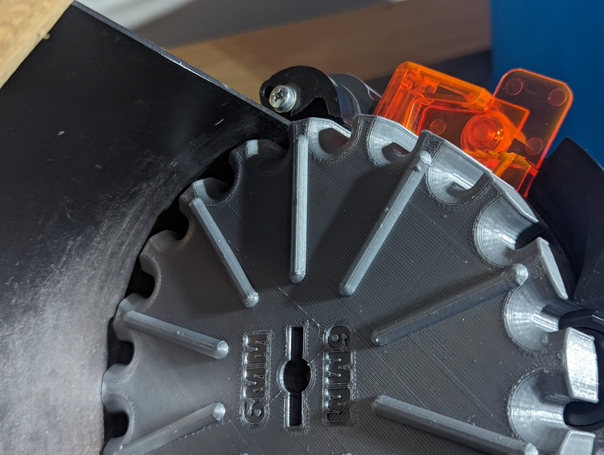

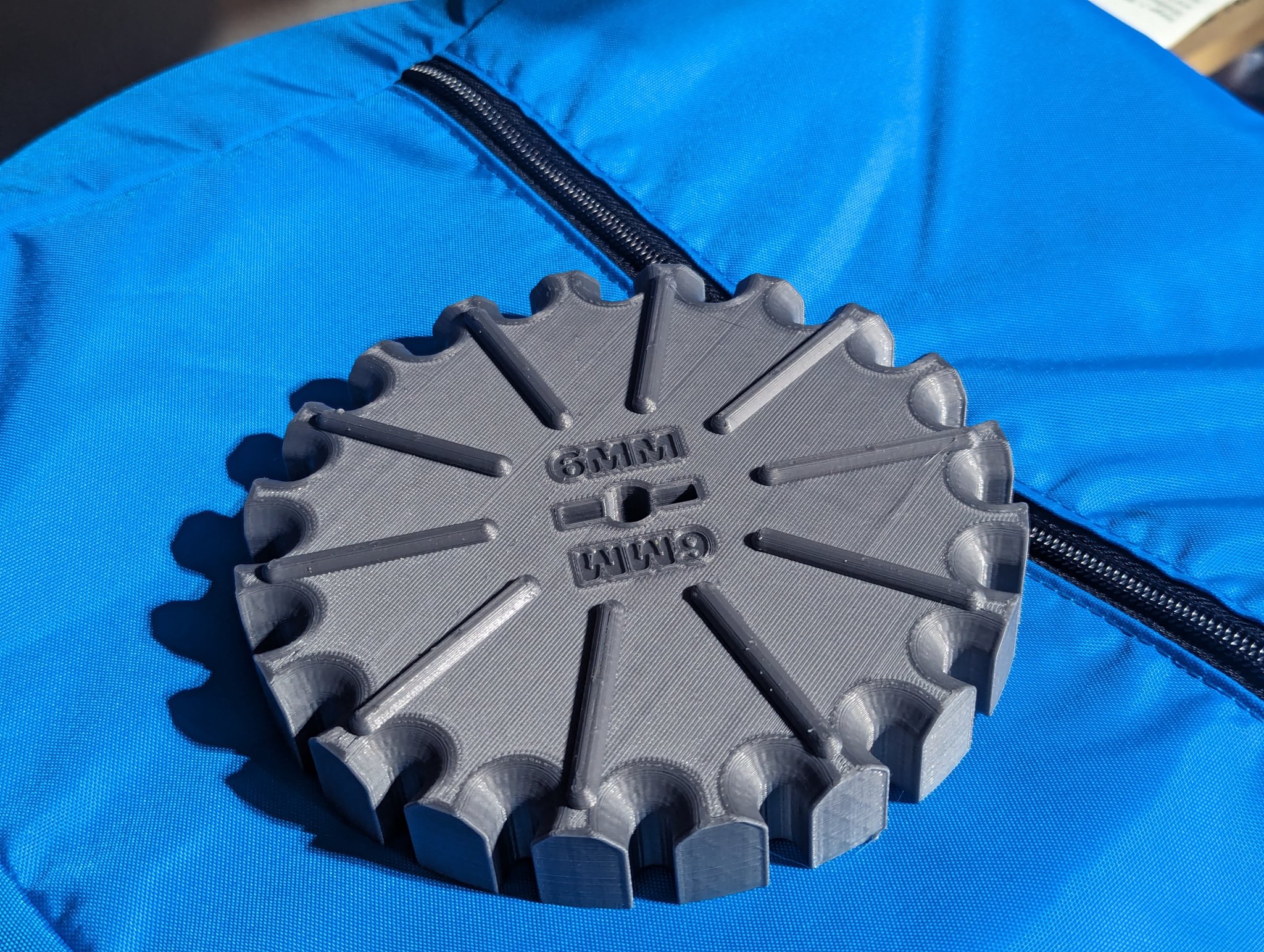

I had issues with the DAA 6.5 collator. It just wouldn't feed bullets consistently because it would jam 2 in 1 hole. 😆😉
I found an awesome 6mm collator. This gentleman basically took a request (that none exist on the market) and ran with it. Email [email protected] if you're interested in a 6mm collator.
Using the DAA orientation guide (orange thing in the picture) and a 3D printed ramp (aftermarket off eBay), it is now 100% running smoothly.
