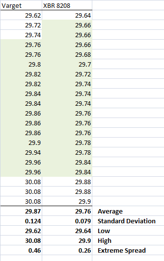

Depends what powder your using and what you've done to your powder measure. I have 7 or 8 powder measures for my 650 and all of them have been polished to a mirror finish, same with powder bar, the actual powder funnels have been polished inside as suggested by Dillon since they are drilled. I also have the Uniquetek powder baffles in my hoppers and the Micrometer Powder bar.
They are dead on with pistol powders, ball powders and 8208. I do not use the powder dispenser on my 550 with large stick powders like H4350 or Varget for my precision bolt gun loads.
