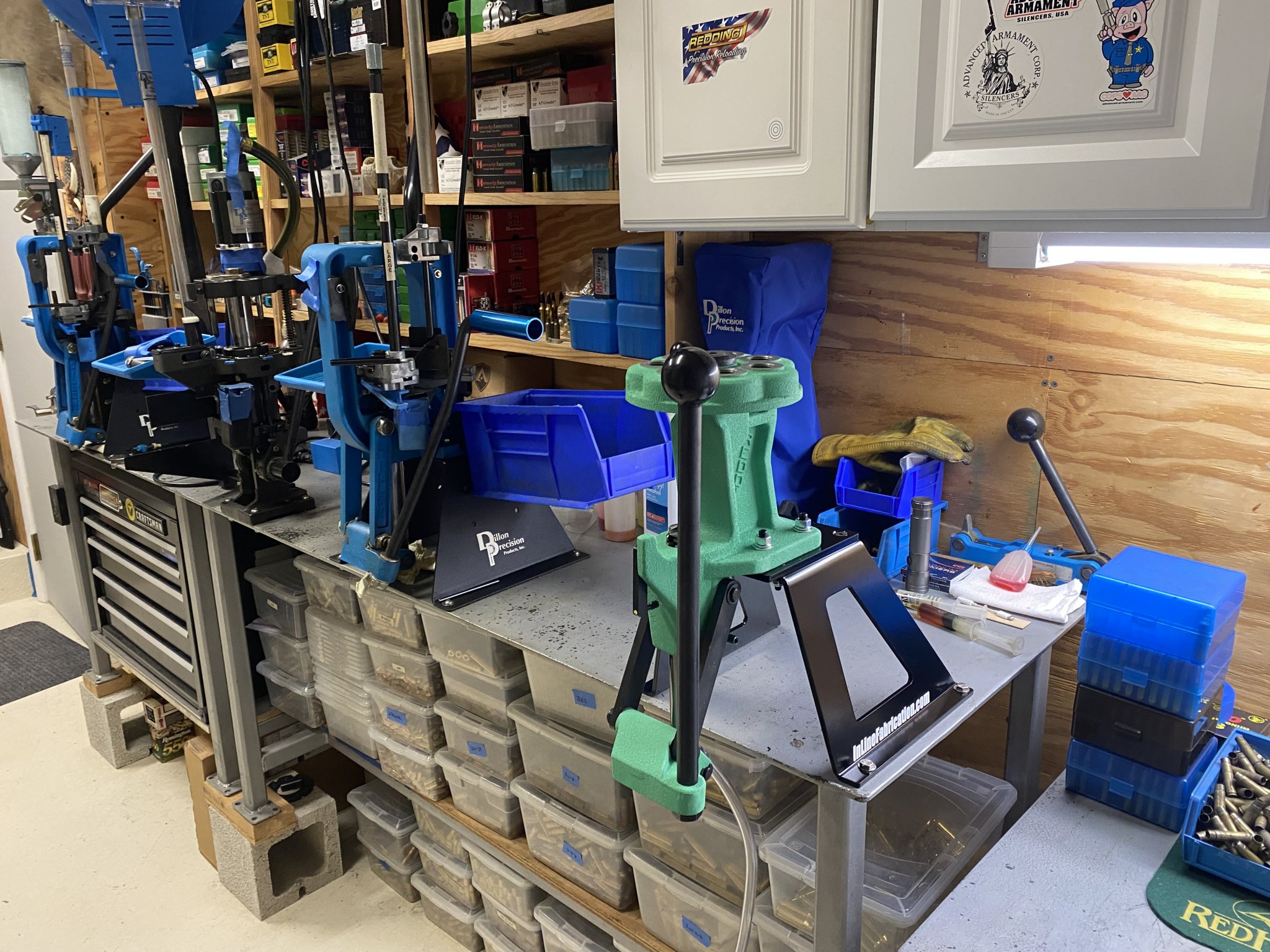

    Confessed 1050 addict. 1 dedicated 9mm, 1 dedicated.40, 3rd swings in .380 and .223. Keep them clean, lubed and deep clean every 5 k rounds. They run great.

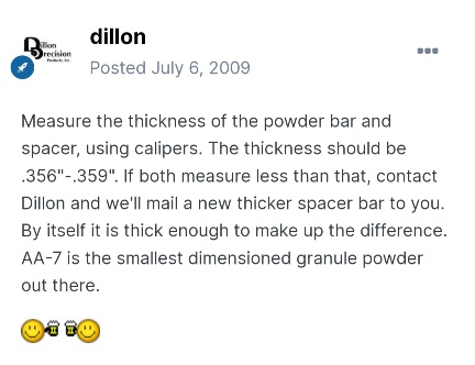

    1 thing I noticed is the little bit of powder that falls out of the powder dropper after a case has been charged and the toolhead goes back up... making a mess all over my toolhead. I'm using g WC844 which is like dust.
    What's the fix for this? I read Uniqiutek sells this Arrendondo powder drop slide eith Micrometer for this very issue..
    I also read using the old style powder bar return springs to close it off faster.
    Anyone use one or have any other fixes??

    A heavy-duty rubber band works as well or better than the old powder return spring... all you're really trying to accomplish is closing the powder bar faster, USPSA blaster guys on the Enos' forum have been doing this for years. Some powders are easier to deal with than others though, the finer ball powders are going to always make a little mess (keeping one of those squeeze ball air blower thingys around to blow the tool head off helps).
    These are great, I keep a couple in the reloading room and one in my pack to blow moisture/shit off scope lenses:
    As far as the Arrendondo slide, just looks like a gimmick to spend money on to me, I don't see how it would help.
    Yea I have a can of compressed air next to the press...
    That's why I asked about the Arrendondo....for what it costs I want first hand accounts of it actually working before buying it.
    Out side of the usual bar fitment and timing fixes (spring/rubber band/pause at top of stroke) another cause can be a small gap when the internal drop tube wasn't pressed fully into the body.
    About 12 minutes in you can see what he's going to fix.
    Reactions: Arevalosocom

    Just sold my Rockchuk and replaced it with Redding T-7. It looks like a nice press
