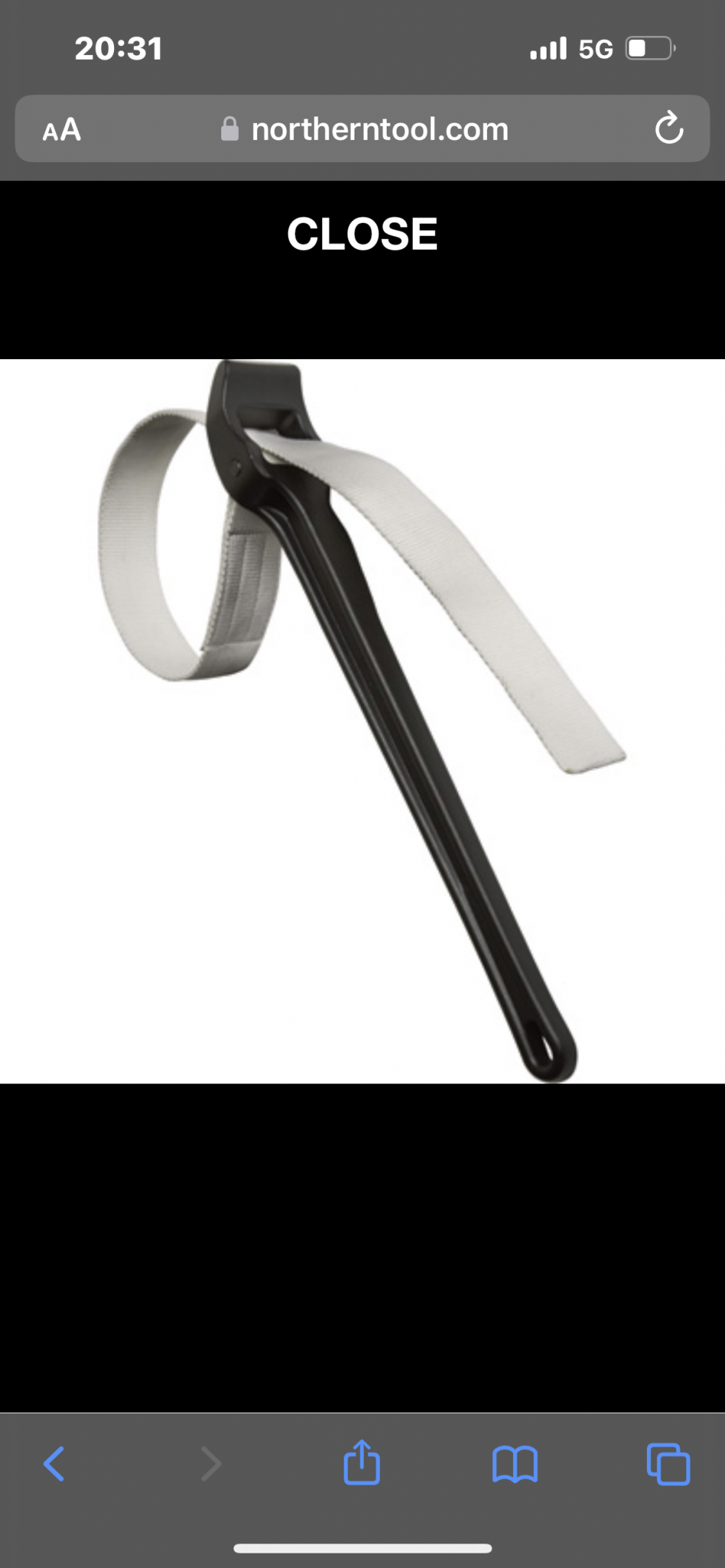

On ARs I use a strap wrench to put a little extra torque on there.
Makes removing carbon locked ones a breeze too.

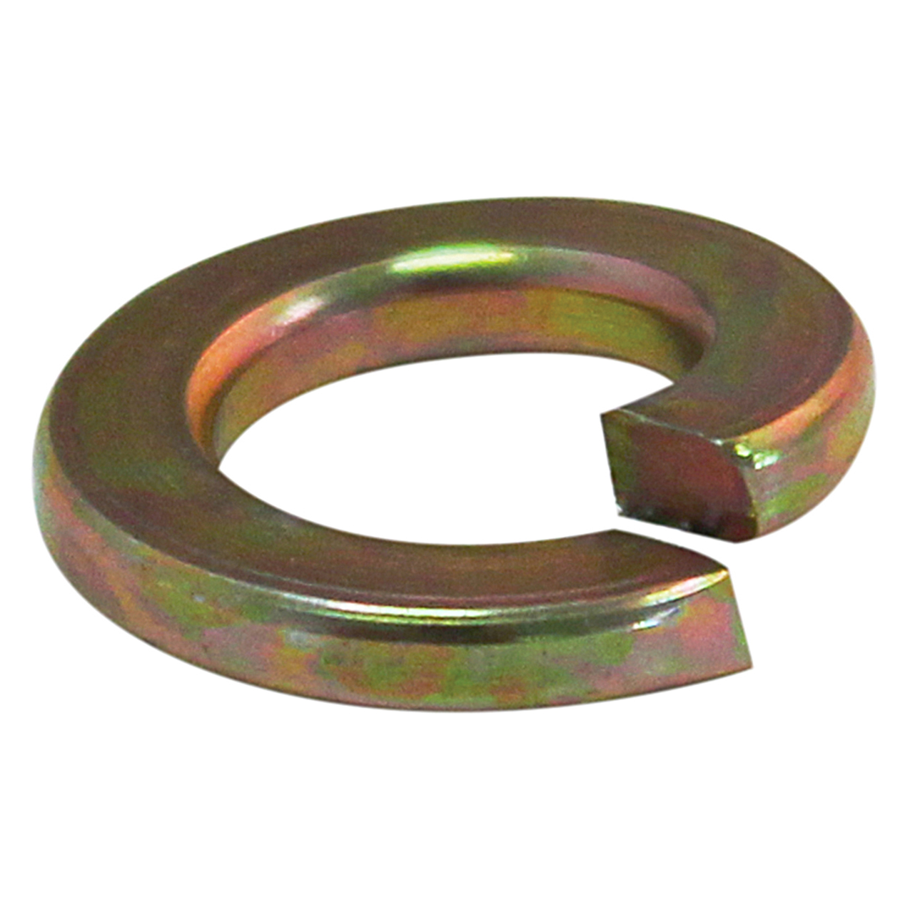

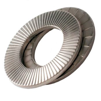

Went down a lock washer rabbit hole.
Anybody use Nord-Lock type washers in industry? these look like they would be the ticket for this application if someone were inclined to.
