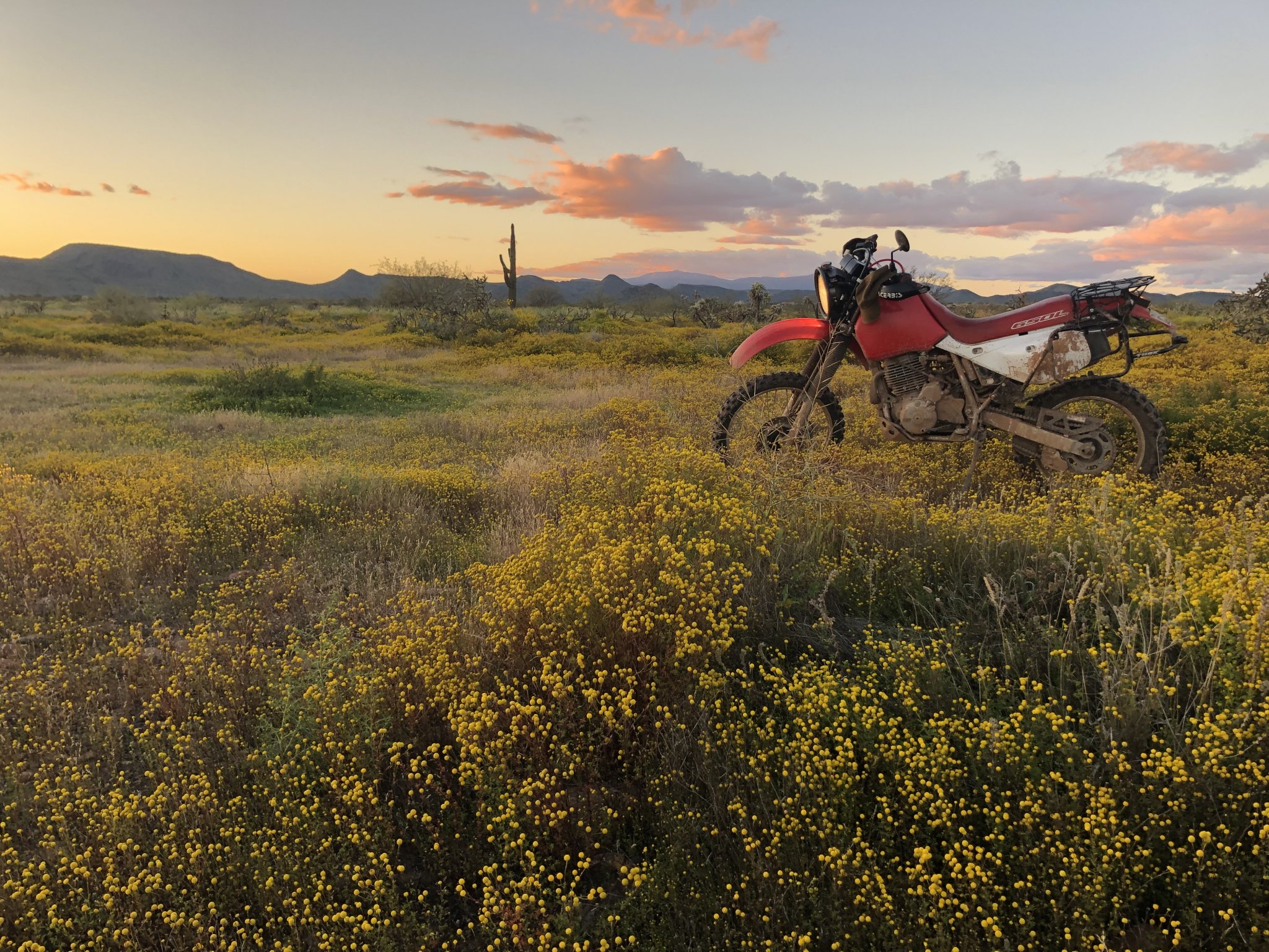

I’ve been riding street and dirt my whole life. My buddy has an XR650 (does not have signals, mirrors, street legal pkg) and it is the baddest motherfucker I’ve ever ridden. Fuck loads of power, and a powerband as wide as the Mississippi. You will not be disappointed.
I have an old XR250 set up as enduro and street legal, and it’s a fun little bike to putt around on, but nothing like the 650. It’s a beast.

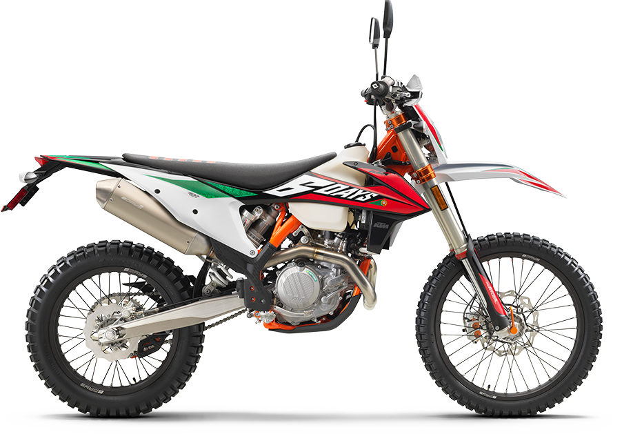

KTM does make a street legal version, the EXC. I’d say get an Offroad version and make it street legal if you can.

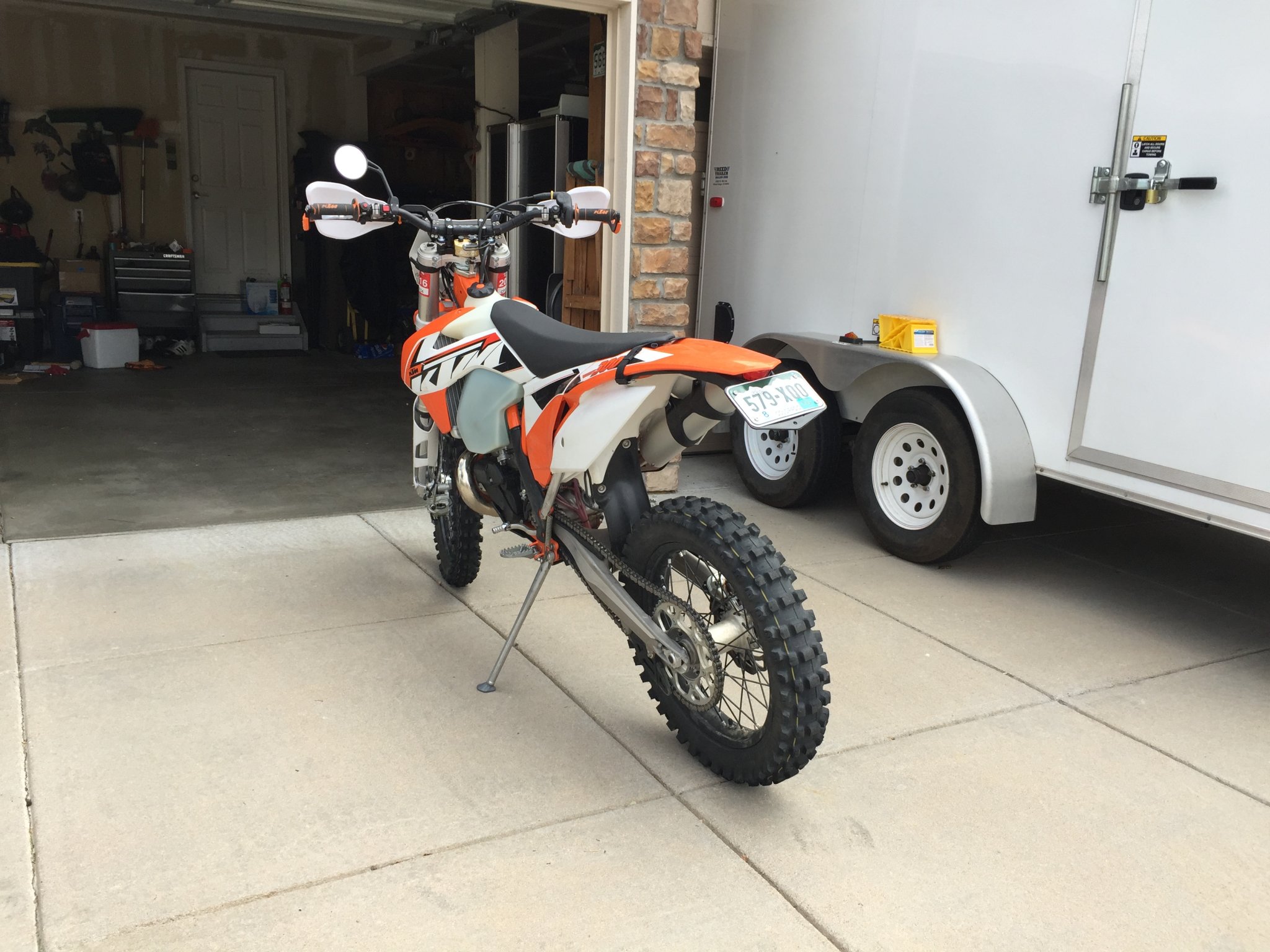

Such an easy choice. KTM. They only make the EXC (road legal)in a 500 and 350 In the US. I’d lean towards the 350 personally, but I prefer to ride in tight stuff. Both are powerful, but kind of mellow in street tune. You can pep them up easy enough as the want/need arises. An XR650 feels like a John Deere compared just about any KTM imo. There‘s absolutely no comparison in chassis or motor.
Two stokes are my fave though.

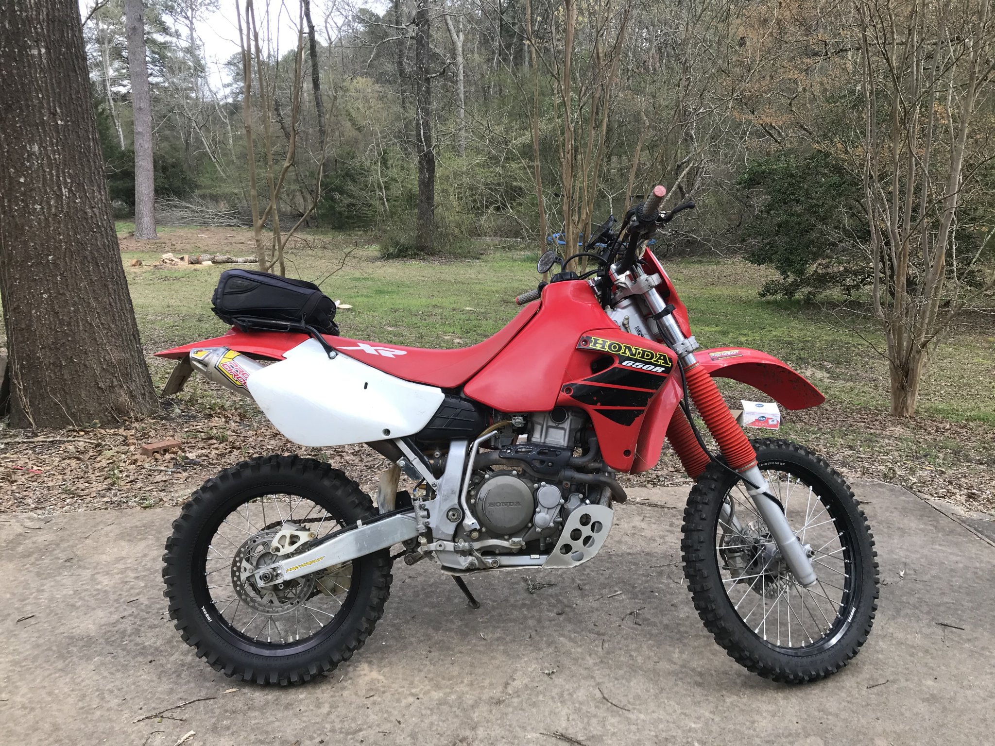

THe XR650L isn't much of a Dirt bike. I've had one, and it's a fantastic all around bike. You can certainly get it done off road, and ride back home. Just doesn't sound like what you want.
I have an XR650R with a plate now. It's a whole different story than the XR650L. Good suspension, insane animal power. Last of it's kind analog-carburetor power delivery. I had to add a 12v system myself for lights and such, and it's a kick-start only, but it's a hell of a bike. Can't see selling it, especially now that I picked up a vespa dirt cheap to run around town on. The XRR literally eats rear tires like it was made to do it.
But the wheelies are worth it.
TL;DR:
Honda CRF 450L if you have the money.
ETA: Gratuitous photo of the Big Red Pig, just cause.

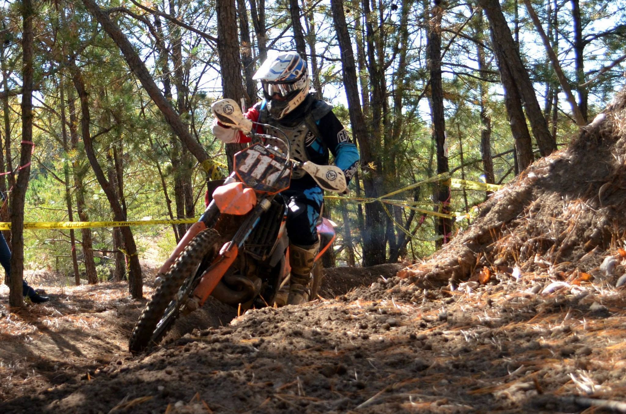

I hadn't really considered new/used yet... Was more focused on identifying the right bike. I guess I would probably prefer used. After all, this is just a weekend toy and I have enough expensive hobbies already. Don't we all!
I watched that video review and like a lot of what he said about the XR650L with the exception of a few things.
It's heavy: But, the terrain I'll be riding on looks a lot like the pictures from DirtyD. Pretty open, not many real "trees" and not a ton of elevation. So, maybe not a huge detractor.
