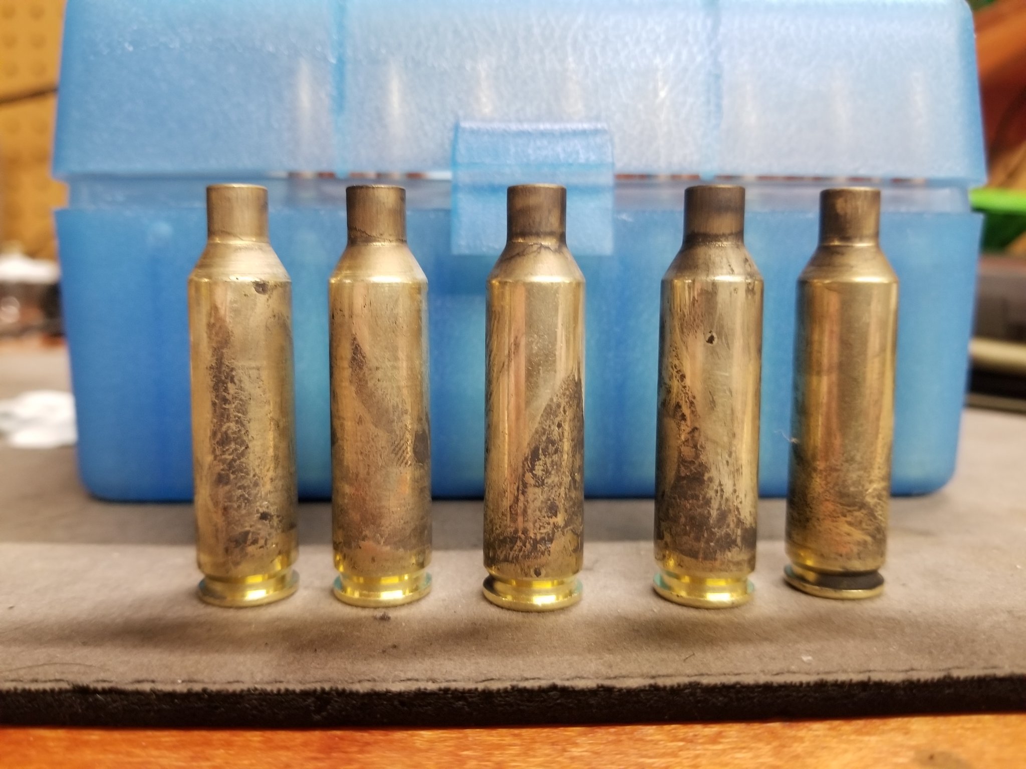

Dirty brass in bolt gun
FatBatman
Jan 19, 2021
20
16
Pennsylvania
I am having trouble with my 6 creed. After 600 rounds on the barrel I am starting to get extremely dirty cases. Does anyone have an idea of what could cause this? It also is starting to show an ejector mark and heavy bolt lift. 40.2 gr h4350 2xf lapua brass annealed with my amp 108 Berger bt.
Moisture or carbon ring. I had a carbon ring going that gave me some funky cases too. Was really tough to get gone too.
Few wet patches and a bronze brush let it sit repeat
I only ask because I thought I was cleaning well enough and I wasn't. I don't do Bronze brushes though so you might be doing better than I was at the time. You can see a carbon ring with a bore scope if you have one. Was there any moisture that could have gotten on your ammo or in your chamber?
A CLR soak may be in order.
That's what I had to do to get it. I have recently ordered some chamber plugs from possum hollow in hopes that I can plug my barrel from the chamber end and soak the chamber with boretech or clr (for 30-45min only) and not have to mess with pluging the muzzle end and all that goes with filling the chamber for a soak and plugging the muzzle end
Just some clr wet patches being allowed to sit and dampen it for 10 minutes should do to sufficiently loosen it to be wipe cleanable.
Reactions: Aftermath
What are you using for case lube, and how are you removing it? Looks like you can see finger prints in the dirt.
I see similar marks on the brass when it’s been fired wet, (I.e. rain snow). What were the conditions when fired?
As a side note what action, barrel, and speed?
Yes that will work if I keep it reasonably clean. It wouldn't work for the carbon ring that one time so I plugged the barrel with a foam earplug and let it soak for about 30 or 45 min and then scrubbed it with a nylon brush. That worked pretty well and got it. Now I do exactly what you're talking about in that area but I'm always sort of second guessing if the wet patch is sitting in the right place so I figured with the chamber plug, I can just drop a little down the barrel and let the chamber soak then clean as normal and it will just be easier. Also, it's a real PITA to plug the muzzle end of a barrel with a qd break on it.
Reactions: spife7980

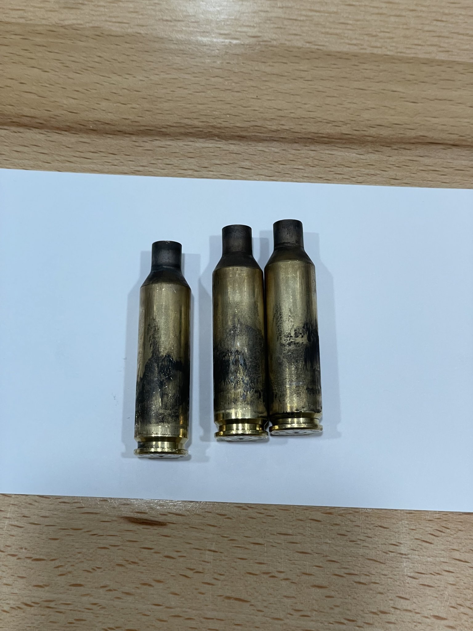

Firing this thread back up. I am having the same issue.
6mmCM
Lapua Brass
40.1 4350
105 Berger HT
Dirty cases when I seated .010” Jump, but clean cases when I seated .080” jump.
Maybe the long seated bullets were in a carbon ring? I’m gonna clean it and see what happens!

Yes and yes. Here is brass fired in the same sitting, but seated to .080 jump.
I needed to seat my bullets deeper in the case for the problem to go away. My theory is the increased seating depth allowed a higher case pressure before the bullet leave the mouth. Allowing it to seal to the chamber.

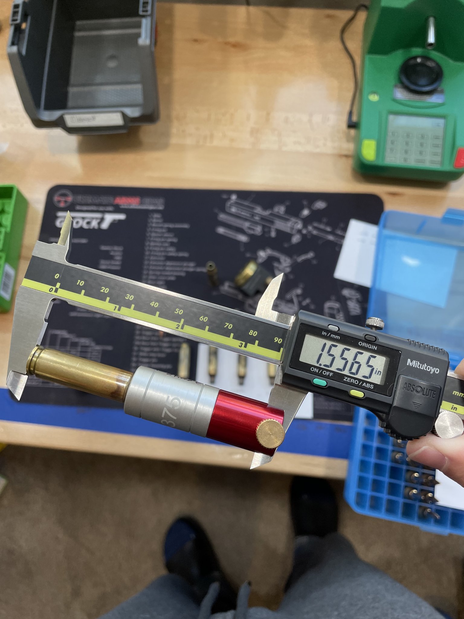

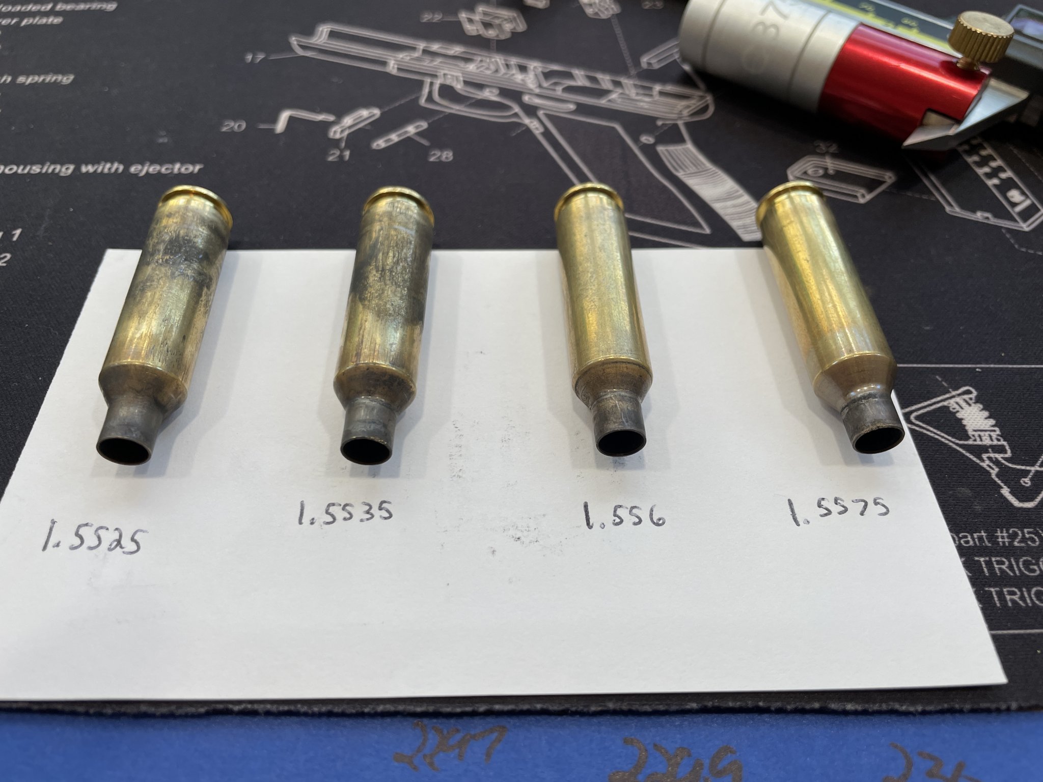

So I just measured 2 dirty cases and got 1.5535 and 1.5525. The 2 clean cases measured 1.556 and 1.5575. See picture, the longest or most expanded cases sealed at the neck. The second longest sealed at the shoulder and the other 2 didn’t seal. Both on the left were seated to .010 jump and the ones on the right were seated .080 jump I’m pretty sure.
All cases fired 2 days ago and were annealed with AMP and sized with the same Hornady die in the same session. Lubed with Hornady one shot.
I will say I use a .267 neck bushing with a .240 expander ball. I don’t like the idea of the expander ball on the up stroke, bc in my head I feels like it pulls the shoulder back up a little bit.
I will be swapping to a mandrel soon.
You have 3-5 thou more growth in the sealed cases so that means the case hasn't sealed in the chamber on the dirty brass. Take those 2 cases load them to .080 off fire and measure them. If they grow to .557. What coal are you loading to? I had to go shorter than what berger says to get it to seal up properly.

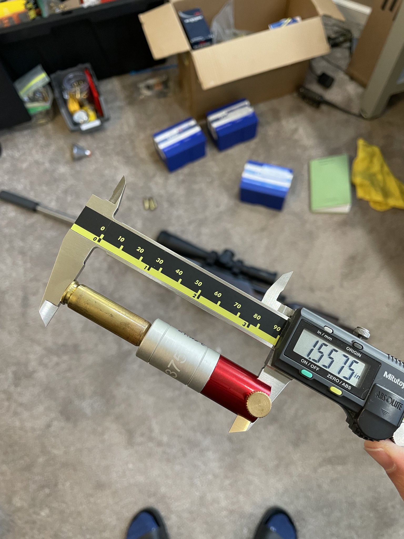

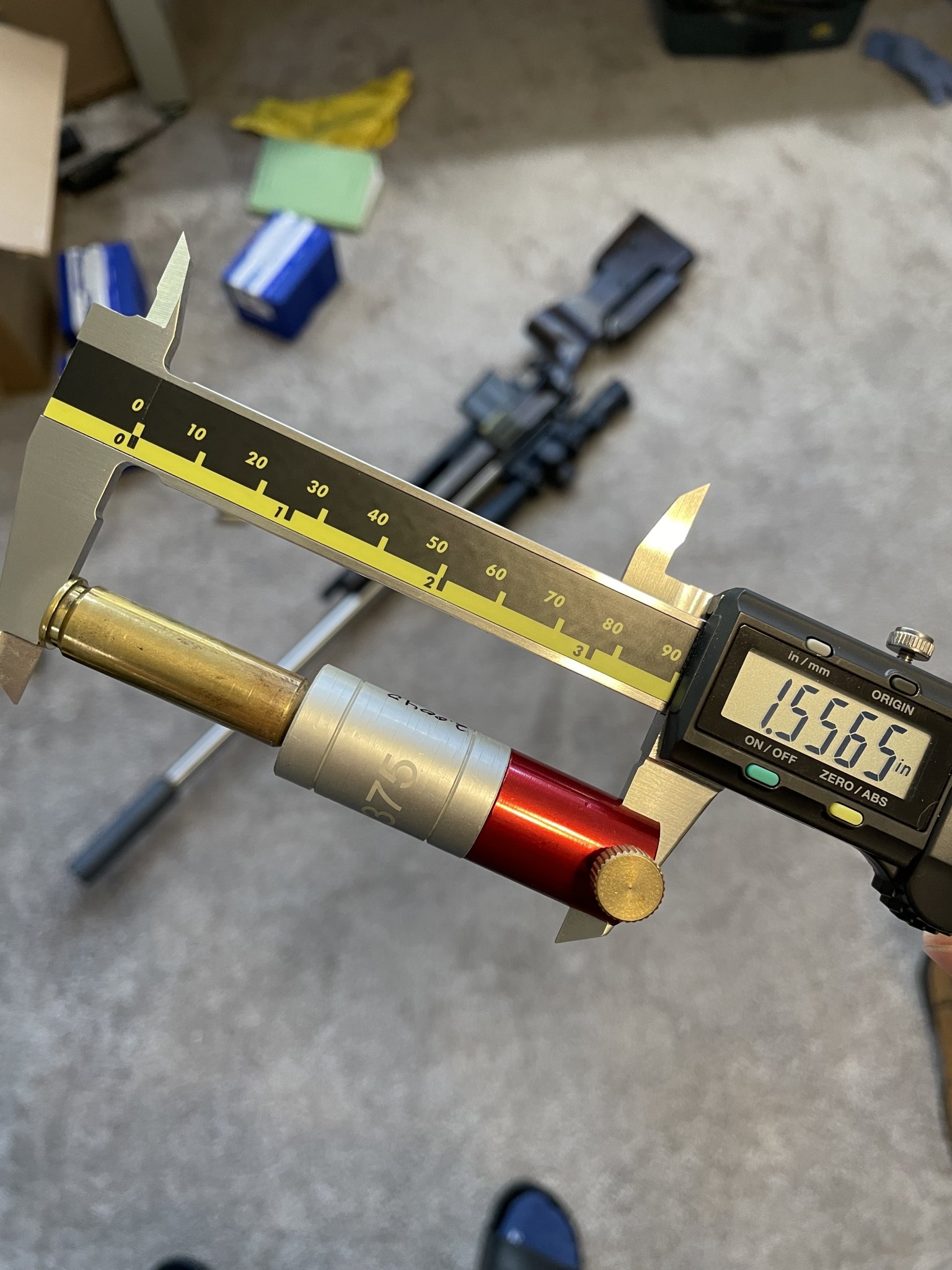

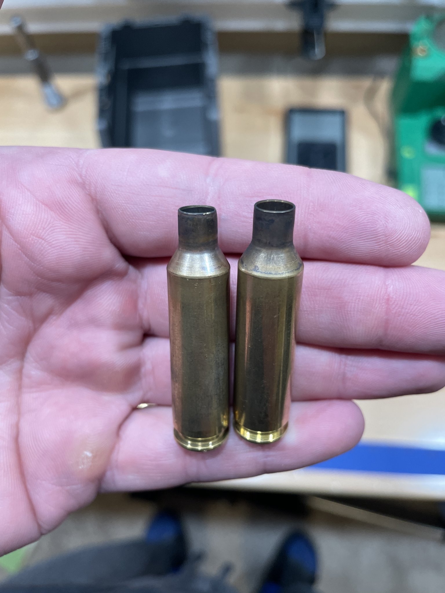

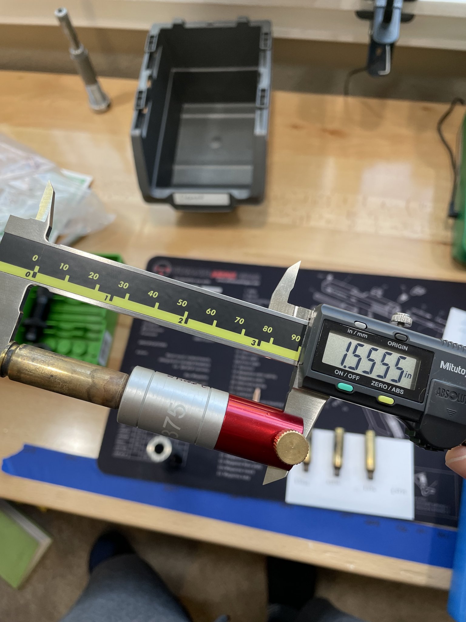

So I just measured the shoulder on some I had loaded to .010 Jump that I can see stains on from previous gas leaks on the last firing(the problem loads). It measured 1.5565 before firing and ¿SHRANK? to 1.5555 after! What the heck. So I grabbed another and seated it deeper and it GREW!
First 2 pictures over the bench are of the brass that shrank after firing and second 2 over the rifle are of the brass that grew.
