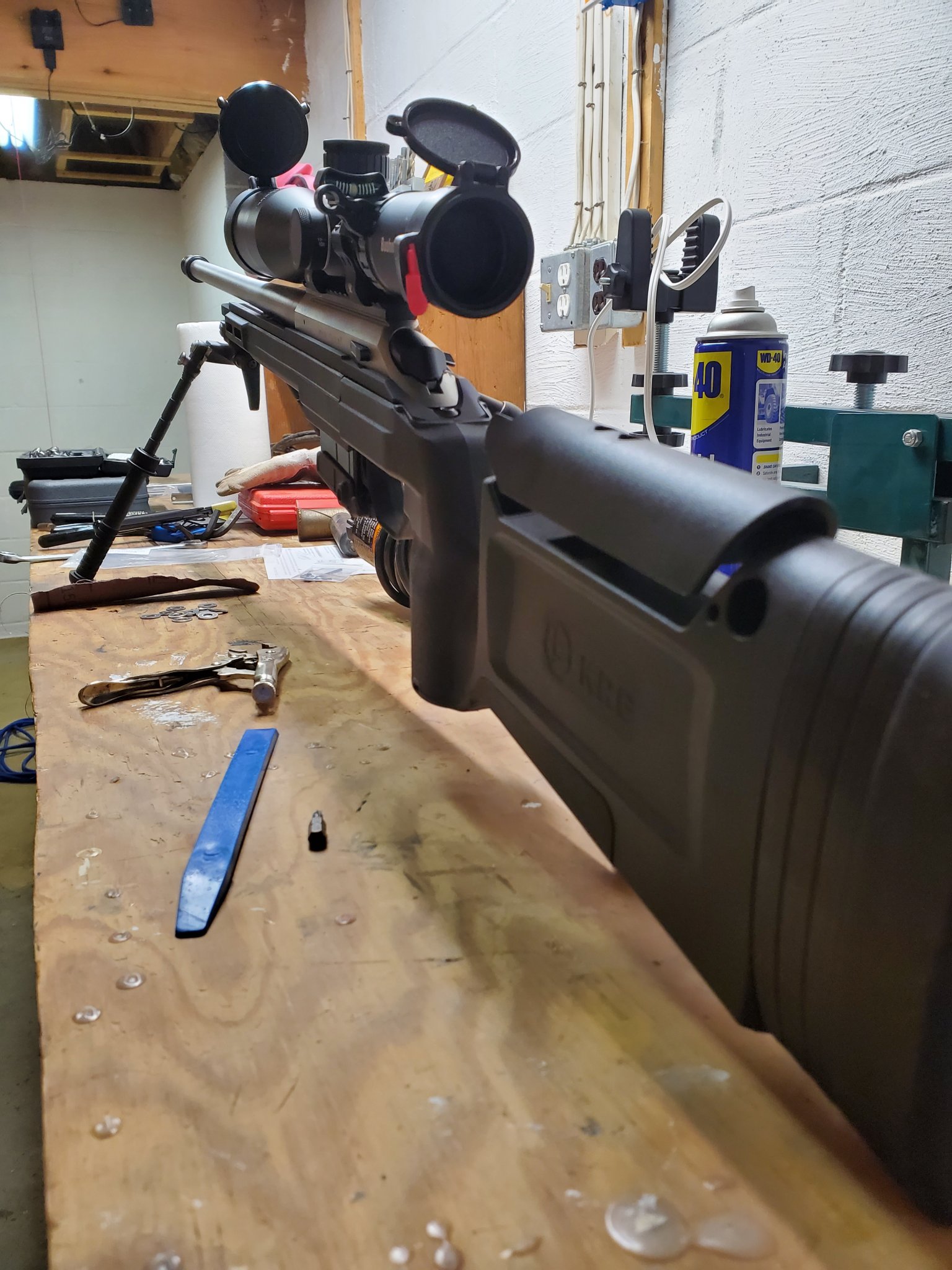

View attachment 7315273So a few days ago I installed my mountain tac 20 moa rail and installed my current scope with .90 vortex rings. I got the itch to get some arc m10 rings and found a good deal on some 1.10. The picture is with the .90 height rings. Any disadvanteges to another .20 added on? I would think maybe a bit better cheek weld and position?
Haha. Too high dood.
You can fit a human hair in there..
Well?...whatever floats your boat I guess but to me?...there's just something fundamentally flawed about setting up a rifle in such a way that your head is positioned well above the barrel...tactically speaking?...it seems like your setting yourself up to be picked off as an easy head shot and for that reason I choose to stay low and tight rather than high and loose.
