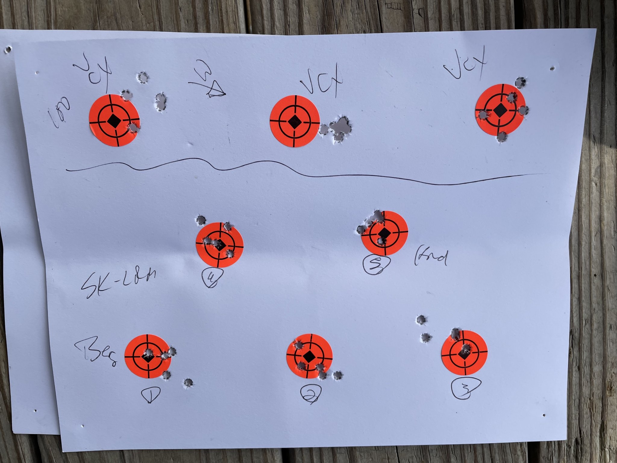

If my memory serves me correctly, I shot 3 boxes out of the Vudoo immediately after shooting a couple of boxes of center X. I unfortunately did not save the target with the Midas Plus, but the center X showed really good results. I was watching the velocities on the Midas plus swing upwards of 70fps shot to shot, while the Center X was 10-15.
For reference, the top 3 groups on this target was my Vudoo. 100 yards using Center X. The Midas plus groups were easily twice the size of the worst CX group.
Left to right wind at about 10 o’clock, 5mph. The bottom was my B14. It was clean when I started, and I jumped to 100 after confirming my 50 yard zero - hence why the groups tightened up a lot. I did dial for the wind on the B14. Both guns have Athlon Cronus scopes.
I chose to only run one box through my other two rifles, only looking at the last 3-4 5 round groups. I’ll run the CZ with it on Friday and see if it improves.
