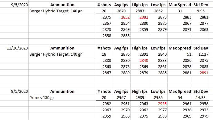

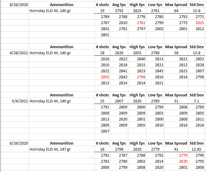

    These are LabRadar data in 24" Proof SS with ELD-M...excuse the 147 gr....got a little carried away with Snipping Tool! haha
    Now this is what I have from Berger and Prime....not a lot different.

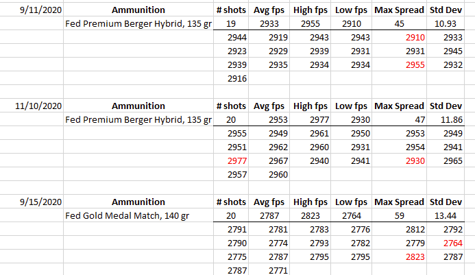

    And Federal with Berger 135 Hybrid Hunter and FGGM
    I don't have any factory ammo chrono'd that meets what you are looking for or what @GBMaryland got but his data includes only 10 data points so I wonder how that set would look if he had a much larger set. All 72 shots of the Hornaday 140 gr came out to average of 2807 fps, ES on them all of 94 due to one very slow outlier and if I toss that one out there is another just 10 fps faster but both are outliers in a 72 shot data set (and wtf knows why these two/three are so slow), and an SD of 17.
    I to believe that Hndy QA has gone a bit slack as they are totally in the weeds. I'm finding the occasional brand new cartridge that is very hard to close the bolt on due to excessive width near the base.

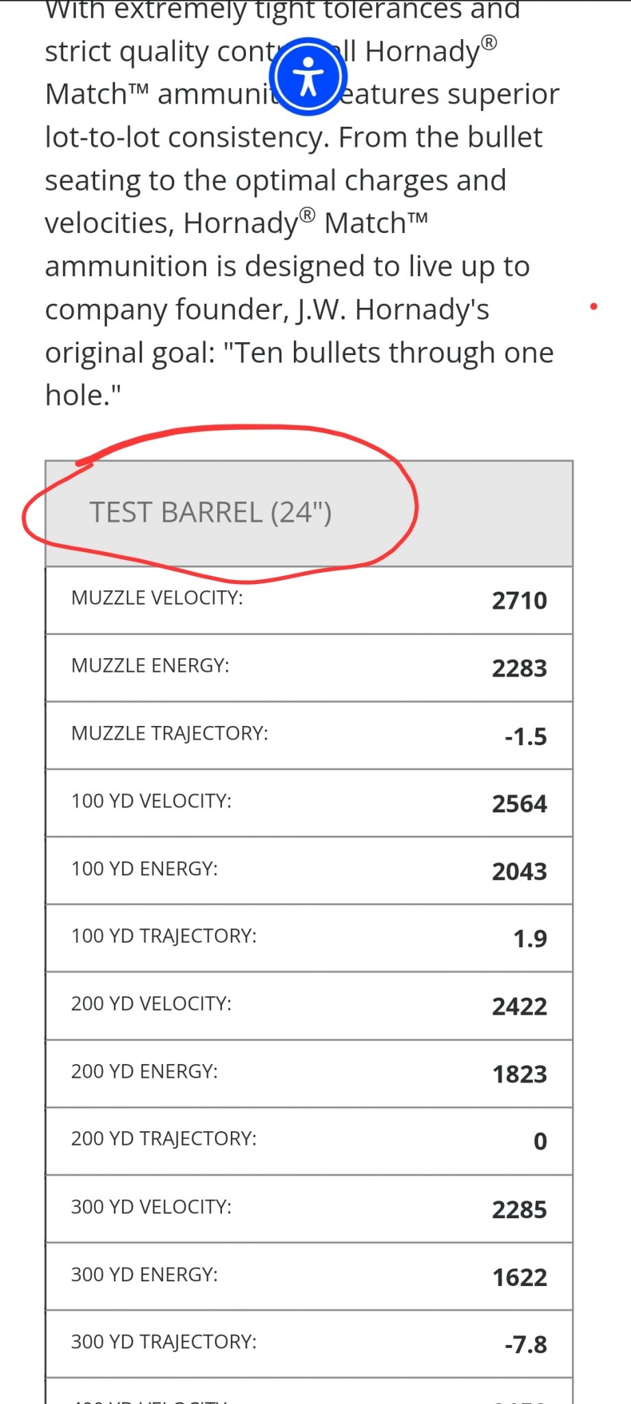

    Not sure how the OP confirmed a 24" test barrel from Hornady but maybe they tested out of a 26" to get the advertised 2710 FPS? Its the only thing I could think of to compensate for the low velocity.
