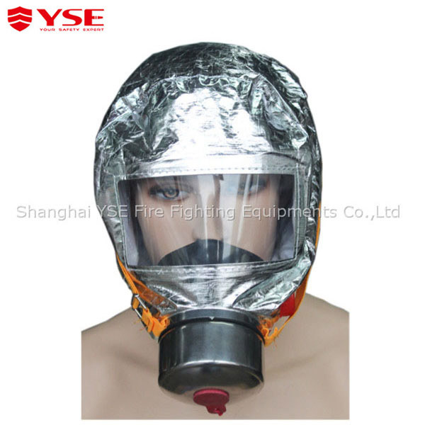

This is what I would buy if your that set on buying one .
Now with that said I think these guys are trying to get you to understand it's not going to be as usefull as some people think ,
First off , are you always clean shaven ? not much use if you needed to dawn it in the next five minutes and you have facial hair.
Second , if you do dawn it , what's your plan. it should be used just long enough to get the hell out of whatever situation your in.
If you plan to dawn it and shelter then your already fucked and your prolonging the innevidable.
And then there's the whole decontamination thing that was stated previously. nothing wrong with you being prepared, it's just gonna take a lot more than a mask !
