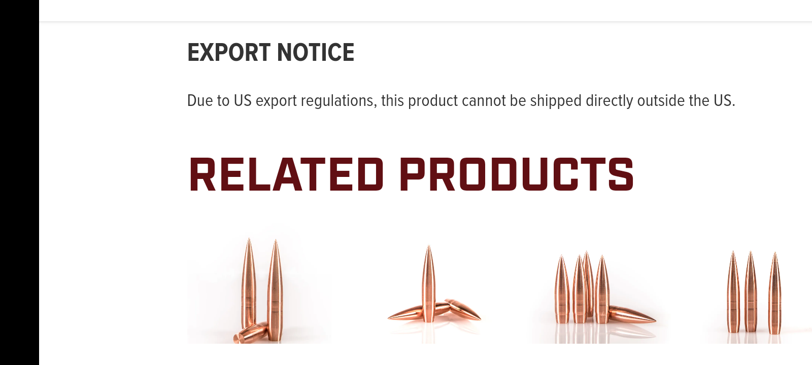

ITAR laws may make this conversation entirely academic. There's a decent chance that no American manufacturer can export their bullets.
Mike
I know manufacturers can export... But the OP can't order directly from you, correct?
Mike
Mike
They can order direct,but an ex and imp license is required at both ends. Open ended qty's to importers that cover more than a years amount
Actually shipped on one license makes the most sense. Cost for license is the same per year regardless of quantity.
Reactions: OkieMike
We have been exporting our bullets for several years now. And as Alan stated, export licensing is required on our end and import permits are usually required on the other depending upon regulations of the country of import. Small quantities, while doable, become expensive due to the costs witch are the same as they are for larger quantities. There are other companies, such as Reloading International, that will assist with the export of small quantities, but the costs are certainly still higher. If there is significant interest in an area where we have no direct importers already, we are happy to help set that up.
