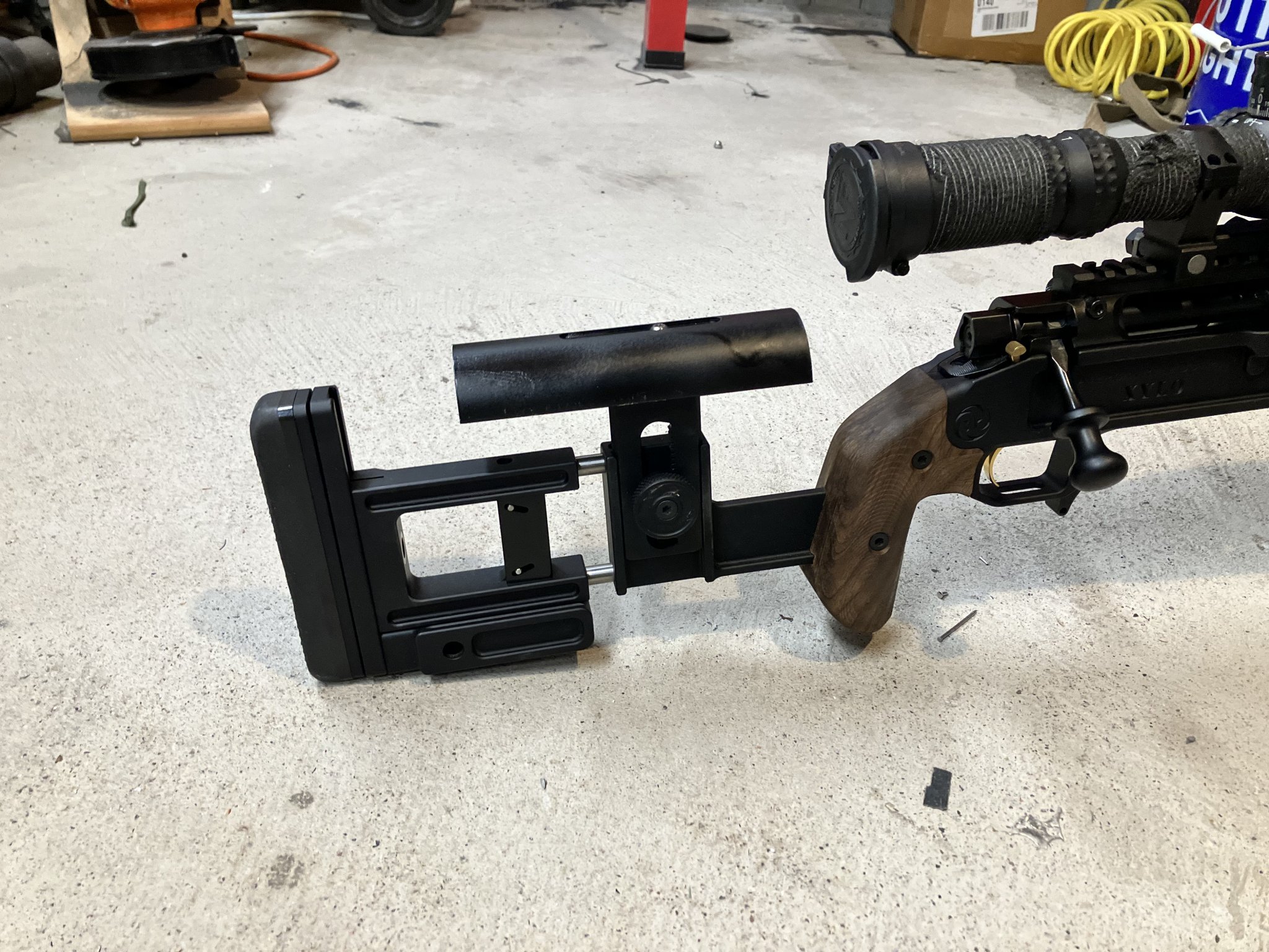

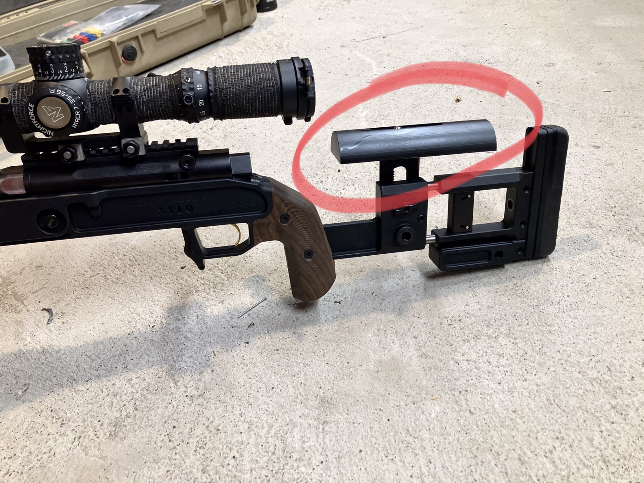

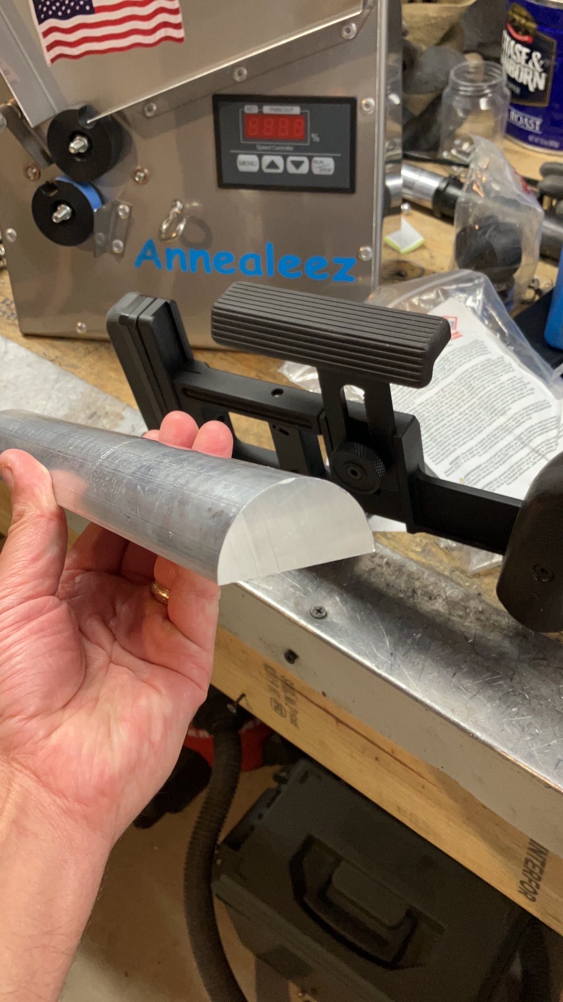

I’ll begin by saying I love my ARC xylos. Love em to death. The biggest drawback for me, however, was the cheek piece. While I do love the design simplicity and adjustability, the flat metal with only a thin rubber cover wasn’t my favorite feature, so I attempted to improve on this myself.
I started by buying 2 inch diameter half round aluminum barstock from an online metal supply store and milling channels to facilitate the attachment screws and seating on the cheek riser.
I’ve attached a picture of the end result. I think it feels night-and-day better than the original and isn’t horrible to look at either. Another great benefit is that it is ambidextrous. I let my daughter shoot my 22 trainer, I’m a lefty, she’s a righty, so every time I switch it back I have to change the cheekpiece over. This is probably not a common complaint, but I still think being ambi is a nice bonus. Im also in the process of designing a cheek pad that can be attached with Velcro straps, and in the meantime I am looking for a place that can anodized the aluminum for me (I just rattle canned it black to see what it would look like).

I don’t like the Xylo cheek piece because you can’t remove the bolt without moving it down. Some other chassis have a clearance cut for this.
Are you still able to fit a rod guide/cleaning rod without removing your cheek piece? It looks like it may be taller than the stock design.
The Xylo has one of the easiest to adjust cheek pieces. Use a paint pen to mark where is was then lower it as needed.
Reactions: Halfnutz
I haven’t tried to clean it yet with the cheek piece on, but I am able to remove the bolt. Action is an archimedes.
Ill give it a look tonight. There’s still a lot of room to make clearance cuts that could allow the cheek piece to be lowered for cleaning if it isn’t low enough already.
Looks like the clearance is just enough to get a rod through, but the rod will be flexed the whole time. I think I’m going to mill it out a little more the facilitate clearance that is more in line with the original. Otherwise, I’m pretty happy with it. I’ll try to update this later when I get it anodized and have a cheek pad made.

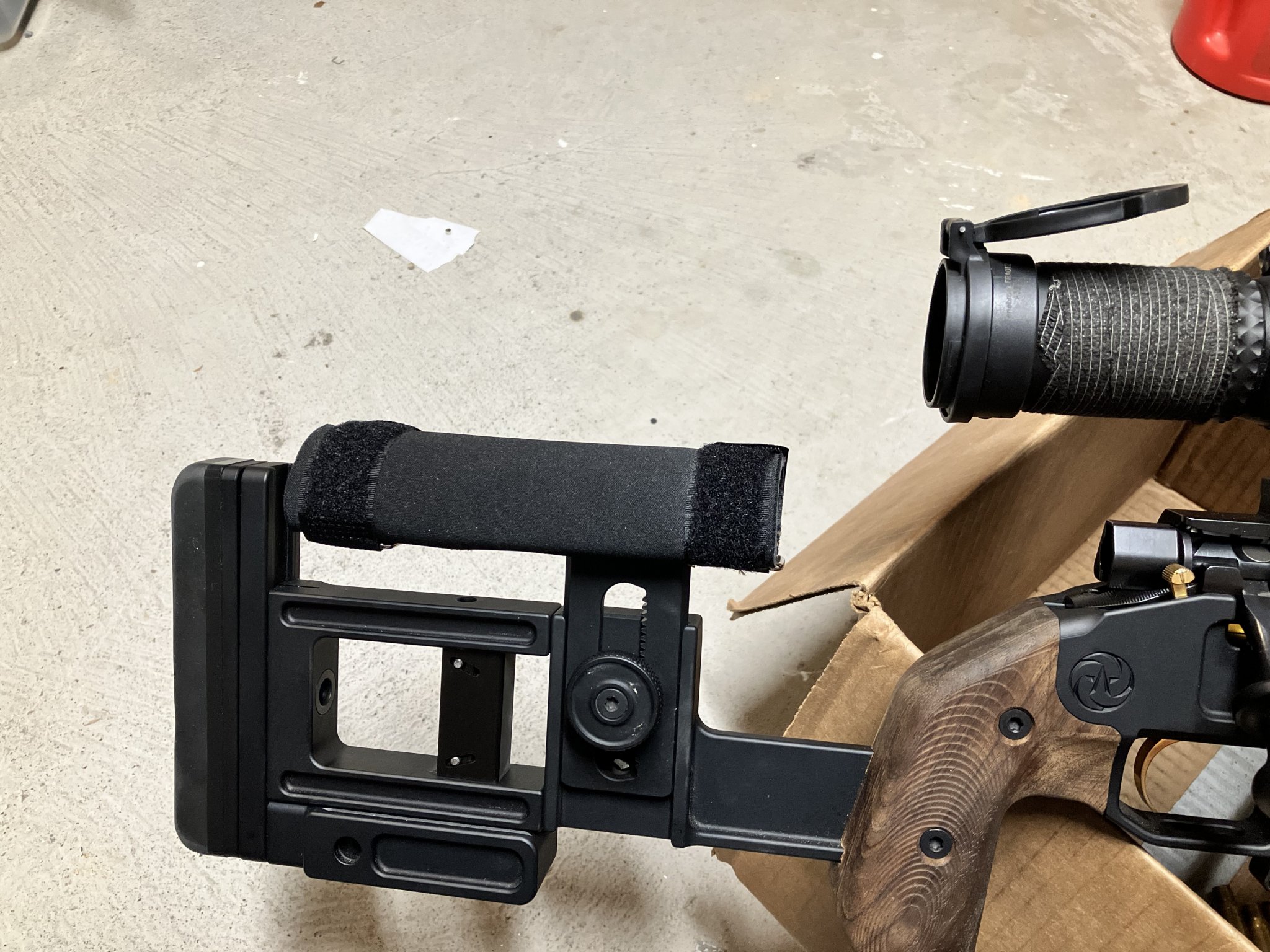

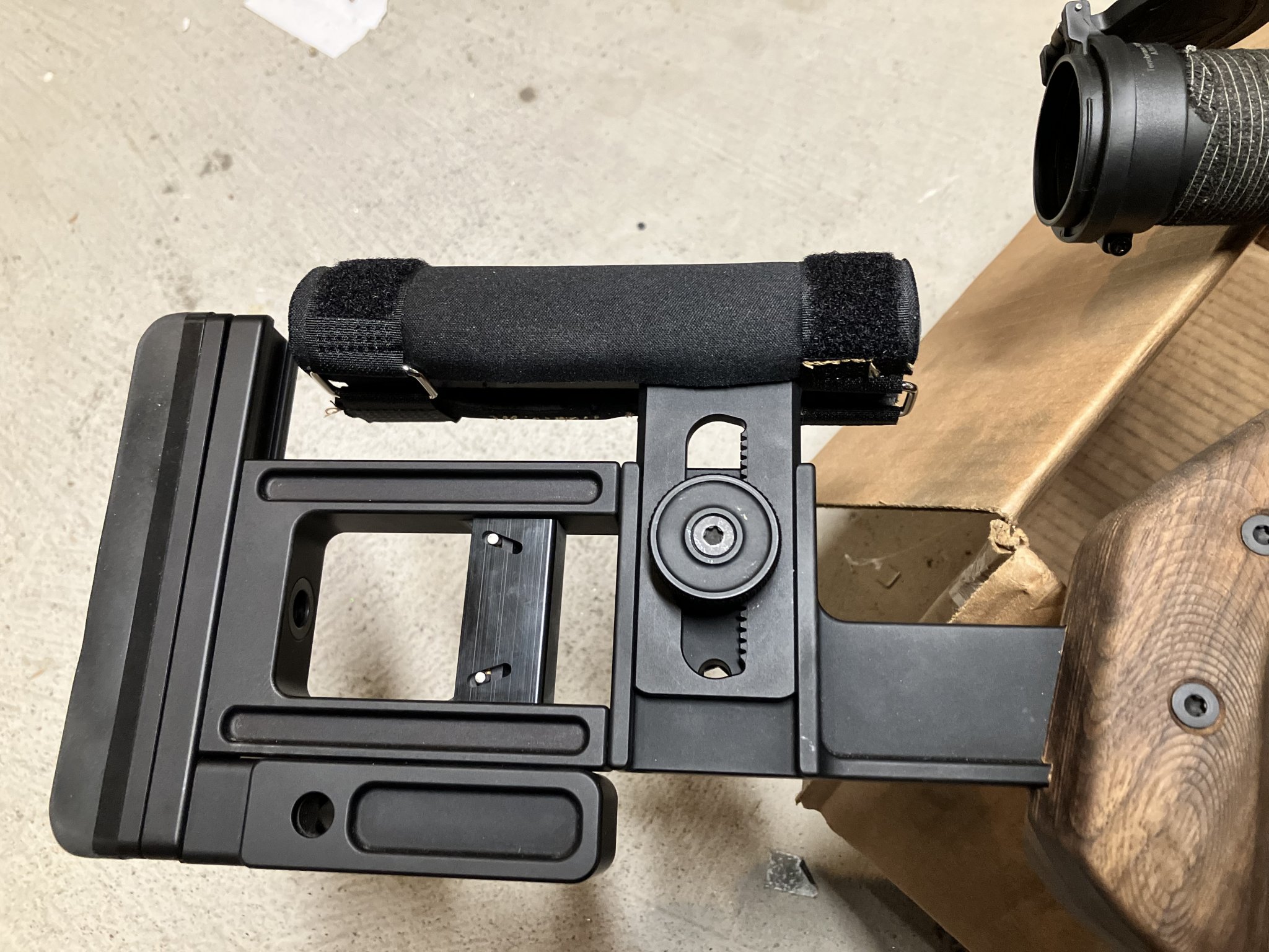

Neoprene cover. Secured by Velcro on the bottom flat portion and 2 Velcro straps at the ends. I’m gonna say it’s good enough. The feel is much better to me than the original, but I’ll have to send some rounds before I can know for sure.
