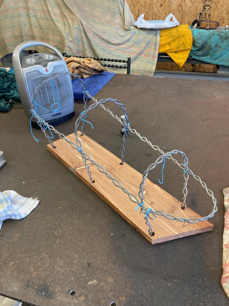

I've only done the Brownells Aluma-Hyde II coatings. This will hold 165°F as long as you need to. I usually let it set overnight. Hang the part(s) on the wires, cover with a towel or whatever your comfortable using and adjust the distance from the mouth to the heater as well as the size of the exit opening to control temps.
Like post #6 but horizontal.
