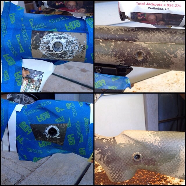

Well I just did my install. the rear cup at the but stock was a piece of cake. The one on the for arm got fucked up. I used a hand drill and 3/4 of the way down I hit aluminum and the drill walked causing the hole to widen out a lot. I bono the shit out of it with JB weld and let dry. Should be good after it's done curing. A little fine sanding and some touch up paint and should be good......I hope! :)

Great info on how to DIY! Here is my crack at it. Opted to do the rear cup close to palm swell cause of more material in area. Sits comfortable with Tab Gear Biathlon sling. ImageUploadedByTapatalk1407664230.776631.jpg
Thanks for sharing this. I put 4 of them in my B&C after seeing your thread and they turned out great. Thumbs up to whoever mentioned the forstner drill bit. It cuts a perfect 1/2 hole with a flat bottom
