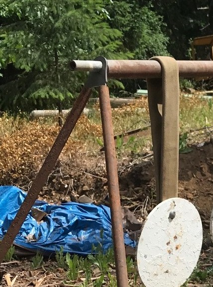

Here is shot of the bracket with two legs that go on the ID of the pipe and the center hole for the main pipe. The pipe was pretty crusty so I had to pound it in.
The piece of the larger diameter pipe runs the length of the target. I had it so I used it but it is unnecessary, figured it would protect the main pipe. The 3rd rack I made did not have this piece at first and I added it later, seems to help keep the targets from moving side to side towards each other.

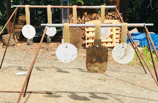

This is the longer one and I placed it on a steep hillside about 600 yards out, its a blast to shoot. Placing it on the angle had the back legs buried about 2 1/2 feet deep, front legs about 6". These stands do not move. I did a little tractor work and moved it and set it back up in about 15 minutes.

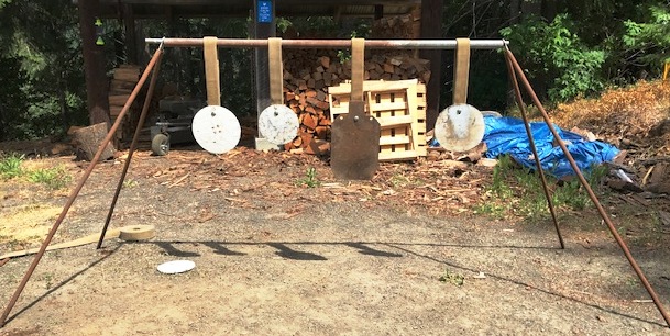

This is the slightly smaller one I set up at 440 yards, I added a 6" plate to this one later.
All targets are attached with a 1/2-13 carriage bolt and two nuts with a large washer against the hose to keep them in place. At some point you will lose a carriage bolt but they are easily replaced.

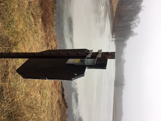

Electric Fence Light company makes t-post brackets for different applications. I ordered the 8 pack for less than 40 bucks, drilled some ½ holes in them to hang some 2/3 IPC 5/8” AR500 steel targets. Could probably have gotten by with just one but two are very stout.

I’ll try that and see how we get along with just 1 bracket. Thanks for the tip.
