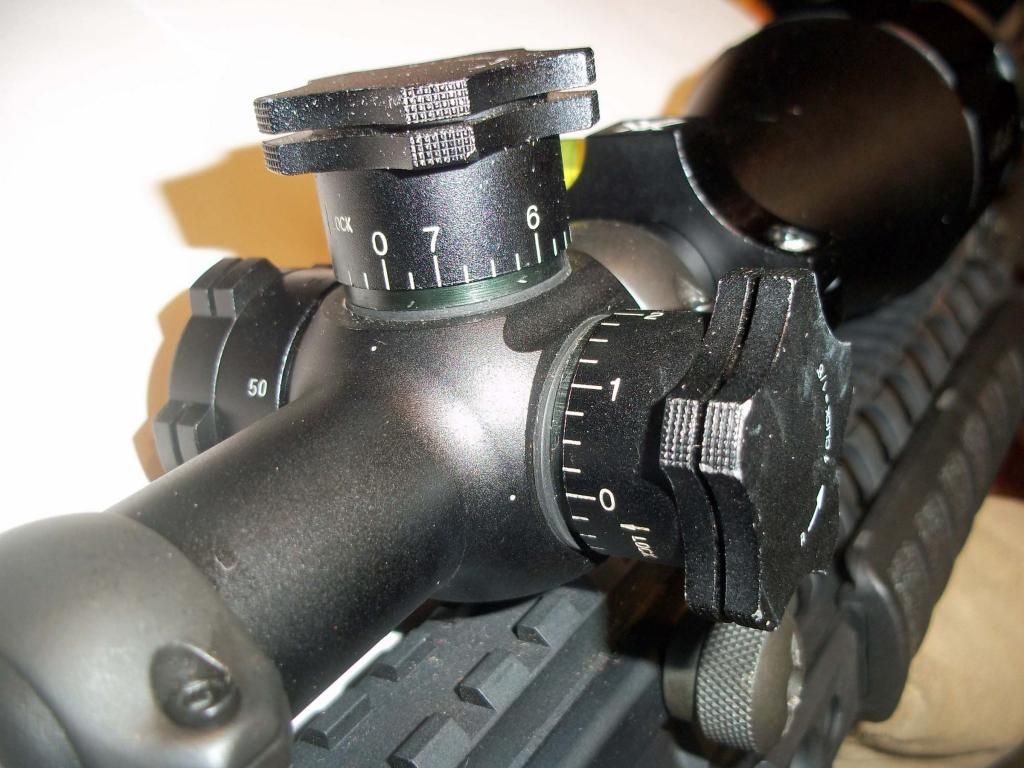

Here are some photos as requested.
First, the turret after zeroing the scope on target for this particular rifle/load. Note the index mark is aligned to the 3.5 MOA marks on the cap. You can see the tiny set screw used to ride within the locking groove, and keep the cap from being pulled entirely off when you unlock the cap. Setting aside DFOOSKING's suggestion for a moment, if I leave 3.5 as my zero; and have to turn another 8.75 as calculated for a shot (there are 7.5 per revolution) it can get messy.
Next, is the turret with cap removed. The u-shaped groove captures the tip of the set screw, allowing a small vertical travel. The teeth in the cap engage the ones on the turret in the up position, and are disengaged in the down position.
Detail of inside of cap. Set screw visible. My thought is to drill a new hole and install a new set screw with the turret markings at the zero position vs. the index point. Obvious disadvantage is that it is only relevant for that one load, rifle and mounting combination. If the mount shifts, or I change loads at all; the index is lost. The other alternative is to simply install the caps at the right position; without using a set screw. but if they get bumped wrong, the caps come right off.
This is what I want to see. Starting position indicating zero MOA with rifle zero'd to POI.
For rprecision - from your comment about being a machinist, I'd bet your not the type of guy to just throw something out because it is not top of the line; AND that you enjoy tinkering with things. That is part of the fun of hobbies right? - making things work better. You're right the BSA isn't a great scope; but it came to me with a rifle purchase and when I tried it out, it is pretty clear and it worked ok so far. Not ditching it till it gets a fair try. Then if it sux, there always EE on ARFCOM. I have to think that it would sell in seconds on ARFCOM since it has both "stealth" and "tactical" in the model name.
I DID have to take the stupid looking jumbo paralax wheel off the side so I could stop giggling long enough to get a good sight picture. Made the scope look like some kind of crippled river boat...

In addition to your set screw replacement I would drill another hole at the same height/location in the other cap finger indentions (or 2) and tap and thread them for additional set screws..........problem solved. In fact, I cannot see why you won't be able to keep the locking turret function with this fix?

So, as pictured I assume that you can return the turet to 0 however the set screw wont line up with the factory recess. Becuse the turet is splined the concern I would have is tightening down the set screw buggering up tye splines making it a one time deal.
What I would do is measure the brass turret and figure out how far down to that smothe ring machined below the splines. Being careful to measure clearances mark a new hole below the old one, drill and tap. Make sure the set screw doesn't hit the bottom of the splines. They make special set screw that have a plastic tip or a flush end. That shouldn't cost more then $20. Next time choose tasco, although they are cheap crappy glass they generally work, mostly.
Problem is this may limit travel.
The other idea to to replace the set screw with a plastic tiped version ane try it. Although this is likely to require drilling it out and retaping to a larger size.
Re: DIY scope zero reset?
If it were in my hands I might opt to bore out the turret cap to remove the splines then add another set screw so it can be put where ever you want it.
