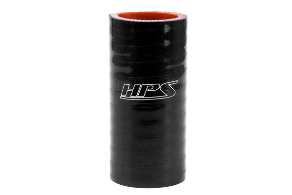

Looking to make a suppressor cover. I have a griptastic from bowers group and i like it a lot; unfortunately they dont offer it in the size i need. Long/short, anyone use HPS Performance Parts for a suppressor cover? Its high temp silicone for coolant lines. I am specifically looking at the one in the link below. Rated up to 500 degrees F. Thoughts?
Had not seen this. Looking for a cover to easily take on and off. Gonna try this sleeve. Trim it. And then dremel “breather holes” to assist in heat dissipation.

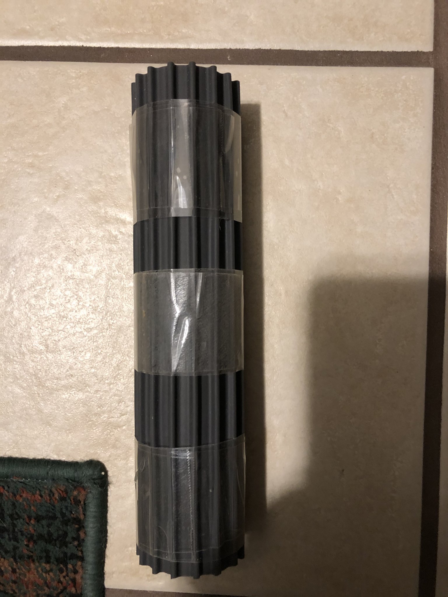

Silicone dish drying mats work great, cheap, easy on/off. Was able to get 2 from one mat.
Lots of different styles of silicone mats out there, this happened to be on sale for around $8.
Did you secure with tape? Paracord? Have you looked into bonding the ends together? I was googling how to secure it and bonding the ends seems like a viable option.
Just cut to size and taped on, no bonding needed. That just packing tape holding it on, it works for my needs currently. Might get some fancy camo duct tape so I can be "Tacticooler", :ROFLMAO:
In the top pic at about 4 O'clock position, you can see the seam/edge slightly overlap.
This is Mousco brand dishmat, good to 480 degrees it says. I believe it's good beyond that...........Pretty sure all silicone stuff is good to 500 degrees.

Yes sir, been running it for a good year now. Have had it quite warm. It will start to slip if it’s not secured well, but by then you probably should stop shooting on a Titanium can anyway.
Has not melted yet!
Lots of ways to minimize mirage, this one works for me and cost was very low.
Hope this helps!
Reactions: Spicerack
Has not melted yet!
Hope this helps!

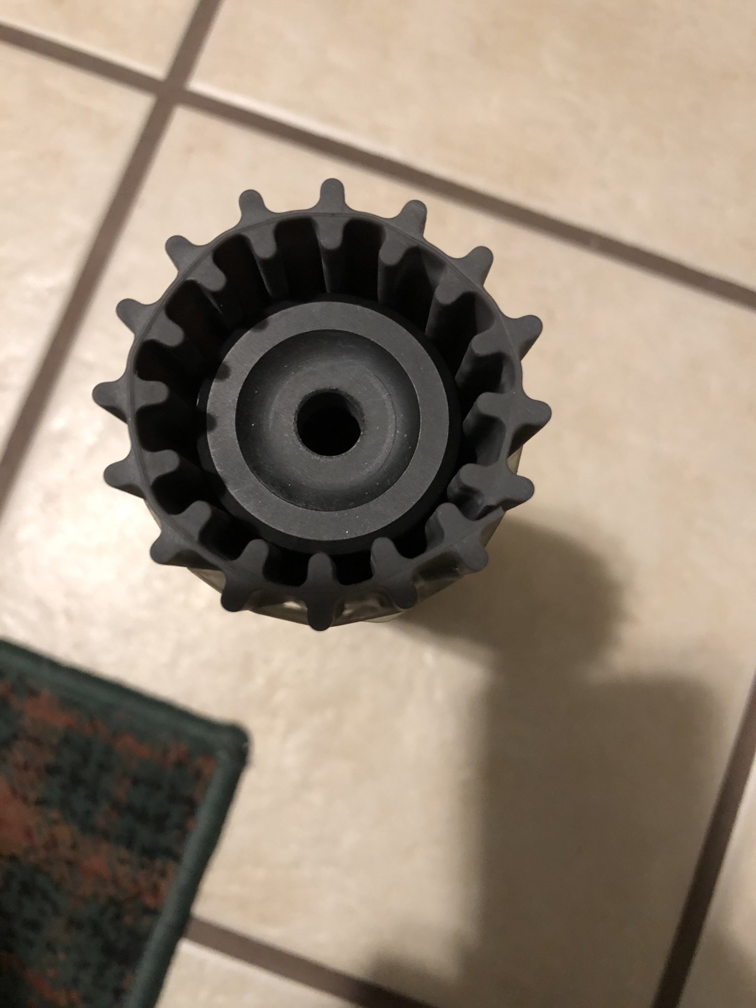

Here is one like Smoooth1's but with the ridges only on one side. I like the idea of the ridges next to the can and not on the outside to help remove heat and keep the diameter increase down to 1/2" as well. Im securing it with The bandage tape also linked below. I think this will work great on the UZI Micro with an MK9K. Not so much for mirage with the ribs, but it will keep the skin on my hand.
Hope this helps!!

for what its worth, the silicone tube i mentioned in my first post did not work AT ALL! Total failure. Dish drying mats work much much MUCH better.

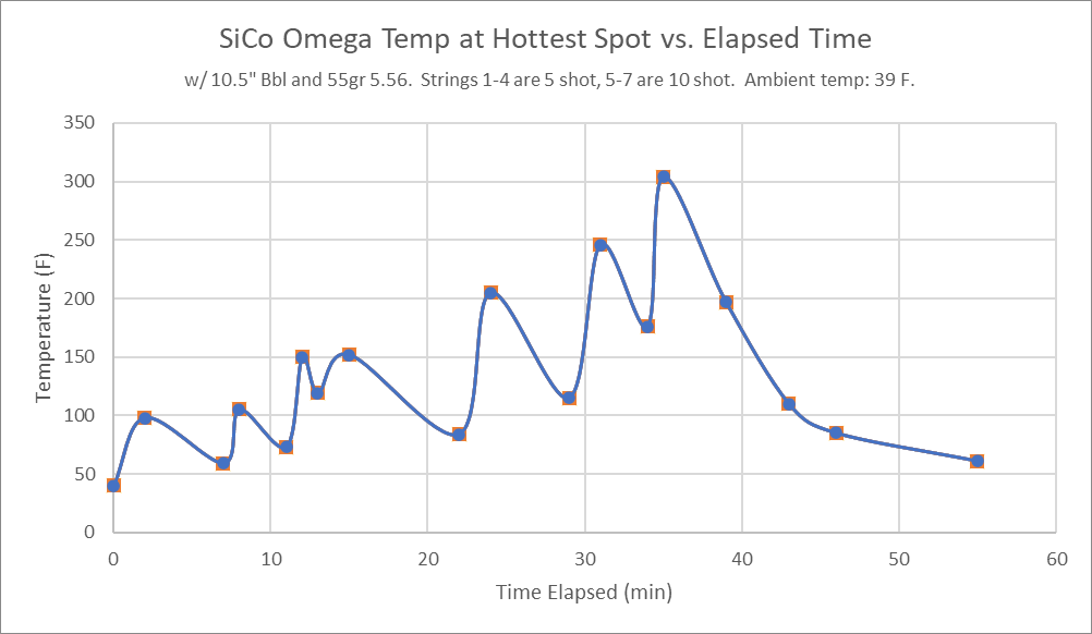

Good afternoon,

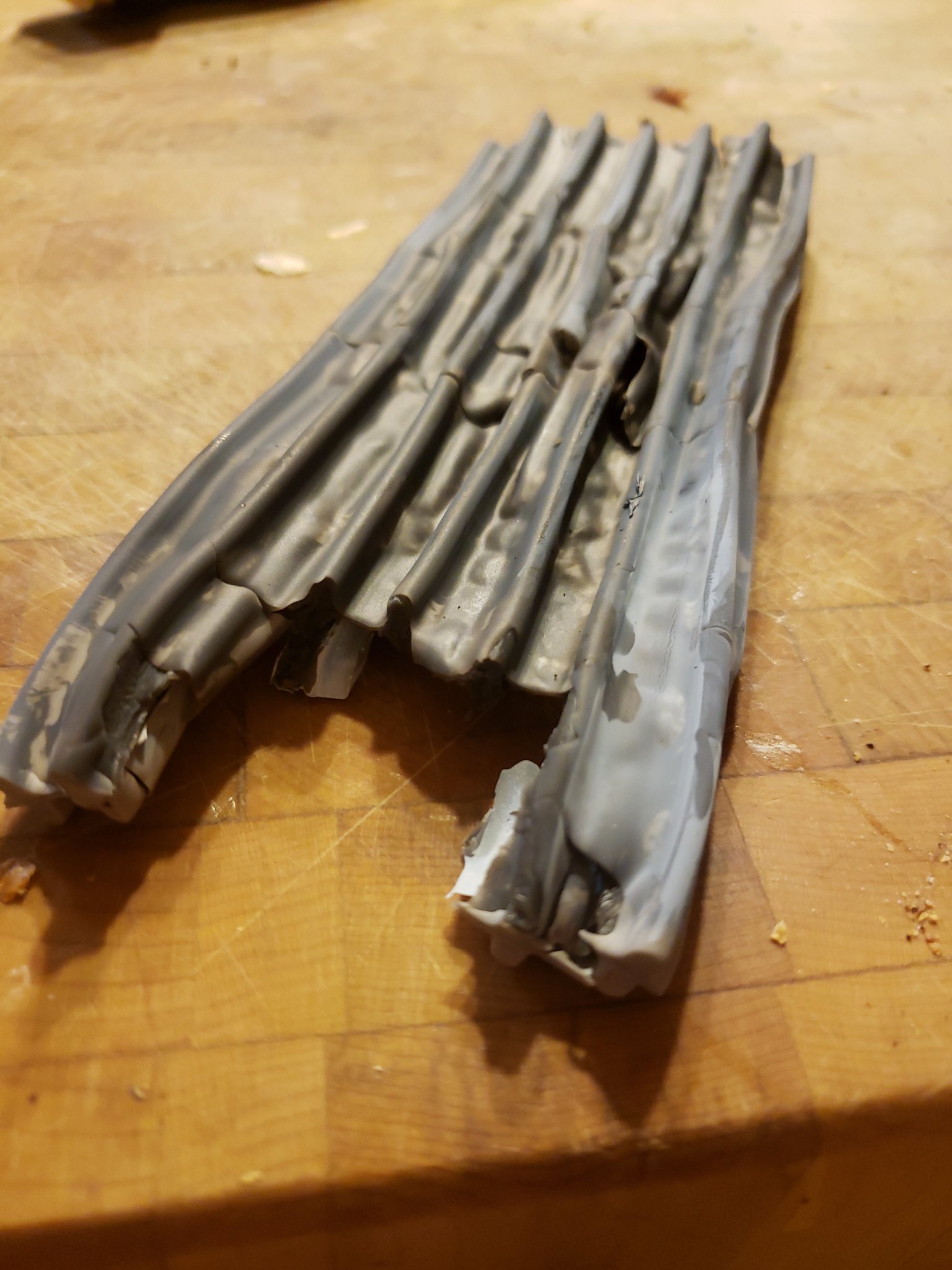

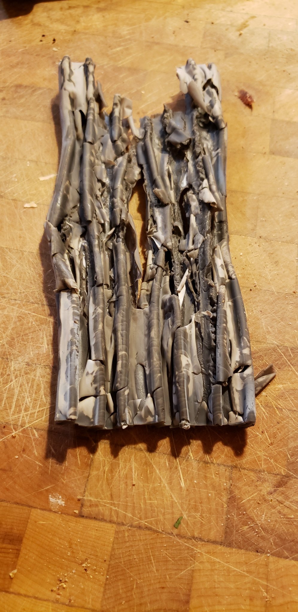

Did this little experiment on a bare can before strapping on the mat. But since the experiment, never really got anything hot enough to really approximate this same interval with the mat on. I also put a piece of the mat in the natural gas grill on an old sheet pan to see what happens as the heat increases. The mat got crispy and crumbly at around 600*F if i remember correctly. Point of the grill exercise that i took away was that it gets crumbly rather than melty, so that alleviates some concern with gooping up the can's finish if the mat does fail.

where did you buy that silicone drying mat? How hot does asuppressor normally get (not mag dumps) from one shot of 5.56 every 10 seconds. What results have you got with this mat?
I bought it from eBay a few years ago and am still using the same one. Have never had an issue, but haven’t shot a 30rd (or more) mag thru it quickly either.
Have had my 300WM can plenty hot (many times) and the mat still looks like new. In fact, I upgraded from packing tape to vet wrap to hold it in place. The vet wrap is working very well and is much more cosmetically appealing, attracts hotter women, shoots better, and best of all, makes me feel less poor😎Confidence is everything and confidence in your equipment equals success 🤩😁
Seriously, It’s an easy and inexpensive fix to a very simple problem. All of the big name, big money suppressor covers (that I’m aware of) are just fancy insulating blankets with no way for air to circulate to help cool your can. Prove me wrong, please.
If it doesn’t work out for your shooting style, at least you are only out a few dollars and a few minutes of your life.
Best of luck!
