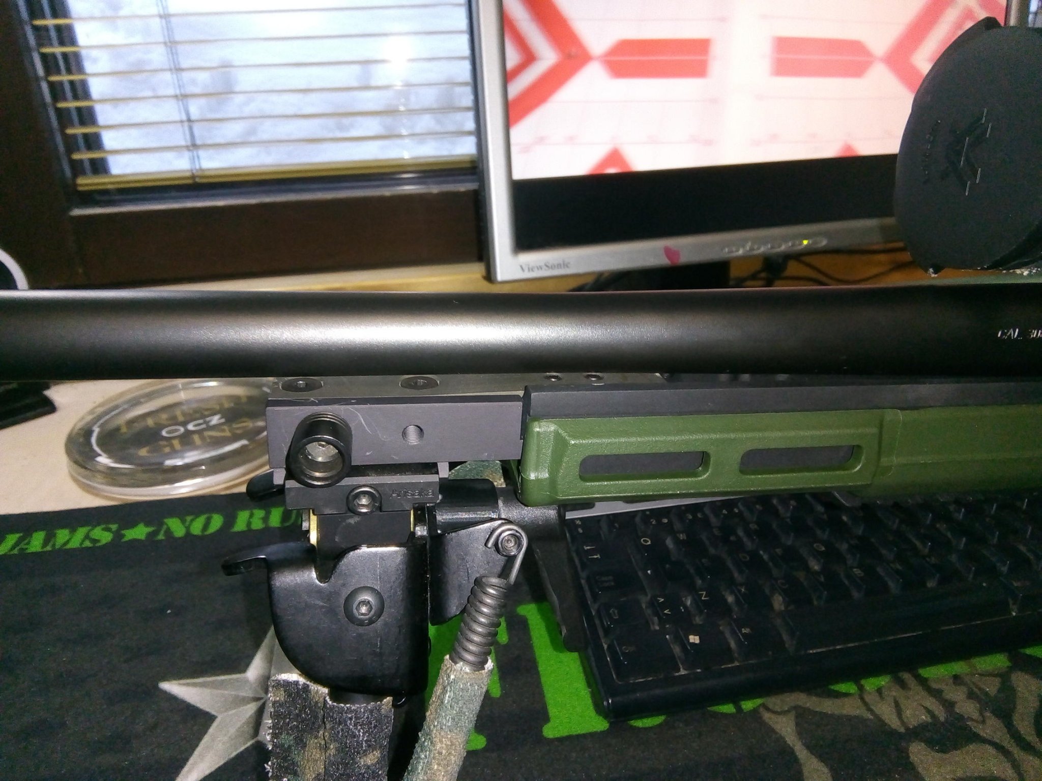

Cheap, maybe not that good as the real deal, but it hold the bipod very well.
You need to drill one hole to the backbone of the KRG chassis, and make little mod to the Atlas TRG bipod adapter.

That's petty cool, surprised not more love, considering anytime a KRG with spigot is for sale her it takes about 5 instead for someone to ask to buy spigot by itself.
Did you already have the Atlas TRG piece handy?
Yes, i got that Atlas TRG spigot mount before i got the chassis :)
I knew that it will go inside the TRG chassis, and if TRG bipod goes on to KRG chassis, is must fit on the hole.
Only one hole i needed to drill on the backbone, and open up a little bit that Atlas spigot mount, so that i could fit the chassis bolt on the nose section to the backbone.
