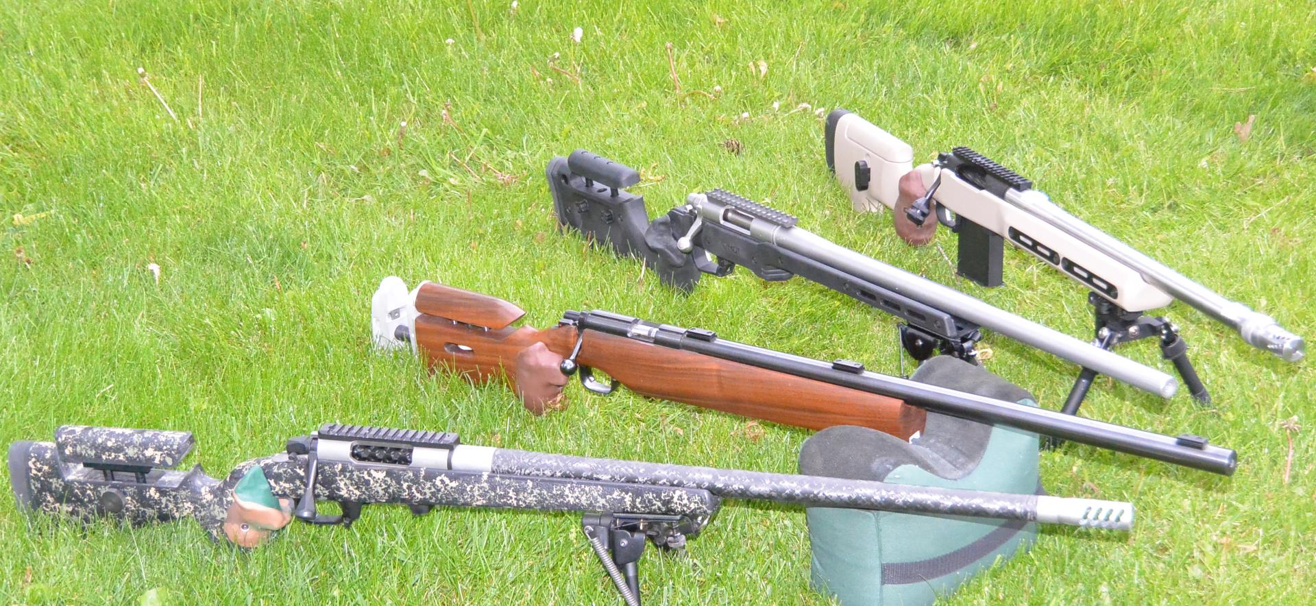

Has anyone done anything like this before? Does anyone make a conversion piece similar? I have a B&C stock that’s bedded I just don’t like the grip angle too much.
